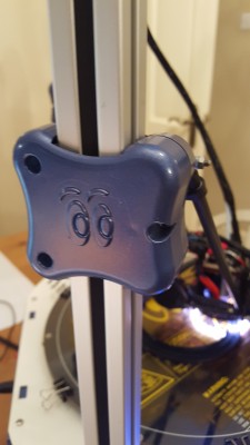

geneb wrote:I've seen zero instances of them "having issues", so I'd love to see where you saw folks talking about them.
Can you take a pic of one from the back? I'd like to see how you have them installed.
tnx!

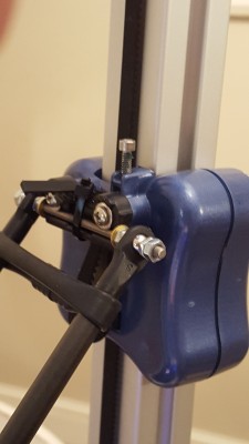

Here is a picture from the back:

Well I am not having issues with the carriages.... but they do creak and groan under rapid movement. It appears to be where the plastic case twists slightly. Pretty sure I have them assembled correctly.
The case screws are as tight as you dare turn them. The issue I read (can't remember where.... during my pre-purchase days)... was someone stripping out the lid screws.
I did change my home stop screws for slightly longer ones than supplied... purely because I found them easier to adjust.
Re: Steves new build project. Sept 2015
Unfortunately, since they're painted I can't see how the pivot arm is mounted inside the carriage.
Stripping the screw holes is entirely user-error and it's pretty difficult to do.
The carriages shouldn't be experiencing enough force to twist them at all.

They perform well..... just creaky! Certainly easier to put together than the old style by the looks of things.
I am 100% sure they are assembled correctly.
Yea... didn't like the clear plastic look (especially as one was a different finish), so I painted them.

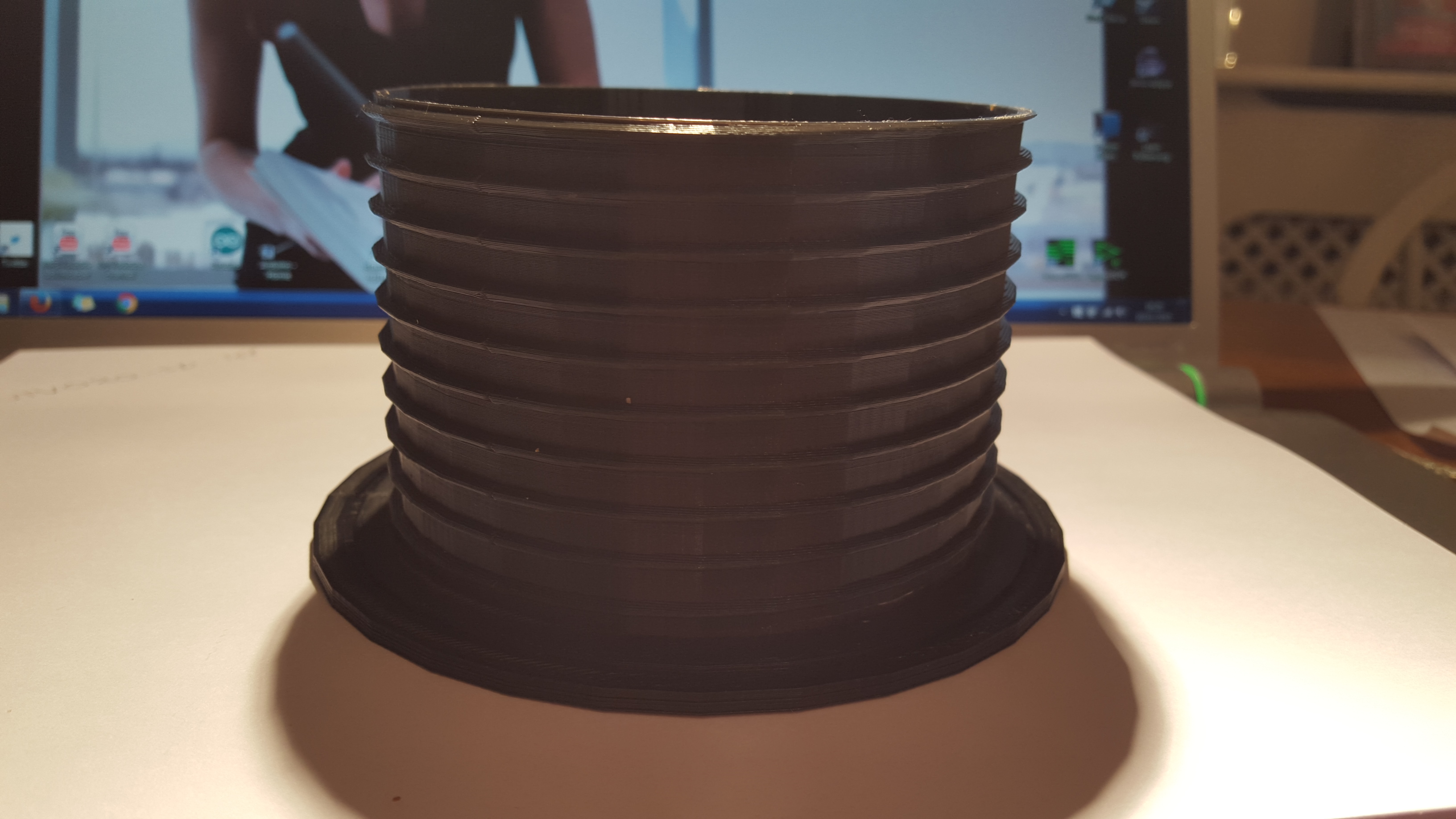

OK. Pretty nice quality print with the PLA last night. Its not perfectly round, but that is the Tinkercad software - not the printer (its basically lots of short straight edges).
However.... uber weak. The layers are just not stuck together at all well. It basically fell to bits getting it off the bed.
Possibly cooled too much as its printing? Going to try a smaller part and wind the cooling level back. Printing at 0.2mm and don't really want to change that... not now that it is finally giving a nice finish

I'd bump up your extrusion temperature by 5 degrees and see how that goes. If you print too cold, the layers won't bond very well.

Just trying a lower cooling fan level, and increased the nozzle temp by 5 deg. See how that goes.

Stevolution wrote:OK. Pretty nice quality print with the PLA last night. Its not perfectly round, but that is the Tinkercad software - not the printer (its basically lots of short straight edges).
Delamination is a common issue especially with think walled relatively tall items (e.g. Cylinders). IME PLA is prone to delamination as the layers don't stick together too well and ABS cracking due to shrinkage when cooling on thin walled cylinders.. same overall result delamination between the layers. I generally just use ABS almost exclusively now as it gives a much better finish, stronger, better bridging and overhand tolerance, no stringing, cleaner part and Acetone vapour when needed. Negatives are it's harder to get to stick, it shrinks more and the fumes are not nice. I have found that tool path and slicer settings are the real key once you get your temps sorted wrt layer adherence. Personally I find Cura better at thin walled items but Slic3r better at everything else (more experience so perhaps I just don't use cura enough).. I now pick my slicer based on the specific part these days (i.e if I can't get it to print well with Slicer I use Cura).

Yes. I have found ABS far nicer to work with (which is not what I was expecting from my pre-purchase reading).
UHU on Kapton tape... sticks pretty damn well. Not sure I am going to bother with another sheet of PEI (at least not yet).
Printed a nice PLA 100mm hex nut for my 100mm threaded pipe last night. The finish is nice.
