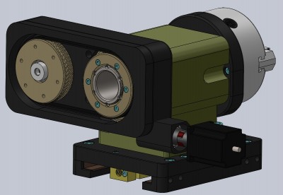

And here is my test of a harmonic gear. Since I can't get the surface finish good enough for an elliptical shaped plug and ball race, I have to use bearings as rollers on the ID of the flex spline. The flex spline is actually a small assembly with 4 bearings in it to keep stuff stable. I'll work on a self contained unit capable of a lot of torque and zero backlash.
The hypocyloid gear type you suggest I make looks like it works the same in fit and function as a strain wave gear, but cheaper to machine on a mill or live tooled cnc lathe. A reduction ratio of 30 or more with zero backlash, high maximum torque, good efficiency, and no backdrive-ability is what I need on this machine. Plus it has to be compact and not too expensive.
So for rotary axes my choices are down to;
Dual Worm
Roller Strain Wave
Hypocyloid
Right now on the C axis (the one that the workpiece spins around) I just have a clutchable spur gear and I'm still getting low backlash and up to 3 rotations of the C axis per second, which is good enough for light threading operations. If I switch away from the spur gear system I'll lose the ability to thread at a reasonable speed but I'll gain the ability to take heavy milling cuts far from center. I need to get a sensored BLDC motor and put an encoder on it so I can thread with it, then use the low speed gear system for milling.

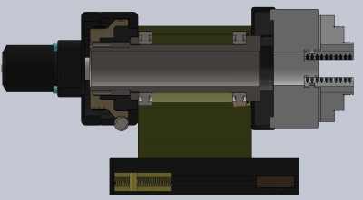

2) The C axis (main workholding spindle) has a clutching mechanism that switches between the BLDC outrunner for regular turning/drilling operations, and a 4:1 geared down stepper for tapping and threading and indexing for milling and stuff. It's great for small parts, but anything over 1" (25mm) is at risk of backdriving the stepper during heavy cuts. I have a completely different design for V2 of the machine that will be improved in every way.
3) The "tailstock" is identical to the main headstock, just on the other side of the machine. To synchronize the headstock and tailstock, you just command them to move the same amount in the same direction with gcode. I haven't been able to use this yet because I'm deprived of free time and my board doesn't allow me to use more than 8 steppers right now; once I upgrade to a board that allows more steppers, I'll be able to put the fully functional tailstock to use.

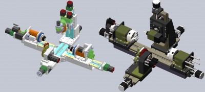

I started out with the concept for this thing in Fall 2015, was building it by February 2016, and I had the first prototype working and making 5 axis parts by July 2016.
Now it's August 2017. I started building a version 2 prototype (V2) at the beginning of July 2017, based off of the design I had mostly completed by spring of this year. Now I'm approximately 50% of the way done with the version 2 prototype.
That's the back story. I also withheld some......strategic........information, specifically that I have been planning on doing a crowdfunding campaign since the very beginning. And also that this machine has additive capabilities. It killed me to have to withhold this from you guys, especially since I have had a video of it working with a hybrid additive/subtractive part since mid 2016. It's one of the reasons why none of my photos on this forum show the entire machine, even though it's right next to the camera!
V2 is similar in function and form to V1, but improved in every way. It's much larger and heavier. While V1 can cut plastics and metals with small tools (under 3/8"), it lacks rigidity and power. Plus I had to make it on a minimal budget, which forced me to go as cheap as possible on the machine and make design compromises. As a result it is difficult to align to the tolerances I want. V2 avoids this alignment entirely, and is significantly more rigid and powerful. I've attached a few photos, I'll be resuming this build log.

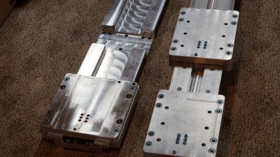

Yup, the plastic slider boxways are great. If I were going to build a machine with very long travels, I would consider rolling elements for efficiency. But boxways are a lot more rigid, and are pretty much immune to contamination. Since most parts can be done with only a few inches of X and Z travel, it makes sense to stick with boxways.

The turning spindles will definitely have an indexing mechanism, I have both a harmonic drive and a worm drive tested and working right now. All motors (except steppers) will have a 2048 count pulse encoder, which will allow closed loop control and

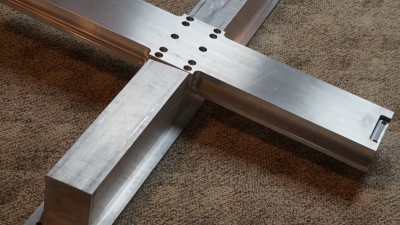

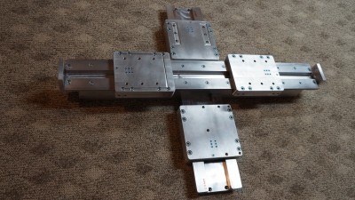

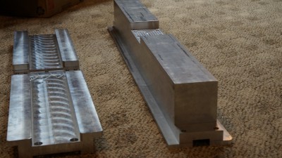

Some close ups of the boxway system;
Note that the boxway locks are not tightened in the second photo, which is why they are at a slight angle.

The boxway slides are 8x10 and 10x10, which is similar to knee mills and medium sized manual lathes.

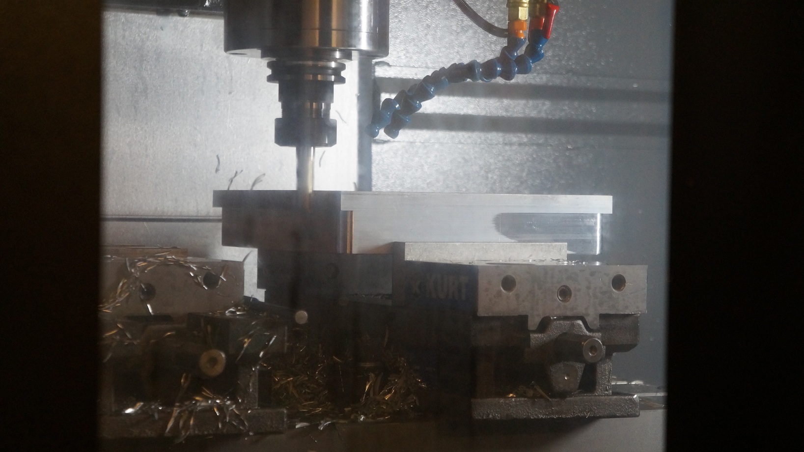

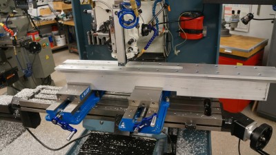

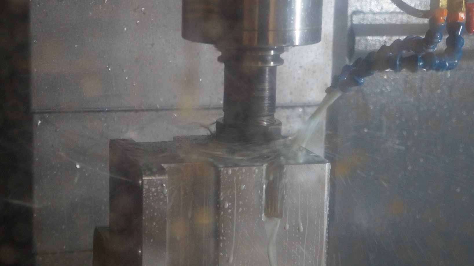

I made progress on the main headstock block today. I still have to rough out the center hole, line bore it, and make 100mm bearing pockets on both sides of the block. The block is 6x6x7", and I'm trying to keep the bearing pockets round, square, concentric within a few ten-thousandths of an inch over the six inch distance. I'll show the method as soon as I get it done. Japanese NSK bearings are on the way.
Here are some pictures I took while machining the block today;

Double post because nobody responded. This headstock is a pain to make without the right machines and tools. I had to do two interpolating operations to get a rough through hole. Then I had to move it to another machine to bore the through hole to act as a reference surface so that the back side bearing pocket can use the bored through hole as a reference surface.
Of course the probe stem was just a tiny bit too big; this means I'll have to wait a while for a special coaxial indicator so I can align the back bore. All of this effort to get some very accurately aligned bearing pockets.
I wish this could be built like 3d printers, where you don't have to worry about precision to get a working machine.

No lathe fun times for the bore on these? Or at least a boring head to keep things coaxial?
I guess if the plan is to flog kits ie make a few of them it's not just a case of knocking one out but of also working out how to most efficiently get good results.
I'm liking the photos. You look like you have a decent setup!

There was no boring head to use for a 3.94" bore. The tool used in the last post to plunge the through hole was just a fly cutter in a big ER40 tool holder. The purpose of probing with the VMC was to align the front bearing pocket to the through hole; the part will be flipped and aligned again for the back pocket. This is the only good way to do it without very specialized tools.

And today I got most of the milling column done. It rides on a 10x10 boxway, and the column itself is 8x8 for real rigidity. Most of the hobbyist machines use columns of 3x3 or 4x4 thin walled tube, some use smaller. Having a large column will contribute to the stiffness of this machine.
You can't really see in that picture, but the tall bars on the front are the boxways. The top will be braced, and everything will be bolted together and aligned.
