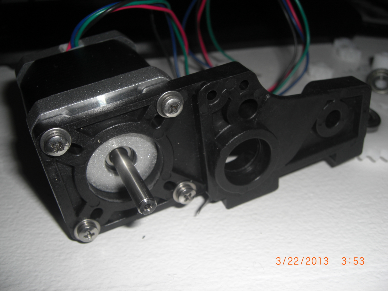

extruder done, wont be long now..My gears for the extruder were warped causing some binding. I had to do some sanding in order for it to spin freely. Very unusual. Seemed like the quality of those gears were lacking a bit but I got it to work. I didn't put a flat on the stepper motor shaft this time. Seemed like the press fit gear had plenty of bite to stay on the shaft.
I had more photos of the extruder assembly but it didn't depict the correct assembly in those photos so left those out, I didn't want to post incorrect assembly photos. I actually assembled it by ear, not looking at the instructions just to see if I could figure it out. Only following the steves extruder assembly pdf found here. http://seemecnc.org/download/RostockMAX/Assembly/
final steps next, installing the hot end and finishing up the rest of the wiring. I should be able to power this thing up soon..

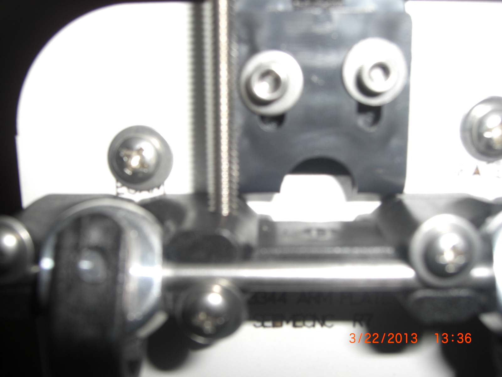

Finished up installing the hot end and most of the wiring along with the limit switches.
I wasn't too happy with the way the screw sits for the limit switches, Every hole in the mount was in a different spot. So it effected how the screw touches the limit switch. Considering the small area where the screw head needs to make contact with the limit switch. Position of these holes are critical for proper operation. They need to get better at accurately positioning these holes.
Photos of all three axis, every hole for the screw is in a different spot.
First photo, hole slightly on the slope of the mount
second photo, hole right in the middle of the slope. (where the slope meets the flat) This was the only one that hit my limit switch right on center. So IF you guys at seemecnc are reading this. THIS IS WHERE YOU NEED TO DRILL THE HOLE!
third photo, hole off to the left of the slope.
