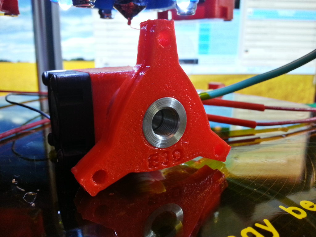

Alright, well now there is a printable mount for using the Bowden version. http://www.thingiverse.com/thing:137140
Re: E3D V4 All metal hotend
626pilot, thanks for posting the link for the E3D mount. I was hoping someone would come out with that.
The wood ones from SeemeCNC works okay but it is nice to have options. Thanks again!

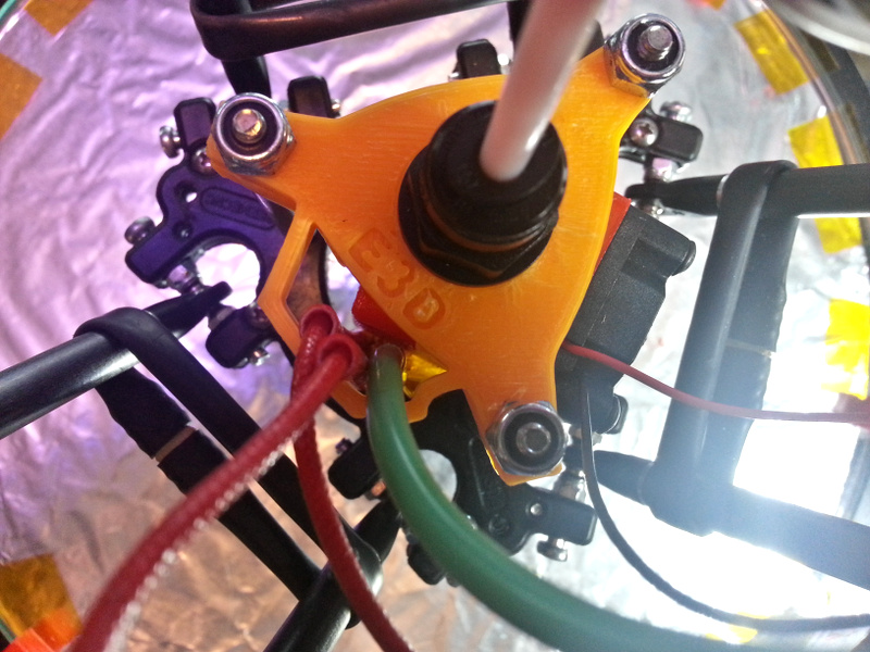

I updated the Bowden version mount to include a version of the upper plate with cable management. It's a clip, thin enough to be bent open and wide enough to handle the heat and sense wires zip-tied together. I also updated the instructions about how to top-mount it: you need 2.5" #6-32 screws and 1.5" spacers. I recommend longer screws so you have something to lash the wires to.

626Pilot, would you mind take a picture of your setup from the side so I can see how long the screws protrude? You said you used 2.5" and you use the extra length to zip tie cables to, but I can't really tell from the picture how much extra that gives you.
Going to print the holder before it shows up sometime in the next 2-6 weeks...
They actually don't protrude. There is just enough for the nylock nuts I secured them with. I would use a 3.5" #6-32 or longer. The heater cartridge is just a cartridge with bare wire coming out of it - there is no strain relief connecting the insulated part to the cartridge. That means you have to take special care not to let the wire flex at all, or else you're looking at them either breaking or burning out a fuse. The cable management clip should help a lot with that, but it's still better to lash them to something really solid.

I have been thinking about adding a small mast to the top plate next to the cable management clip to lash wires to. Is that something you'd find useful?
