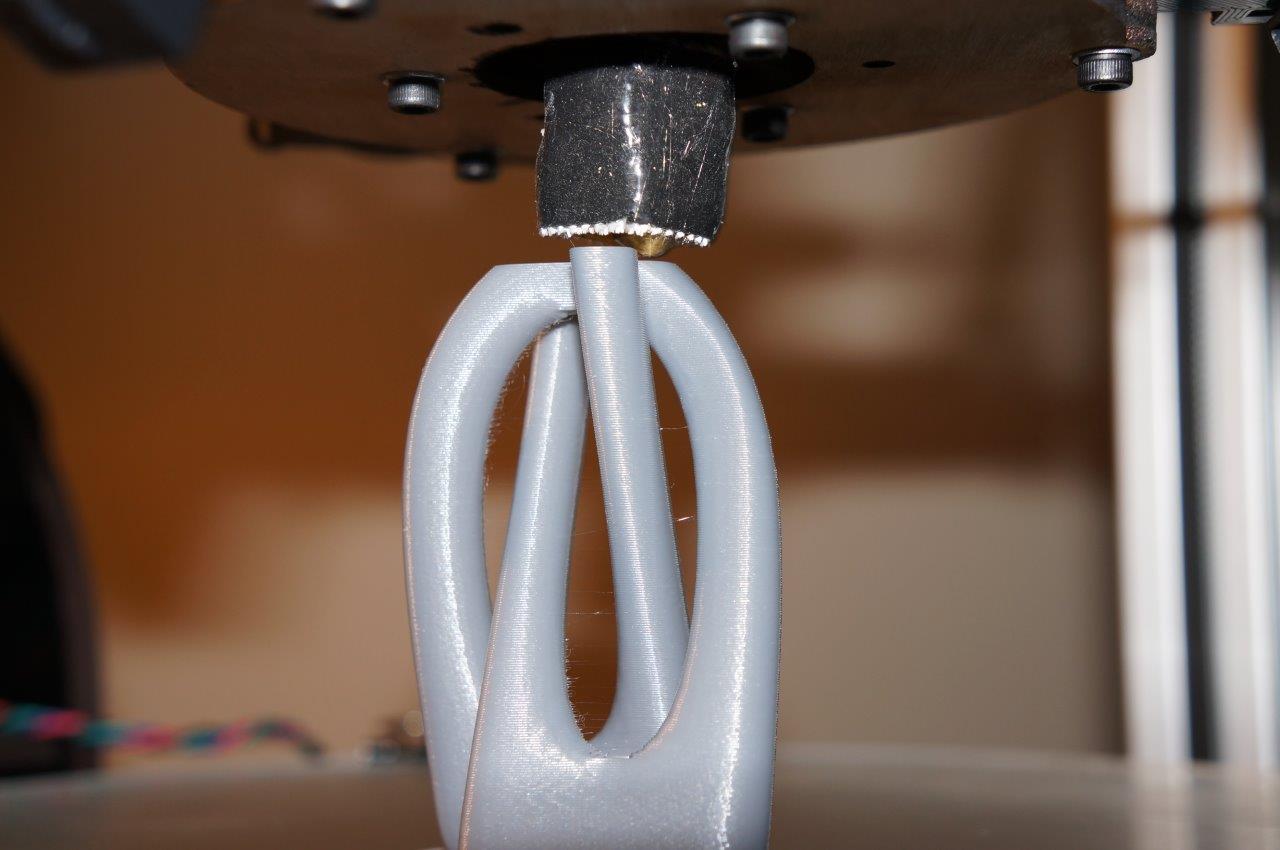

First print. Looking good!!!
How difficult was it to JB weld the Balls to the cap screws?
Not hard at all. If the ball is sitting on the rod end with the magnet inside, the magnetism holds the cap screw to the ball. I kind of twisted the cap screws upside down into the JB weld to pick up just enough JB Weld on the top.
I had to carefully use small needle nose pliers on the side of the top part of the cap screw below the ball when installing the cap screw/ball combination, because it still takes a fair amount of force to screw it in, even though I ran a longer 3mm screw through first a few times to get the thread going. On the other hand, if I had a piece of latex rubber between my fingers and the ball, that might have allowed me to apply more force so that I wouldn't have needed the needle nose pliers.

bplemmons wrote:Anyone have some before and after, print quality pics to share?
You can post them on what are you making...
Love to see them!!
Bill
Not quite perfect, but a big improvement. Click to zoom in. The rough part on the stock arms side I believe was where the loop starts after a retraction and move. Kisslicer staggers the start point on each layer. The other side of the Vica sculpture looks great on both prints.
EDIT:I've replaced the photo because on further inspection, the issue with the rough part on the stock arms print may have been retraction-related rather than an arm issue. The quality of the print is much improved with the magnetic arms, and this updated photo is a better comparison of print quality. Notice the better layer alignment on the magnetic arms version, which was actually printed faster.
Love to see them!!
Bill
That is a noticeable difference. Did you see the one I printed with stock arms, came out close to yours with the stock arms. I can't wait for my CF tubes to arrive.

elqisqeyano wrote:
Love to see them!!
Bill
I noticed after the print that one of my cheapskates was a little loose. That could account for the few imperfections that are left in the print with the magnetic arms. I won't have access to my printer until tomorrow, and I'll try another print then.

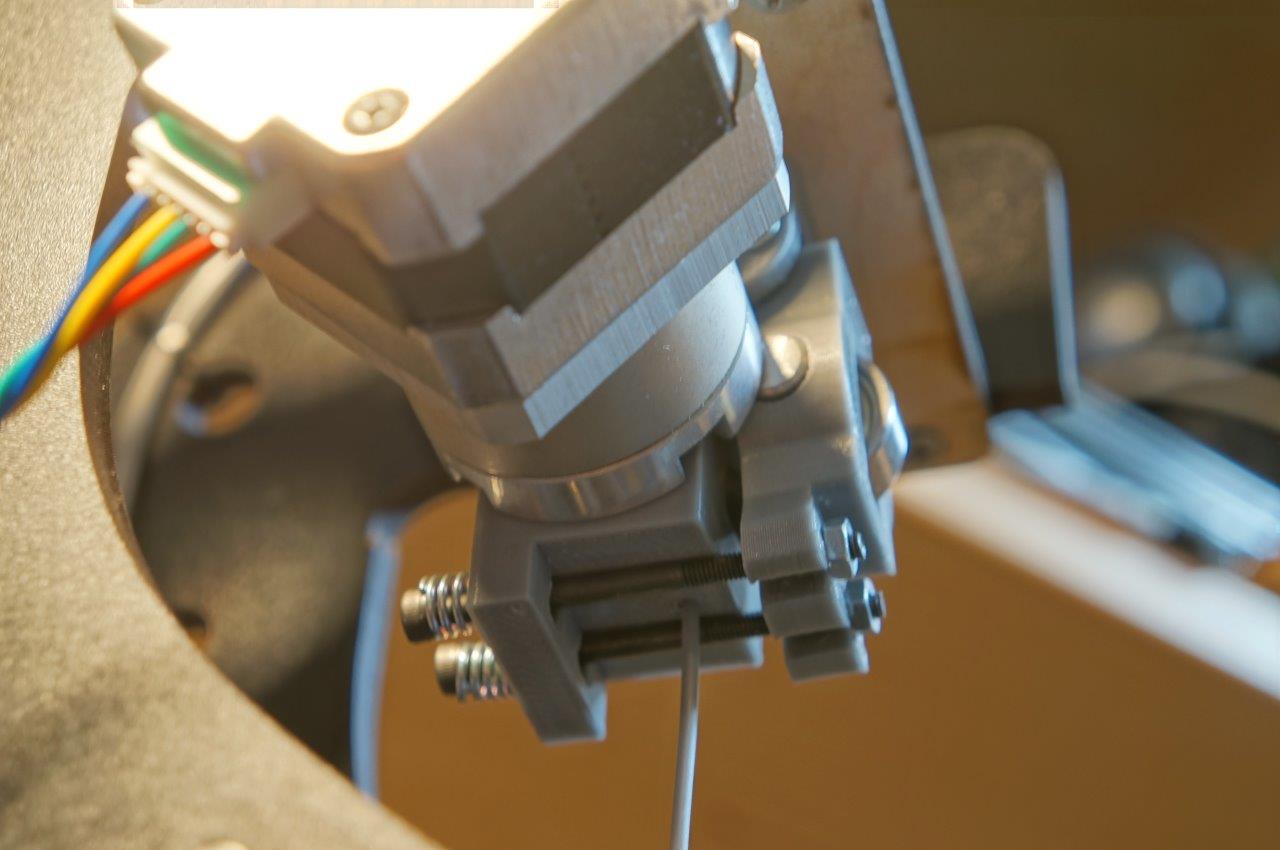

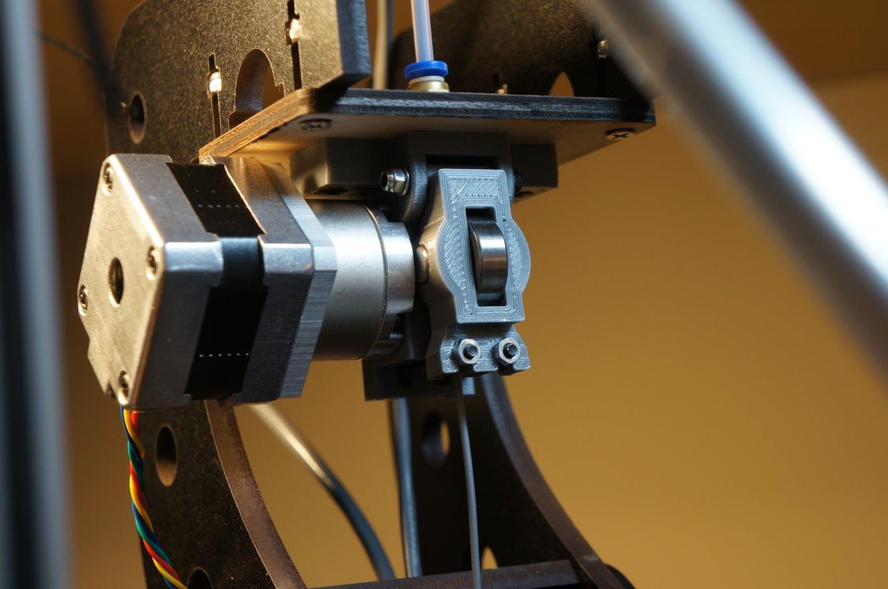

Here are some pics of my new quick change extruder setup...
I'm using a 5.2:1 geared nema 17. I am set to 60mm/s retracts and the Rambo current is set at 115. I think I can go even faster on the retracts. To change the filament you just push the two long springed screws down and pull the bearing piece forward. It is super quiet! These are the extruders I use on all my other printers like the Behemoth. A little pricey though as the stepper and gear are about $50 to $60. For me it is well worth the price. I have hundreds of hours of use on these and they just keep on going and going.
In the pics you can see I put the hole in the wrong spot for the bowden tube on the laser cut piece. Doh!
The files are up on my github https://github.com/xnaron/Xnaron-Magnarms-for-Rostock

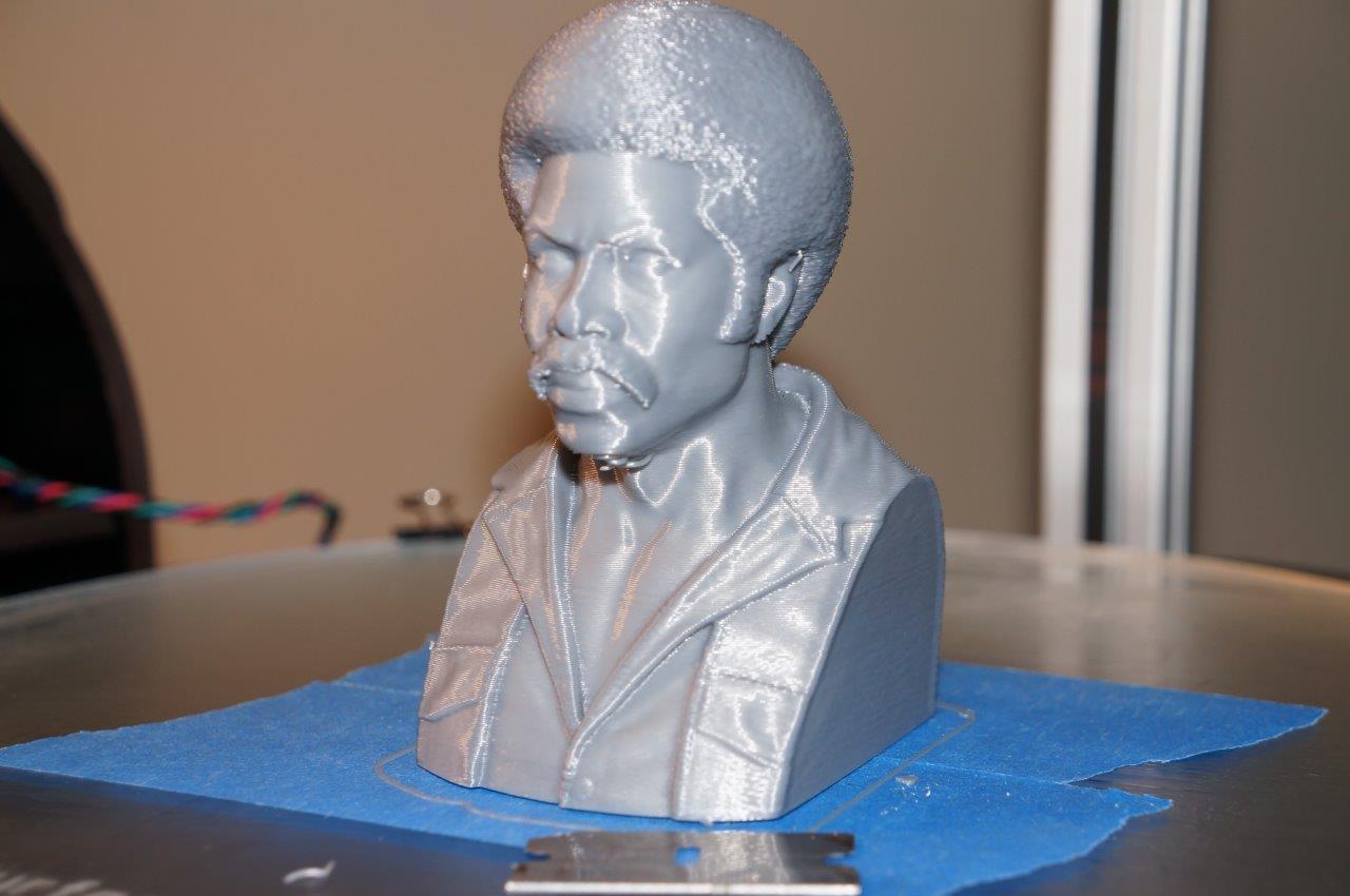

Because there are too many Yoda's...
Printed at 200mm/s in 45min. It is 100mm high.
