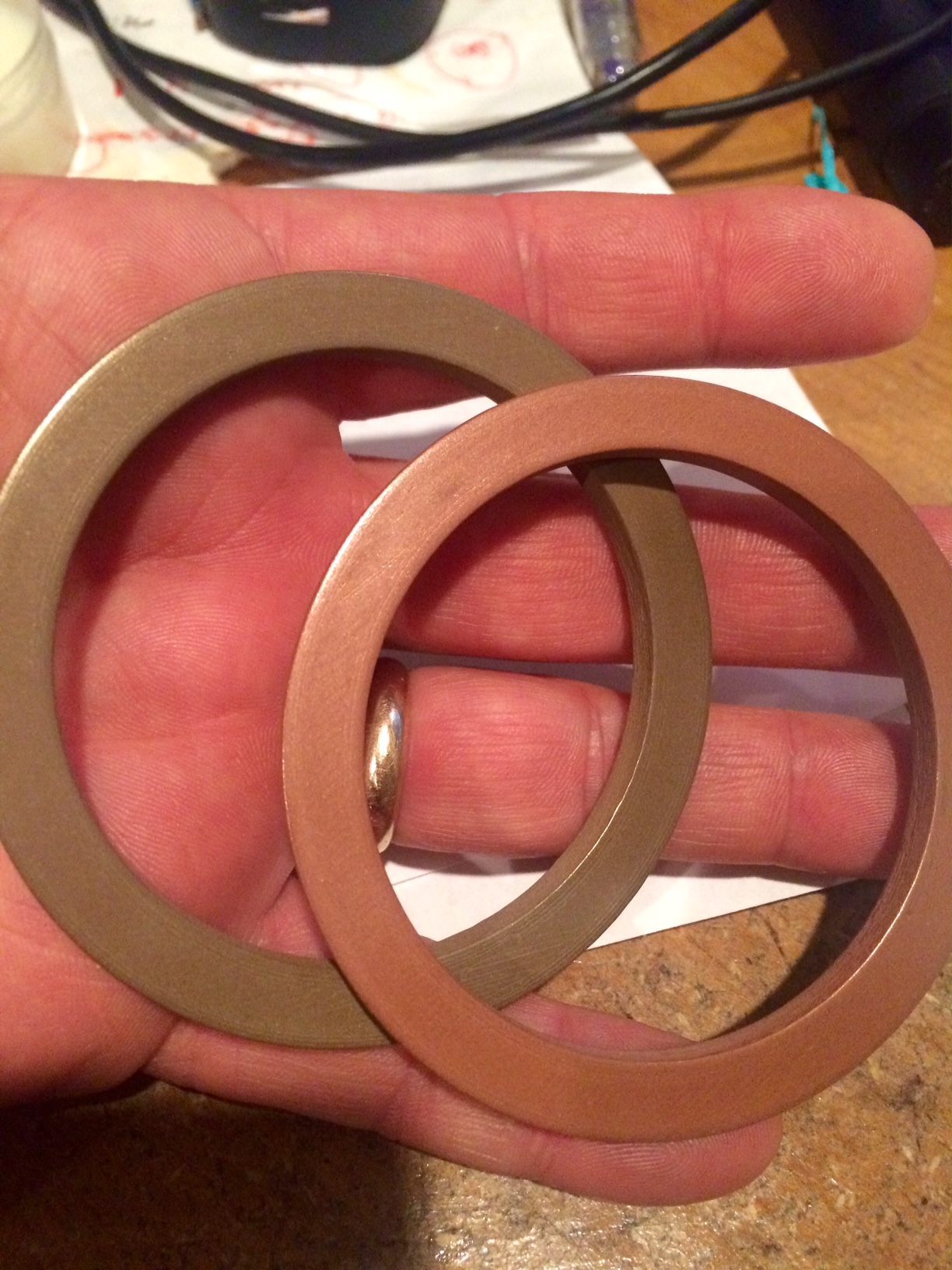

@ mhackney, have you had any luck polishing the bronzefill ?
I tried with a tumbler using small, round shot but the results were rubbish tbh.
Re: 3D Printed Fly Fishing Reel
Yes I have. I use SS media in a tumbler with water. It comes out looking in and shiny. First, any rough areas have to be sanded (320 grit) though.

Any pictures you could upload ?
I've uploaded a few here and there. I'll see if I can dig them out. You really can't tell from the photos though.
This was posted in this thread a bit ago. This is what they look like, nice and metallic looking.

Very nice, way better than the results I got.
What sort of media did you use and how did you tumble?

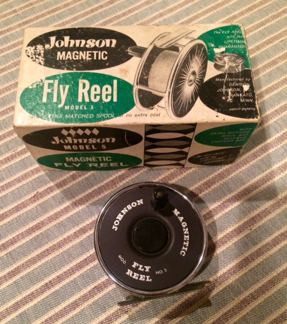

Just came across an interesting idea on Thingiverse, a reel incorporating magnets as a drag system .... http://www.thingiverse.com/thing:759561
Yeah, there was a company that manufactured a magnetic drag fly reel back in the 1950s and early 60s - Johnson Magnetic Fly Reels. I own this excellent example in its original box:
It is a simple check and is silent. Tis reel worked nicely but the magnetic is at the center in line with the spindle. The reel on thingiverse has 3 magnets 120° apart. This would give a pulsating feel when retrieving and when a fish runs with the fly.

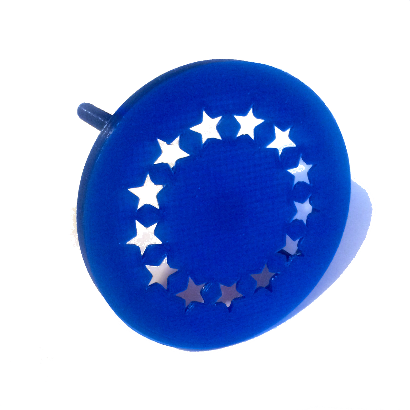

I've released a new reel backplate to folks who have registered on my 3d printed fly reel file download page. This design features 13 stars to celebrate the original 13 colonies that declared their independence on July 4th, 1776. If you have downloaded the files you should have received an email with this new part attached as an STL.
