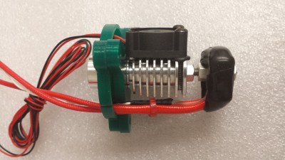

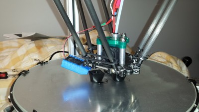

Just want to clarify a few things with the Prometheus v2 beta that I plan to install on the Rostock Max v2.
1. this is as good as any for the hot-end mount?
http://www.thingiverse.com/thing:298553
1b. which J plate for a stock setup? or is that a silly question. I planned to print all 3 options and see whats working.
2. i am removing the old hot end (brass). Should I add connectors for the wiring?
3. anyone have a pic or short video of their rigging of prometheus v2 on a rostock max v2?
Thanks for the help. I'm looking forward to the freedom to print all sorts of wonderful materials.
James

I used the same linked mount. A couple pictures are attached.
If you use the stock aluminum posts, you will need some spacers to clear the fan height. I used 2 #6 flat washers per post that were matched heights so I did not skew the hot end.

by Jamesthiago
that looks great!
now i'm ready to switch hot ends. Thanks for the pics
