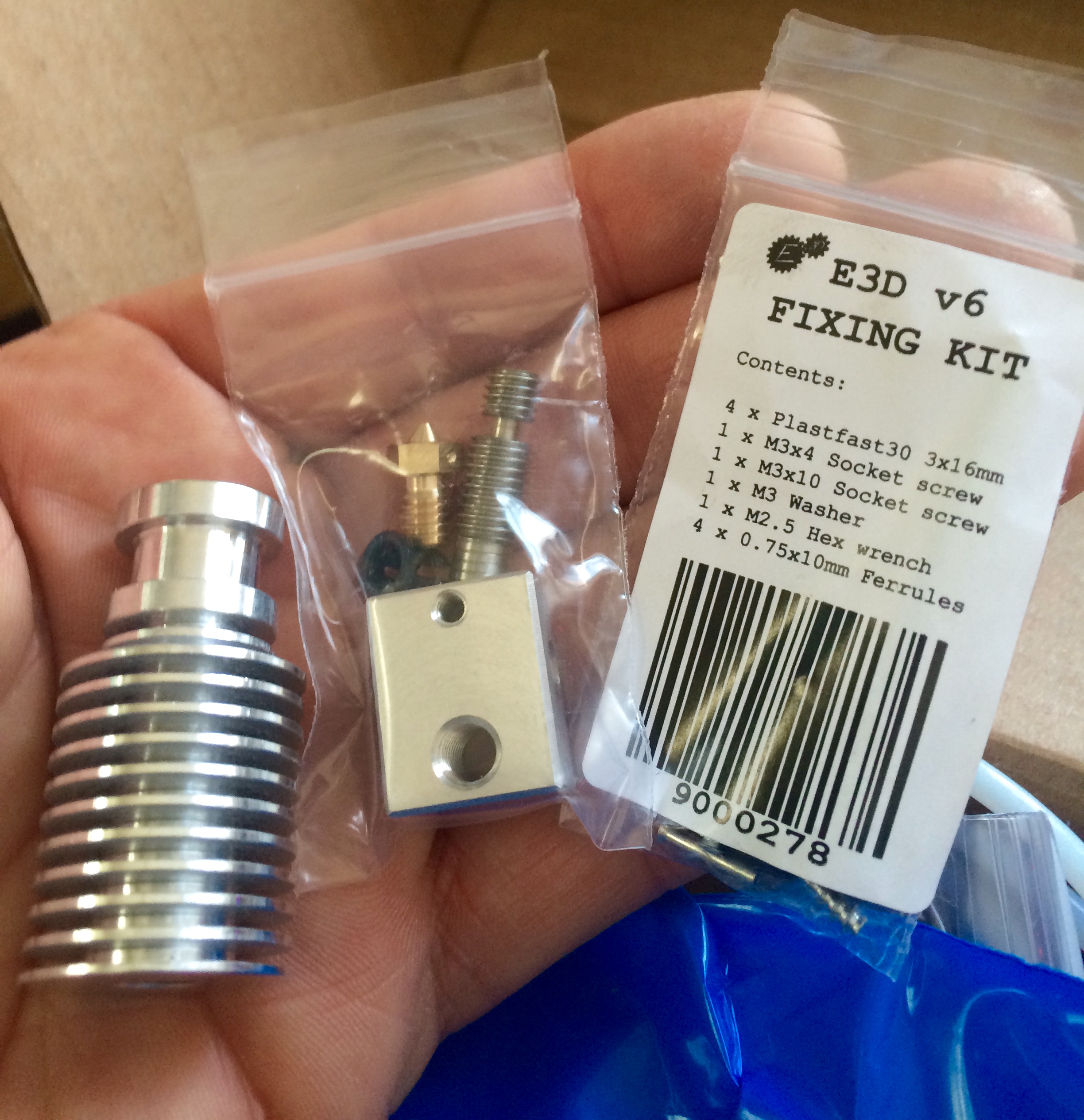

My Cyclops came with 3x M3x10? button head screws and washers for mounting it.JFettig wrote:What hardware do the CHIMERA and CYCLOPS come with? There is a pic here:http://e3d-online.com/Chimera but does it come with any sort of mounting hardware or do I need to make a trip to the hardware store? Mine arrives Monday
-by mounting hardware, I mean screws, not platform attachments of course

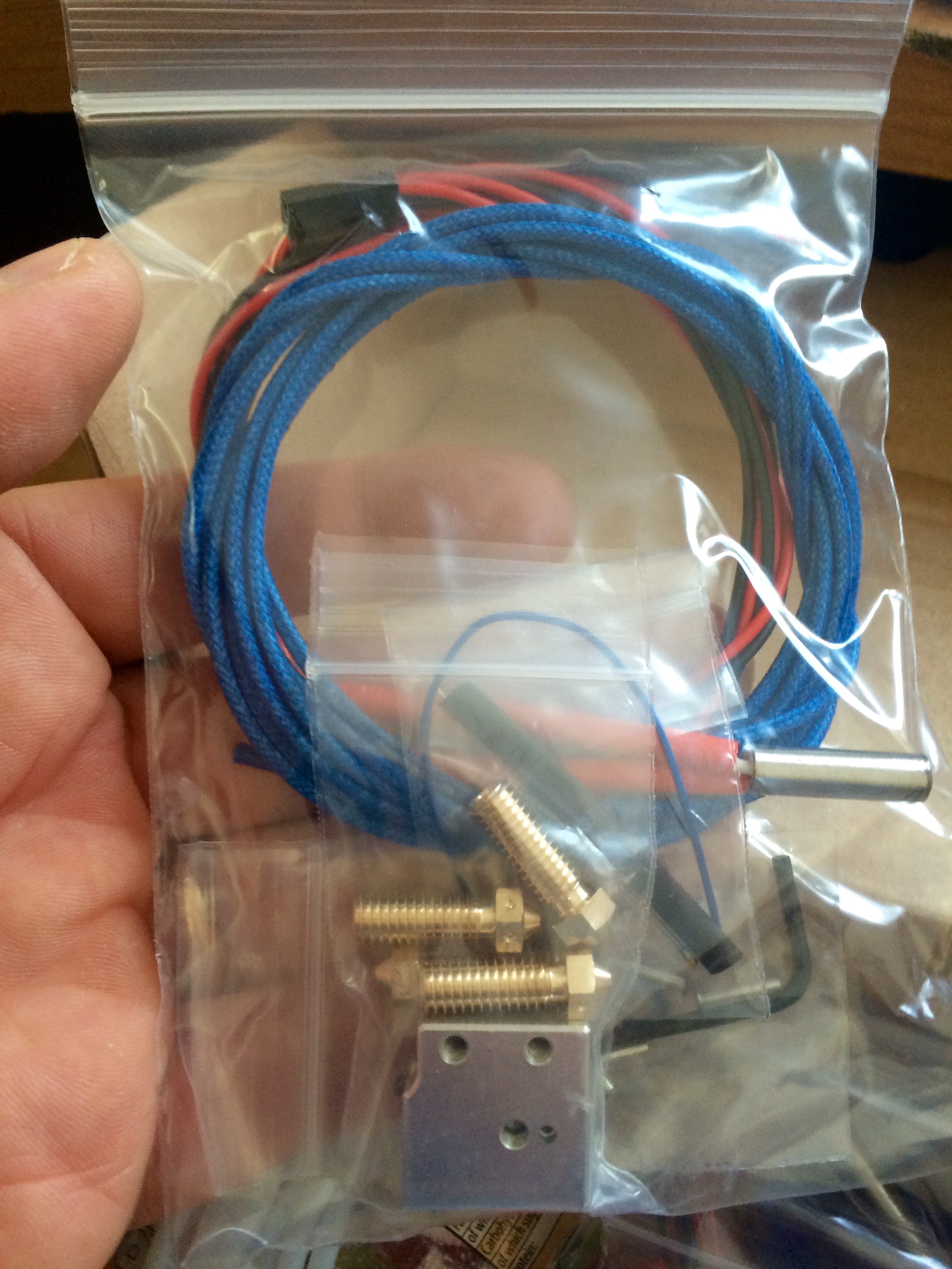

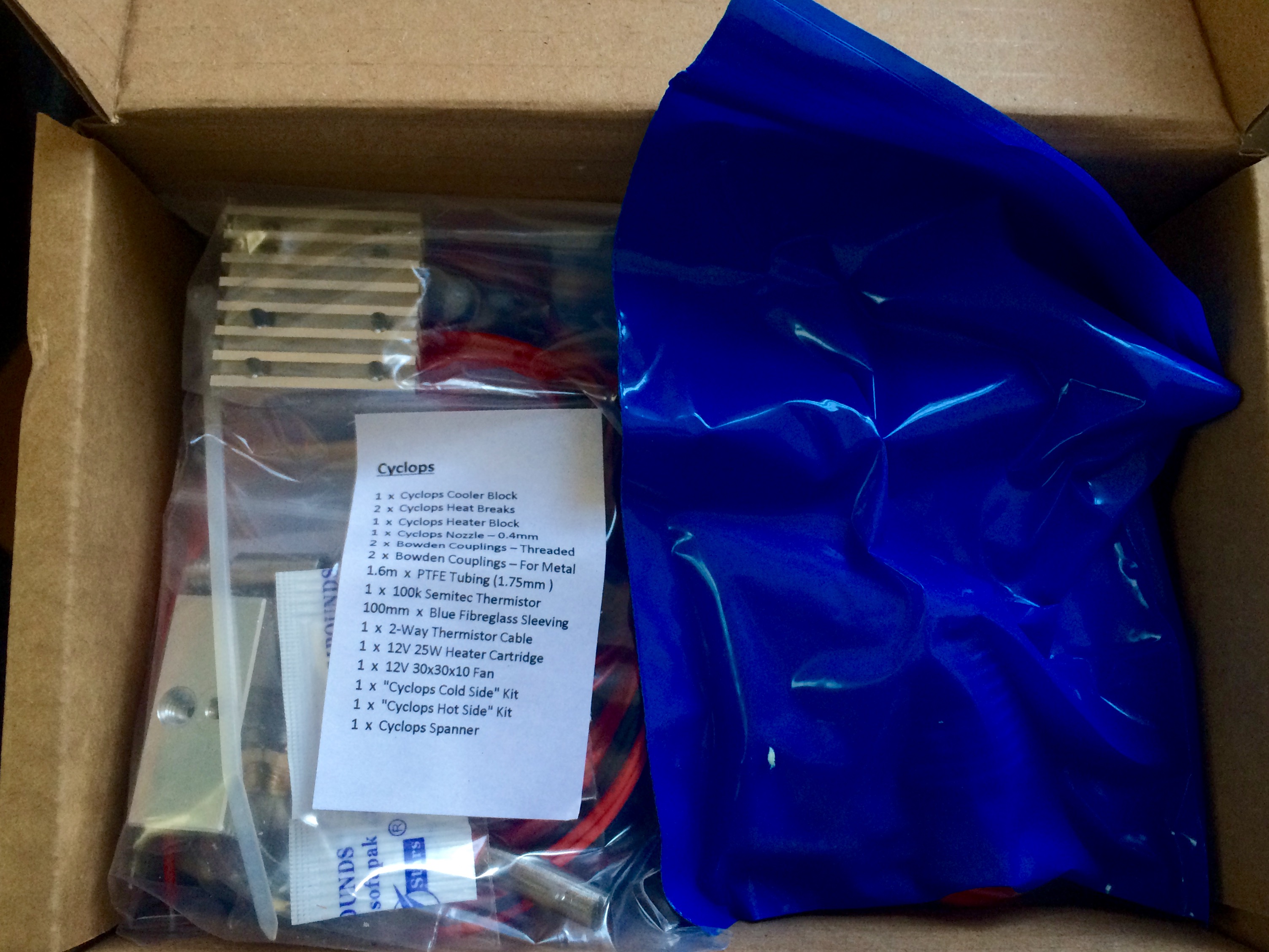

Mine showed up early
