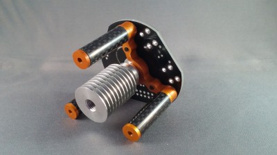

I received the first production prototype today, and wow! These are expertly made, very sharp, and the presentation in the box is awesome!
[img]http://i.imgur.com/NeI31tV.jpg[/img]
[img]http://i.imgur.com/a9QWfpI.jpg[/img]
[img]http://i.imgur.com/JMqY3YT.jpg[/img]
[img]http://i.imgur.com/cdODEHz.jpg[/img]
[img]http://i.imgur.com/JiA3TXY.jpg[/img]
[img]http://i.imgur.com/iUWyNkN.jpg[/img]
[img]http://i.imgur.com/BhOR9mv.jpg[/img]
[img]http://i.imgur.com/Omlw3S0.jpg[/img]
The plan is to do the install at The MakerHive on Thursday. I'll have some more pictures then, as well as a report of how everything fits and installs. Stay tuned!

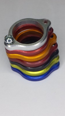

Hey Everyone,
I am back home for a few days and working hard on the mill to get some of the last test mounts out the door and also to make corrections from the first beta tester worked into the tool paths. I am only home for a few days again this week but I plan to mill as much as I can while I am home. The new custom CNC mill is just about ready to be ordered. It will take a week or so to get it made and then about another one to get it installed and dialed in. After that I hope to catch up much faster as my cycle times should be greatly reduced so I can make better use of my limited time at home each week for milling. I also added a few new colors to the anodize selection to now include Gray ,Green, Copper, Bronze and another shade of Yellow.
Color samples
Color samples
We already had bare aluminum, Bright Red, Orange, Deep Red, Black, Yellow (touch of green to it) and Sapphire Blue.

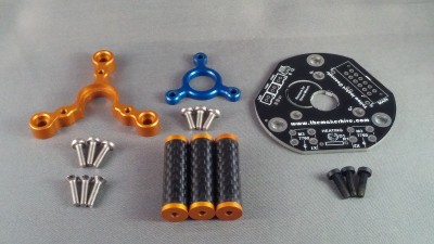

So I have been working on the what I hope will be the final version of the mount. It has been expanded to cover working with and without the Yellowjacket board on both the E3d V6 and a standard J head mount print head. I listened to the feedback from my BETA testers and worked as best I could to make the changes they asked for.

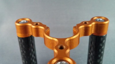

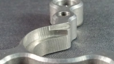

The biggest change to the mount is a small notch cut into the side to allow clearance for both the E3d V6 and the standard J head style to fit into it with ease. This should allow me to just have one mount style in stock for both the E3d V6 and the standard J head style hot ends. The new notch allows for mounting either style to the same mount without any changes on the users end other than switching out the hotends and screwing down the screws once more.
The new notch for clearance on the mount.
The notch allows for a 16mm wide passage. The recess holds the mounting flange of both an E3d V6 or a J head style hotend.

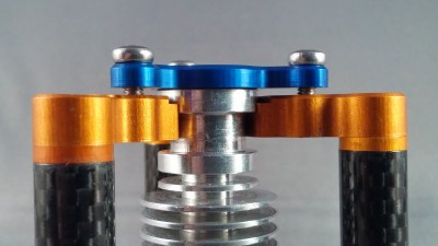

The mount works both with and without a Yellowjacket board. If no YJ is used then an anodized aluminum locking ring which stands on top of the hotend mounting flange is included along with 3 M3 8mm screws for securing it in place.
The locking ring sits atop the hotend mount flange to secure it.

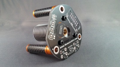

A Yellowjacket board (http://www.themakerhive.com/shop/viewit ... oductid=20) may be attached with the provided nylon screws so all versions of the Yellowjacket board with work with this mount.
The Yellowjacket holds the Hotend flange in the mounting recess with 3 nylon screws.
All the contacts on the Yellowjacket board are given clearance and nylons screws prevent any short circuits between the board and the mount.
Each kit will include the following: 1 anodized aluminum E3D /J head mount, 3 custom length carbon fiber spacers with anodized aluminum end caps, 3 m3 8mm screws for mounting the mount to the top of the spacers, 3 M3 12mm flat screws for mounting the assembly to the effector plate, 1 anodized aluminum lock ring, 3 M3 8mm lock ring screws. 3 nylon M3 10mm screws will be included if requested for mounting with a Yellowjacket board. (mounts and lock rings can be anodized in a wide range of colors, custom length spacers can be almost any length.) We are looking to sell the above kit at $35.00 + shipping (flat rate USPS priority mail).
The Yellowjacket board is not included in the kit. 3 Nylon mounting screws are included if requested for a Yellowjacket mount kit.
