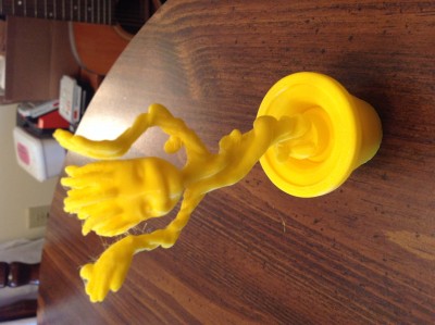

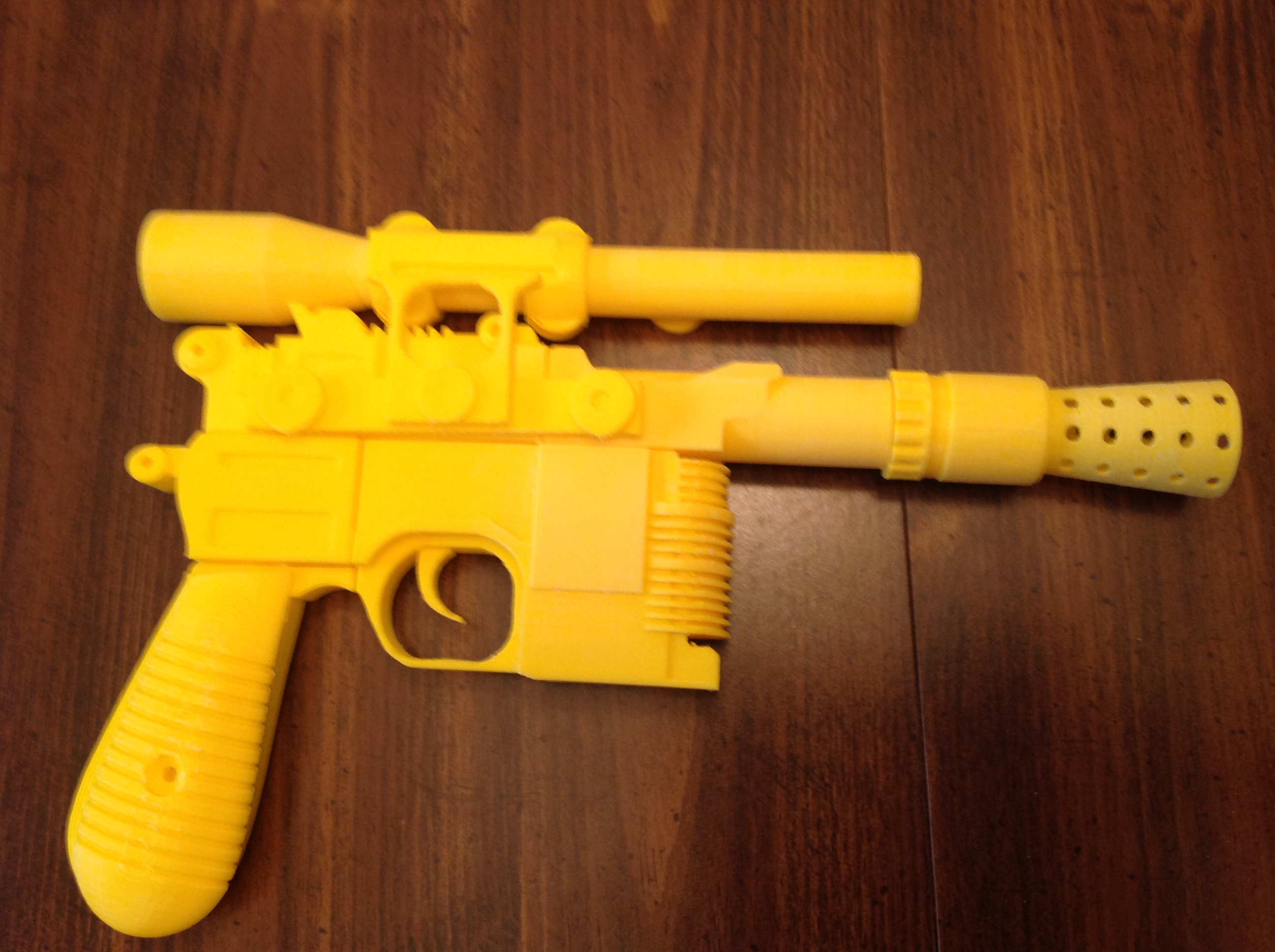

I think I've got the temp and speed where I want it. Still dealing with some strings but they're improving. Detail on the prints is outstanding.
It's not how fast you print, it's how well you print fast!
- Windshadow
- Posts: 526
- Location: Mid Coast Maine
cool modified Mauser 1896 broomhandle pistol model , as you say great detail I hope you will paint it to look like the Star wars prop as well.. Winston Churchill's favorite side arm in the Boer war... though without the lewis gun flash hider... Mind you mine is a WW2 bringback of my dads in 7.63×25mm Mauser and with Russian surplus (7.62×25mm Tokarev).30 ammo the only stuff you can find to feed it these days... the muzzle flash is enough too blind you at night!

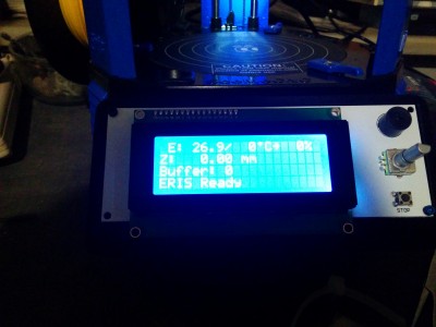

Installed the smart controller tonight. I have to make some minor adjustments to the stl files, but other than a little tight Interference with one of the connectors, it appears to be a painless Install, just Plug n Play.
