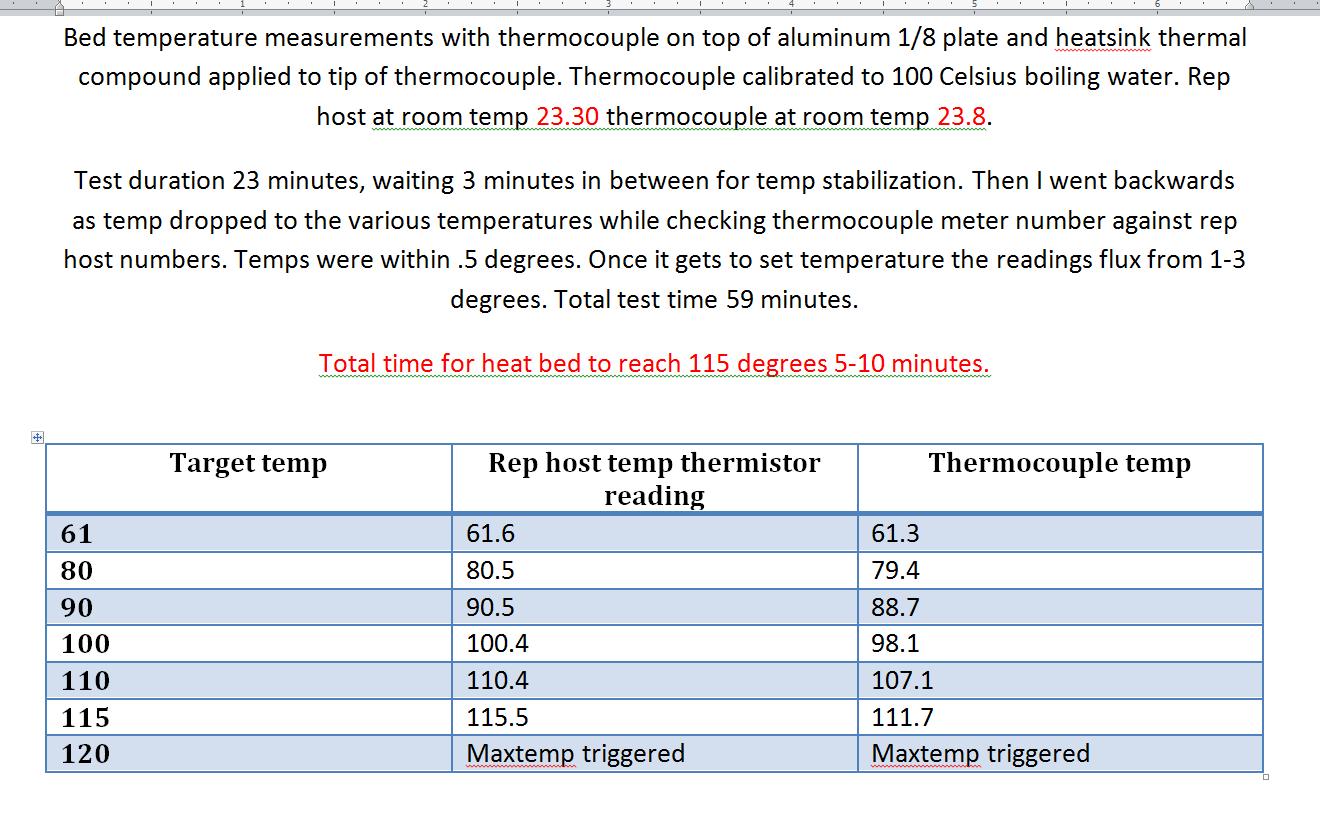

will do, I didn't think about doing it that way. I'll try that and see if I get better brass readings. With the thermocouple in the brass nozzle, I should be able to get better measurements.
and i'll check my thermocouple as mhackney suggested.
edit: checked the thermocouple calibration against boiling water. It was just slightly off. 98.9 degrees Celsius so I adjusted it to 100. then rechecked.
will redo the test and post report.

So I redid the bed temperature test after some changes here is the result. Will redo the hotend temperature test. later tonight.
Edit: got side tracked and didn't get to the hotend test, will pick up again tomorrow.
temperature graph, waited for the bed to reach room temp. rep host temp 24, thermocouple temp 24.5
Total actual time shown from room temperature to 115 degrees.
Note: I am using a dedicated 24v 750watt 31amp Meanwell power supply with ssr to control power to my onyx. rambo board is run off stock 12v power supply and using marlin firmware. (stock firmware with no changes)
I did another test with repetier firmware installed. Heat up to 115 took about the same amount of time. One thing different about repetier firmware (stock firmware with no changes) is that it did a better job of keeping the temperature steady. less temperature flux. graph shown below.

WOW!! 110 degrees in just over what 4 or 5 minutes?!?! Awesome, looks like that one is dead on.

I read another post that repetier firmware has faster heat up times. Although 4 minutes to 110 is pretty good for me, I might try it just to see the difference.
when i was troubleshooting my lcd issue, swapping firmwares around, I'd forgotten that marlin firmware was reinstalled.
this gives me a good baseline reading to determine what temperatures i need to set in the host software to get my bed to required temperatures.
for example: if I wanted a bed temp of 110, i would need to set the temp in host to 115 or so because actual bed temp of aluminum is a little lower.(with marlin firmware)

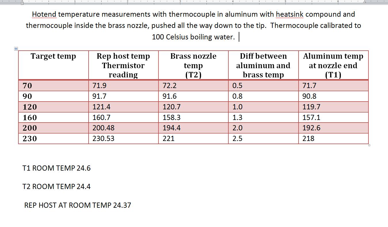

Alright i finished up the second test for the hotend measurements according to forum suggestions. This time using repetier firmware because it just seems to hold temperatures better.
Something to note from the measurements is that the temperature inside the brass nozzle starts to drop off at higher temperatures, Maybe because the aluminum is doing its job and acting like a heatsink to take away heat?? or some other factor is at play here.

FWIW the AL heater on my hotend is wrapped with silicon tape and I find it seems to perform better.
I didn't really wrap it to improve performance, I did that because the rather large fan I had blowing across the print was preventing the hot end reaching temperature.

That looks a lot more "normal" to me, changes to the Therm table or just altering the expectations should get you there.

I just complete the pid autotune for both hotend and heatbed. now the temperature stays more linear. nice
