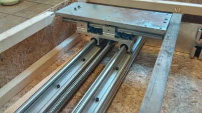

Thanks! This was pretty much my first ever milling project in anything over 1/8" aluminum. For the shapeoko it is a HUGE project to undertake when you are new to CNC mills. I have since gotten the times down even more, still a bit higher than I would like on the OKO but for the mill it is impressive. The new mill is coming in this week. The gantry arrived today and I love the work on it. Nice big BEEFY ball screws. The new 2hp spindle will arrive Friday and the base should be here the following week. I made some last minute changes and the base got delayed a bit due to them. For now though the OKO is kicking butt and knocking out mounts and end caps at a nice enough pace. The new mill will knock these things out in a few minutes each like you spoke about. The only issue is that today Michelle ( My better half) took a job offer from Marshall Space Flight Center.. So next month we are packing up the whole joint and moving from one NASA job to another NASA job. So... For now the OKO is going to be pulling the cutting duties as setting up the new mill then taking it apart for shipping to Marshall is not really a good idea it seems. On the plus side the OKO is doing the mounts MUCH faster than before and I can plate up a 8x10 sized piece of stock and set it to run over night and wake up to over a dozen new mounts each day which works for me. CNC milling is really still a side hobby for me. I am pushing for a basement house ( we do not have those in Houston) so I can set up shop there instead of the garage or in the house as I am now. I also have my eye on a g0704 vertical mill and conversion kit like you speak of. If we were not moving next month I would have it ordered already.
Over all it has been a great learning piece and I have learned a great deal about CAD, CAM and milling. Before July 2014 I have never touched CAD or a mill so I am just learning the hobby as I go along really. I have turned out a ton of PCBs on the OKO and that will end up being the role it plays down the road mostly as it does a super job on them and I LOVE watching IT dill 100+ 1mm holes VS the old days of me doing it by hand on the drill press (DO NOT miss those days AT ALL). I am lucky that this is still a side hobby for me and the Michelle is pretty much the bread winner over all (not by much though). As soon as we find the new place and get settled in I will get the new mill enclosed and all setup ASAP. The OKO will go right back to work the first week we move in as I have other projects it mills each week also. Between now and then the OKO will be turning out mounts and end caps nightly. I never dreamed anyone would have much interest in this project as it was simply a test of my milling skills and an excuse to anodize something and put it on the MAX. I also never planned to sell them when I made my first post here either. I am really looking forward to running the new mill and part of me is not so happy to be moving at this point in time, but we have to go where the best jobs are and a step up is always the best way to go in my book. Besides, I am sort of tired of all the flatness here in Houston. I travel every weekend 10 months a year for my work and it will be nice to not always come home to a flat landscape for a change.
New Gantry for the mill. Nice beefy BALL SCREWS!
