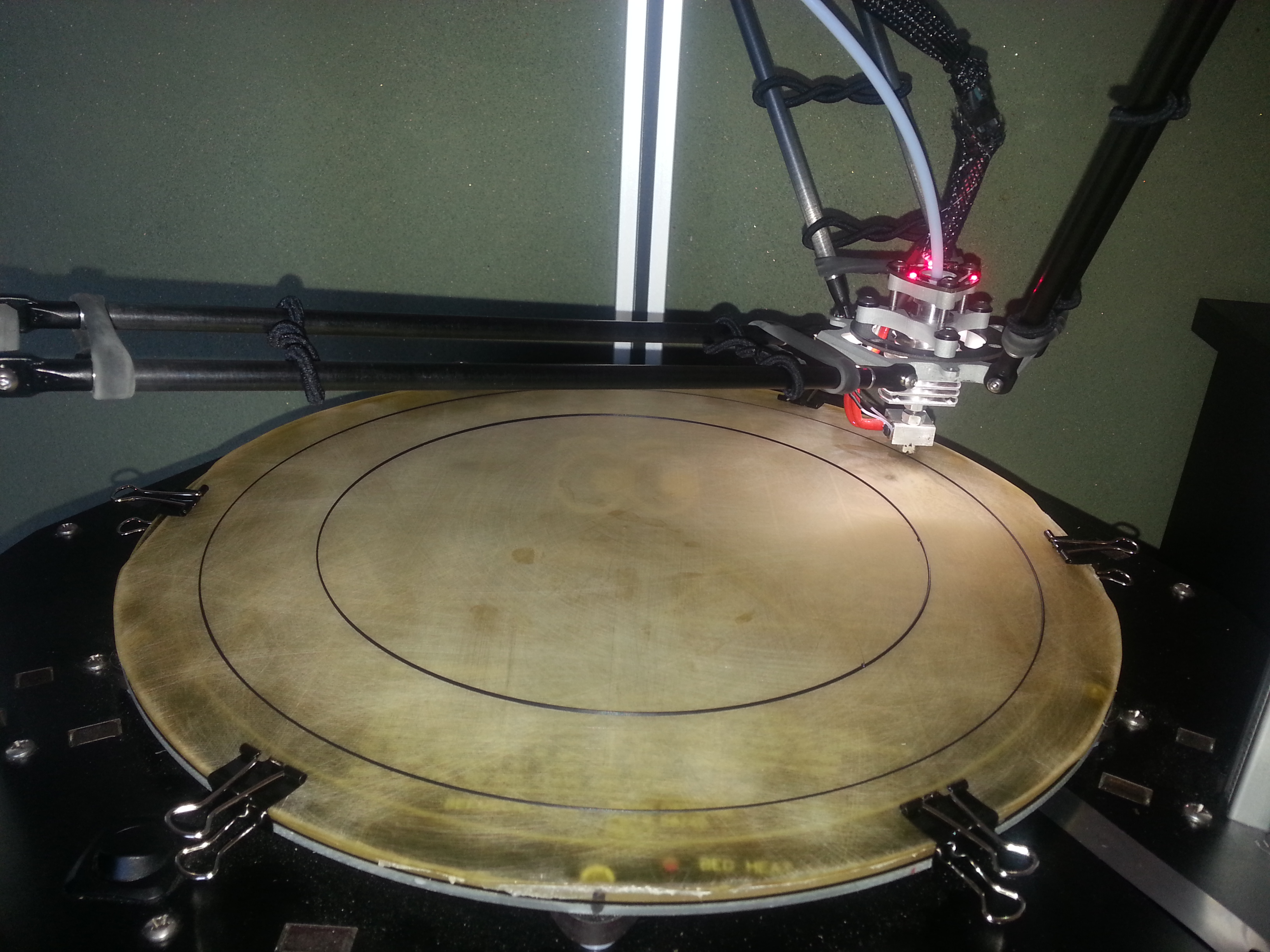

Re: Delta Automatic Calibration Tool - For Repetier Firmware
Yes, the FSR and mini input board (which I think is perfect and required) works great with Smoothie. That's where I started. I then added one to my Rostock Max running an Azteeg X3 Pro and then my Taz5 running a Rambo. I have another hooked up to a Duet but I haven't completed that build.
Rostock Max v2 with a few upgrades from youbvandiepenbos wrote:
@KAS, what machine are those numbers from? they are virtually perfect !
I like what you did with mounting height and location of light ring, I did not think about light ring mounted there.KAS wrote:Rostock Max v2 with a few upgrades from youbvandiepenbos wrote:
@KAS, what machine are those numbers from? they are virtually perfect !I'm working on getting that infamous 11" circle.

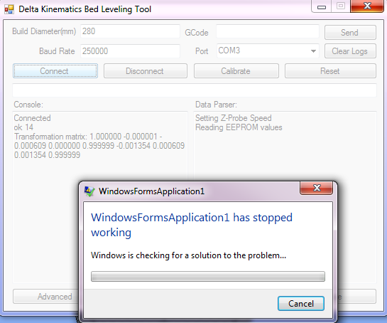

I thought I would try out the latest but it keeps crashing. Known problem?
Yeah, you will get this occasionally I haven't found the exact problem, but make sure that the com port is open. So, disconnect from any host, and if else try restarting your printer. What version of repetier are you on? Might even be Windows 7, I haven't had a chance to test with that version of Windows, just 8.1 and 10.mhackney wrote:I thought I would try out the latest but it keeps crashing. Known problem?
I'm running Windows 7, I avoided the Windows 8 "disaster". I have rebooted both printer and Windows. Repetier .92-3 but still have the problem. I can run Mac OS X too if there is an option for that. Otherwise, I guess I'm dead in the water.
