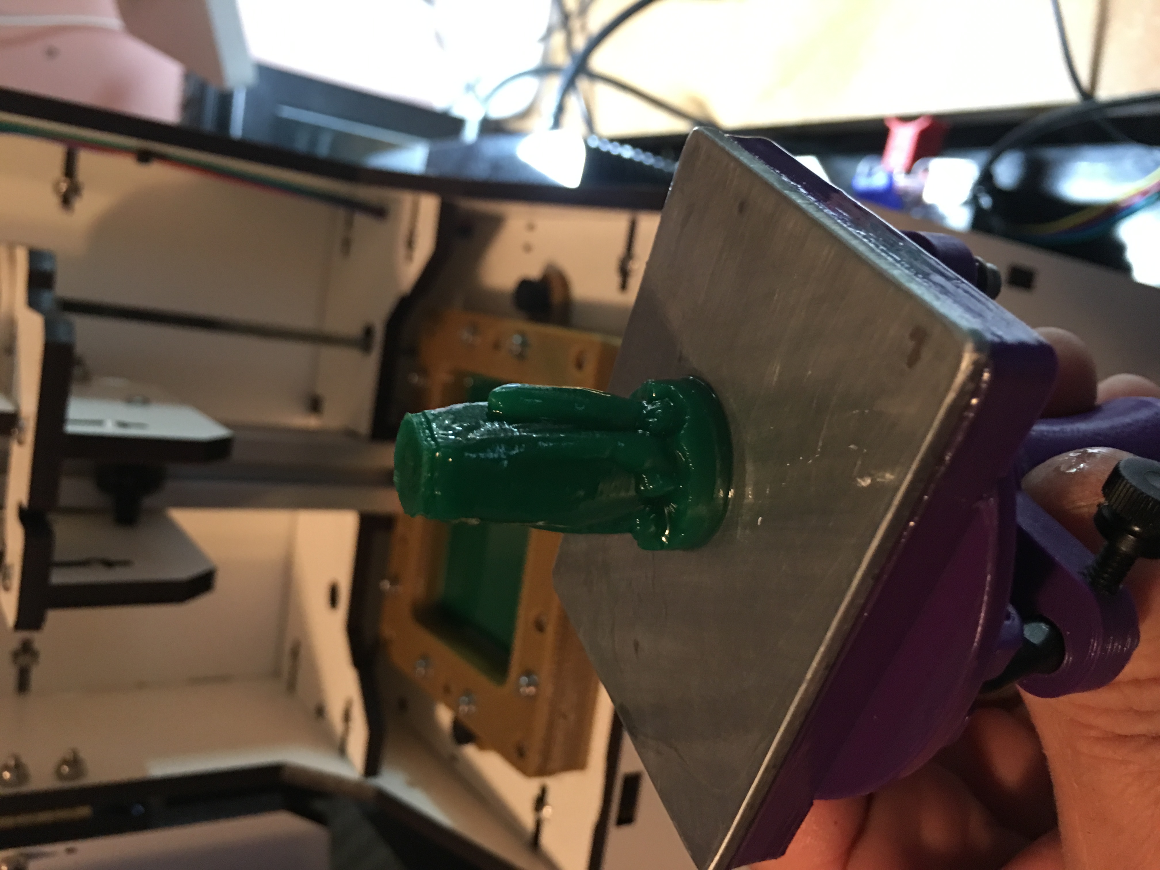

Ok, I've been resurrecting my DropLit over the last week. Now that there are alternatives to Creation Workshop I decided to give it a shot. I chose NanoDLP because it runs on a Raspberry Pi (v3) and can control both the Z and the projector. I had issues because I primarily use Macs and CW was Windows only. Now it makes no difference as the client is a web browser with NanoDLP. It was not straightforward swapping over though. The documentation for NanaDLP is non-existent and they use different names for settings than CW did. Pain in the A. Several folks on the Facebook group helped me plow though it and today I finally got NanoDLP controlling my DropLit, projector, slicing reasonably and now I'm doing a test print.

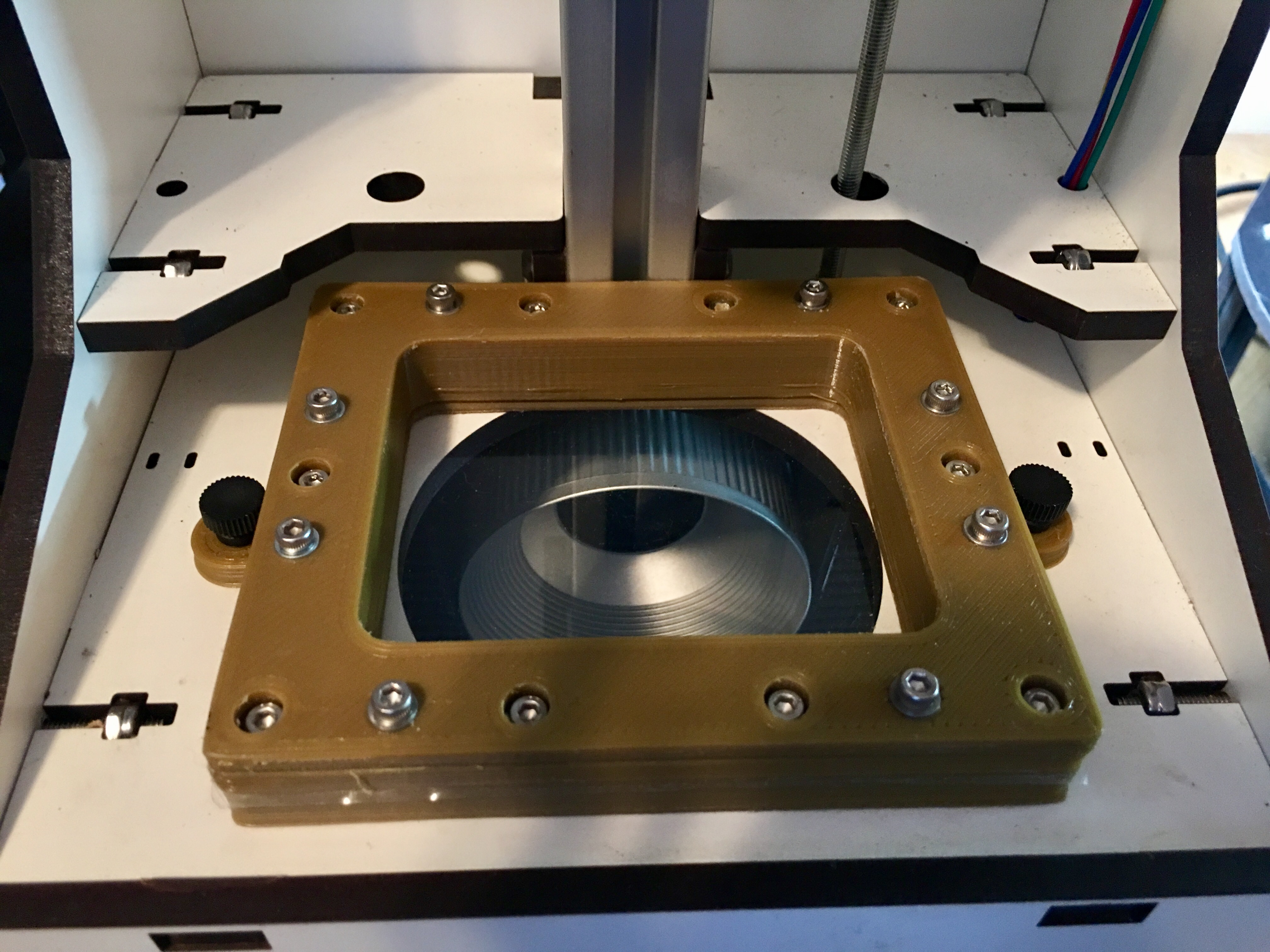

Along with the above, I needed to do something about a new vat. I had started to build a flex vat 18 months ago with a new built in leveling build plate. I finished that off today. Here's the new 3 part flex vat with .005" FEP film. Custom made to fit the DropLit V1 beta I have. I can cut the base plate to rectangular to reclaim the extra print surface too.
I am now 257 layers into a 425 layer print but I have not opened the door to look inside. I have an intermittent issue that might be static related that causes the Pi to stop communicating with the printer and projector and I don't want to risk messing it up. I need to permanently mount the Pi as it is just laying on the desk. I did get 12" HDMI and USB cables to minimize the cable runs form it to the projector and GRBL controller.

Ha, no but thanks! I think we have it sorted. The nanoDLP slicer was generating WAAAY too many slices. 425 slices at .1um. That is 42.5mm tall. And guess what, that's how tall the part came out. I resliced and now it is only 128 layers. Which is right where it should be.
Lessons learned with nanoDLP:
1) don't trust the slice after changing anything in the Printer Profile. For some reason, it doesn't pick up the new parameters and there is apparently no way to force re slicing, you have to re upload your model and reslice.
2) prepare the projector manually first and have it project a black slide. Otherwise, the projector's logo (at least with my Acer) burns in on the first few layers
I would still like to figure out how to automate the projector startup and shutdown. When this print was complete, I do have ending gcode to lift the part from the vat. But I was attending a wake tonight so that happened while I was away. When I came home the toad was fine but I now have "Acer" and "HDMI detected" plastic burned in my vat!
