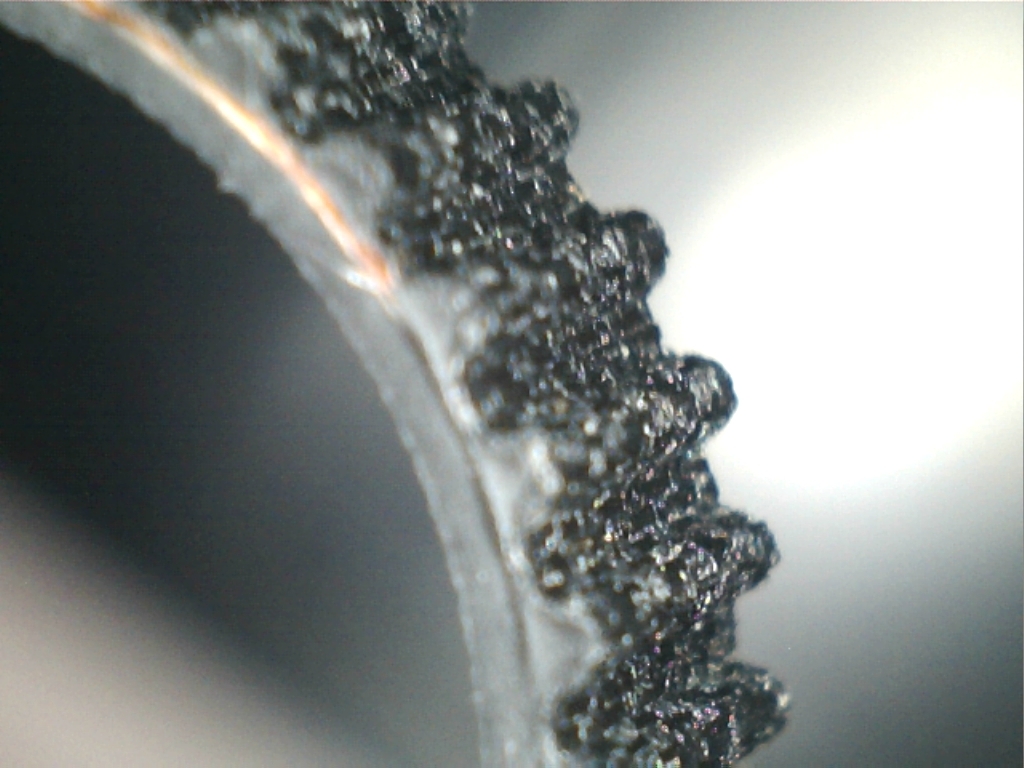

Ive been trying to track down another issue, my infills aren't comming out like they should. I've checked the rostock arms and sanded. They all move freely with little resistance. I printed a 4th calibration cube today and still having issues.
could this be caused by tower misalignment? ALSO, seems like the bottom layers infill go right to the edge, at the end of the print i get this.

When you checked your arms did you have each joint fully assembled? How much the screw are tightened make a huge impact on friction of the joint. I personally worked a single end of each arm completely before moving to the next. My measure of a good joint was when an arm was connected only at one end it would hang straight down under gravity for both vertical and side to side motions. I tested this way for all 12 joints. I put the arm in the various positions at different heights to check if there was friction at any orientation of the angle.
Looking at your print it does look like there is still friction.
To be thorough did you also calibrate your extruder based on the sticky that polygonhell wrote? Has some impact on fill completion but based on other posts and experience a majority of your gaps appear to be from friction.

The 20x20x10 cube looks good, but from the other cube you have some backlash somewhere, it could be in the arm joints and it could be in the belts.
Check the belts the most likely damage is going to be at the stepper when the head is near 0. That's on the inside of the tower about 1/3 of the way up when homed.
Be careful not to go too tight with the belts, you can break the internal fibers at which point they are just very springy and introduce additional backlash. I did this trying to chase an issue where one of my belts was damaged in a head crash, initially I had a small amount of backlash introduced by the damaged belt, which I made considerably worse by over tightening all the belts, ended up replacing them all.
MHackney's test print isn't a bad way to try and narrow this down, I personally print a large triangle with edges aligned with the pillars to try and determine which pillars are affected, you have to watch the infill go down and figure out which pillar is more likely responsible.

i haven't checked my belts. I need to check those I did have a head crash, because I forgot the set the eeprom heights correctly on initial calibration.
i'll check the belts today. hopefully thats the issue.
Re: Another rostock max build
Posted: Fri Mar 29, 2013 4:15 pm
by cambo3d
I took the belts off to check, there is some fraying but the teeth are still intact, i ordered another set to replace anyway.
bad section
good section
