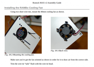

Which direction is the "correct" direction for air flow? There is an arrow on the fan for the airflow direction, but is the fan to push or pull air through the hole?
The BONE ZONE build thread.
guanu
SeeMeCNC Staff
Posts: 392
Post by guanu »
the photos are the correct way.... the fan blows air onto the rambo... label on the fan will face the rambo
Guanu
BONE
Posts: 288
Post by BONE »
Sorry, let me rephrase. I'm installing an upgraded fan that is quieter and less likely to fail (based upon general customer feedback on the forums), which direction is the correct airflow through the panel?
Posts: 5359
Point the back of the fan at the RAMBo.

Post by guanu »
Like I said..
guanu wrote:the photos are the correct way.... the fan blows air onto the rambo... label on the fan will face the rambo
Guanu
BONE
Posts: 288
Post by BONE »
Sorry guanu, had my head wrapped around the direction of the arrow and I overlooked the way you referenced it. I guess I honed in on the label reference since I'm using a fan that did not come with the kit.

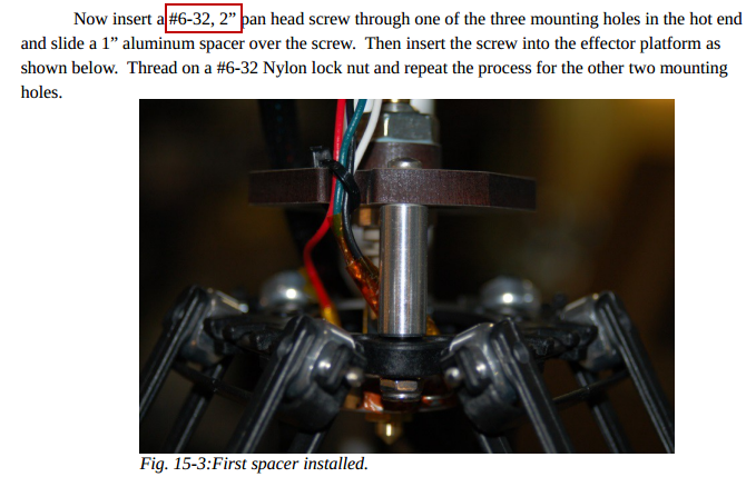

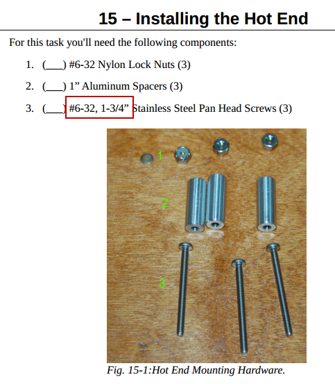

What length screw is to be used when assembling the hot end?
page 161
page 162
Kevinvandeusen
Posts: 123
Location: Cooley Springs,SC
Post by Kevinvandeusen »
Use whichever they gave you. You do not want it protruding too far out.
Brian
Posts: 121
Joined: Tue Mar 25, 2014 6:05 pm
Post by Brian »
BONE wrote:What length screw is to be used when assembling the hot end?
page 161
page 162
By the time you get to that step, there's probably only one group of screws left in your unused parts that would possibly fit in this location. There were many places in the build where you could deduce the correct screws without measuring because the manual called out some number of screws for a particular step and there were only one screw that was supplied which would fit that place.
Posts: 5359
Good catch, Brian! I'll get that fixed as soon as I can.
BONE
Posts: 288
Post by BONE »
page 161
page 162
My kit came with not enough hardware in those sizes, so SeeMeCNC sent me a bag of each. That's why I was asking and brought this discrepancy in the manual to this thread.

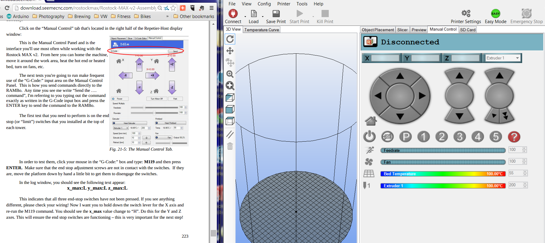

I downloaded Repetier and it does not look like the control panel in the manual. My main issue trying to find here to insert the G-code for auto tuning codes. I don't how to generate the Kp, Ki, and Kp's for controlling the ramp up and overshoot numbers for the hot end and hot bed controls. Can some one help with that? I've taken everything up to the temps in the manual, but I don't know how to tune the temps with the missing G-code box.
nitewatchman
Posts: 624
Location: Birmingham, Alabama
Post by nitewatchman »
Hey no problem!
Go up to the tool bar and toggle the EASY button from GREEN to RED. I think that the fields you are looking for will then appear under the MANUAL CONTROL tab.
nitewatchman
BONE
Posts: 288
Post by BONE »
nitewatchman wrote:Hey no problem!
nitewatchman
Yep that made the G-code appear. I'll run it tomorrow when I get home, getting alittle late and I need my beauty sleep. Some might refer to as Prime Madonna sleep around here. :P
