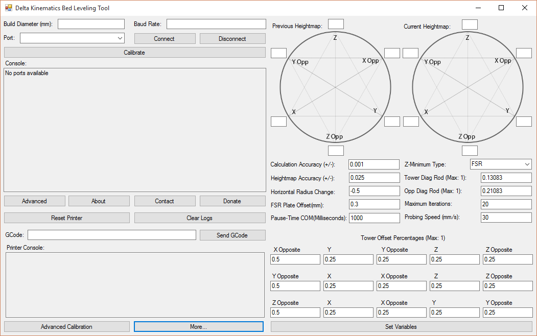

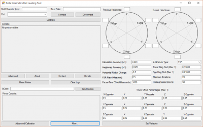

Version 2.0.1 - Advanced Calibration
This update has a lot of new features, and has not been tested...
I finished what I wanted for this update, but since I am away for a week, I am not able to test any of the features that I have implemented. These include:
-support for FSR and Z-Probe
-control over z-probe speed
-less lag/thread sleeping, now depends on how long your printer takes to communicate
-live height-map
-accuracy control
-advanced calibration to learn specifics about Your printer - similar to expert mode in V1.0.3
-maximum iterations
-control over time pausing for printer communication (sends script and waits designated time)
-FSR plate offset control (raises the print height slightly so you have a first layer)
-determine z-probe height, this requires you to set your z-height first
-and most likely other features that I have already forgotten...
I will say it again, I haven't had a chance to test this yet. However, I have gone over the new code 3 times, so it should work - i.e. finger on the kill-switch.
Also, I still have only tested this on Windows 8.1 and 10.
https://drive.google.com/file/d/0B06WCA ... sp=sharing

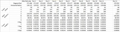

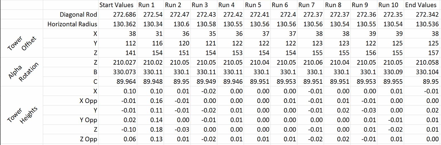

I did the expert calibration with the webpage tool's expert settings, and after 4 time through the cycle, I'm between -.01 and .01 at all 6 point for the first time (I think) ever! Awesome, tool, thank you!
- Posts: 75
- Joined: Tue Apr 14, 2015 4:27 pm
Re: Delta Automatic Calibration Tool - For Repetier Firmware
Congrats on those outstanding results!Jimustanguitar wrote:I did the expert calibration with the webpage tool's expert settings, and after 4 time through the cycle, I'm between -.01 and .01 at all 6 point for the first time (I think) ever! Awesome, tool, thank you!

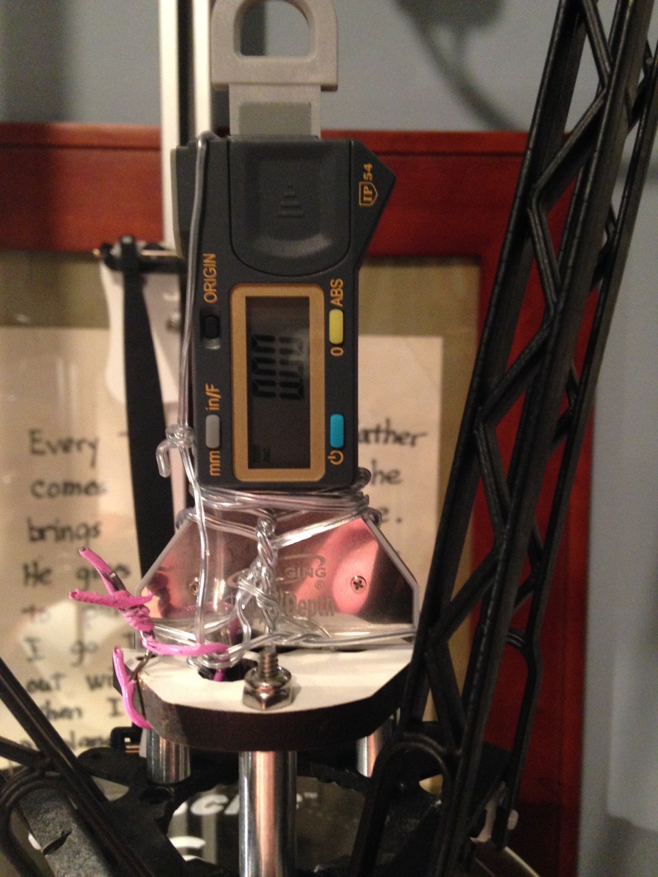

What kind of Probe did you use, and how did you attach it?
I just ordered the below Depth Probe, and have been wondering how I'm gonna mount it, when it arrives:
http://www.amazon.com/dp/B00OACN5XI/ref ... epth+gauge
Planning to take out the whole hot end and try to somehow mount this in it's place.
I'm sure a printable mount for the effector platform would be pretty simple for a person with CAD skills to make - unfortunately
I'm not one of those. If anyone out there who is likes this approach and feels like helping, hopefully the community would benefit...

I used the HTML version with a dial indicator. It's a Pittsburgh Tools digital one from Harbor Freight (same thing, different sticker http://www.harborfreight.com/1-inch-sae ... 93295.html ) mounted in the Trick Laser pen holder ( http://tricklaser.com/Pen-Tool-holder-f ... RM-PTH.htm )HumanLiberty wrote:What kind of Probe did you use, and how did you attach it?

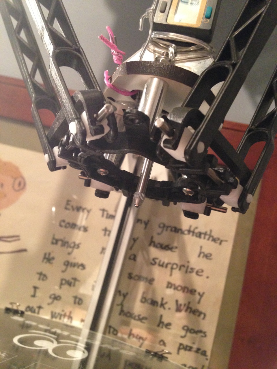

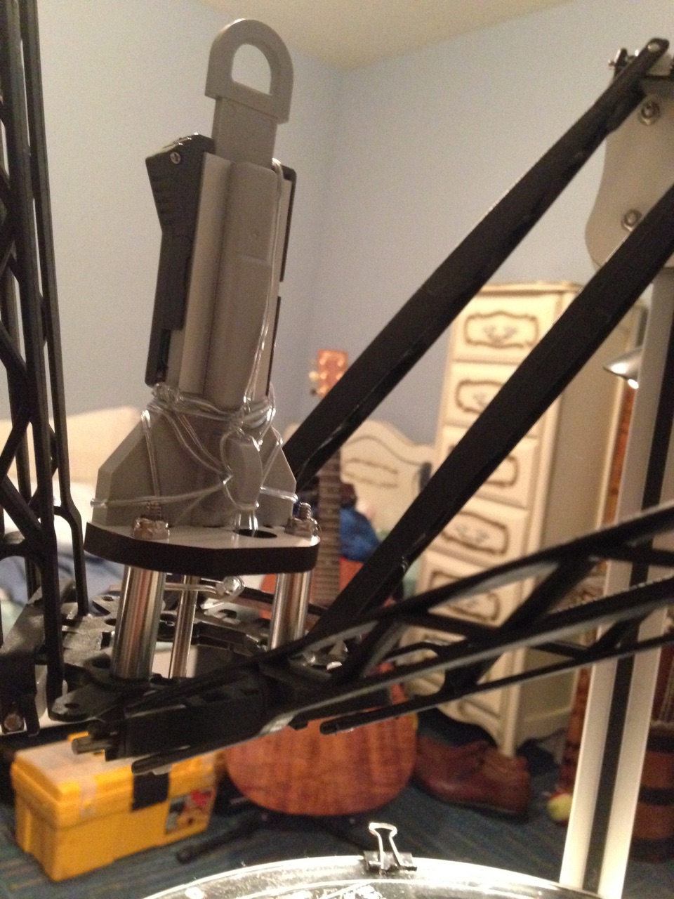

Here are pics of how I did the mount - got lucky and my son's rc truck was delivered at the same time with perfect twist ties or I don't think
I would have gotten it on... I'll let you know how it works out...
BTW - It wasn't mentioned on the Amazon spec sheet, but turns out this probe has some sort of USB output (non-standard shape) -
I'm going to find out if/how it can be used to directly load data into EEPROM for Rolly's auto-calibration; calling the company tomorrow - stay tuned...

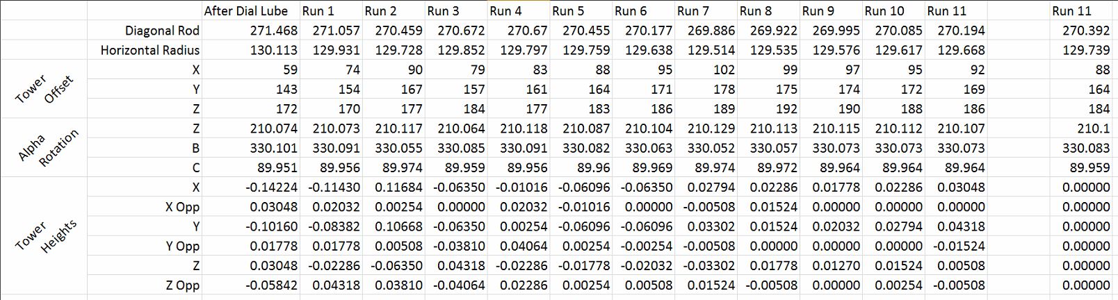

You had previously asked for what my measurements were, so here they are:
Results with the digital dial indicator (the same one that Jimustanguitar has) (units are in mm): Results with the analog dial indicator (still going with this, maybe I need to try the expert settings) (units are in mm): Do those results look reasonable to you Rollie?
I also noticed that while printing before that the corner of a larger piece didn't stick too well near the Y tower, and then warped. The rest of the print stayed flat.
Also, forgot to mention that pressing Enter Defaults is a necessity, unless you are using expert settings! But you seemed to find that, good thing... This causes an error because it will not be able to compute the XYZ/diagonal rod offset percentages (without providing the 4 height-maps or pressing enter defaults they are zero), then it will do some fun dividing/multiplying by zero, messing up the calculation, causing an infinite loop too(until it is closed), etc.HumanLiberty wrote: Thanks Rollie - turned out in my case it was due to a failure to press "Enter Defaults"
which I learned from the below post from earlier in this thread.
It also address Cyber's concerns about accuracy surviving transition from probe back to nozzle, which apparently it did, in techstorage's case:
For the "accuracy surviving transition" statement, I have also noticed a small error when calibrating with a probe/calipers that protrude beneath the nozzle. That is actually the main reason as to why I decided to upgrade to FSRs. That distance is then zero, and of course you don't have to recalibrate the z-height.

So I did the .html calibration and it looks like the results are a huge improvement - 10k x Thanks!
So here's the question:
Tricklaser's custom 325mm CF arms are en rout to me. Am I going to have to re-run all the calibrations after installing?
I'd imagine so, and if so, will wait for them before swapping the probe out for the hot end.
I suppose I'll have to change the Diagonal Rod Length starting point to 325 in EEPROM...?
Thanks all!
Yes, I'd run the calibrations again. I'd set everything back to stock, change the arm length accordingly, and see where you're starting from.
