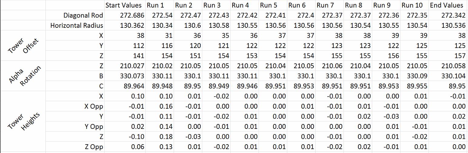

You had previously asked for what my measurements were, so here they are:
Results with the digital dial indicator (the same one that Jimustanguitar has) (units are in mm):
Results with the analog dial indicator (still going with this, maybe I need to try the expert settings) (units are in mm):
Do those results look reasonable to you Rollie?
I also noticed that while printing before that the corner of a larger piece didn't stick too well near the Y tower, and then warped. The rest of the print stayed flat.
Yes, these do look reasonable, although it seems your frame is a bit warped. This won't necessarily be a problem, but it will affect XY scaling of printed parts. You shouldn't see anything more than 0.25 to 0.75 mm change over the whole size of your build plate, from what I see. This issue can be countered with modifying the Delta Radii, but at the moment there isn't an efficient way to do so. I am looking into a fix for this though.(Or rebuilding your frame to make it square.)
