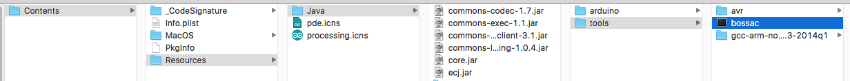

I just finished setting up my Duet using Arduino version 1.6.1 on OSX from https://www.arduino.cc/en/Main/OldSoftwareReleases and it turns out the file in that version is at3D-Print wrote:Interesting that the "Java/......" Folder and subfolder is not present on my computer. Not sure if this is why I was having in consistent problems.IMBoring25 wrote:I'm not sure what arguments and/or permissions that shell script might need. The instructions I've been using to flash mine came from the RepRapPro site, where they call bossac directly, the Mac command being:
The arguments are -e[rase], -w[rite], -v[erify], -b[oot] and the path to the firmware image you want to flash.Code: Select all
/Applications/Arduino.app/Contents/Resources/Java/hardware/tools/bossac -e -w -v -b RepRapFirmware-XXX-DD-MM-YYYY.bin
Code: Select all
/Applications/Arduino.app/Contents/Java/hardware/tools/bossacAlso, make sure you have 1.6.1 - newer versions don't have bossac at all.
Figured this might be helpful to someone down the line.

@lordgort: not sure why you don't see the Resources folder in the path. Here is a screenshot of the path from a fresh download of Arduino:
