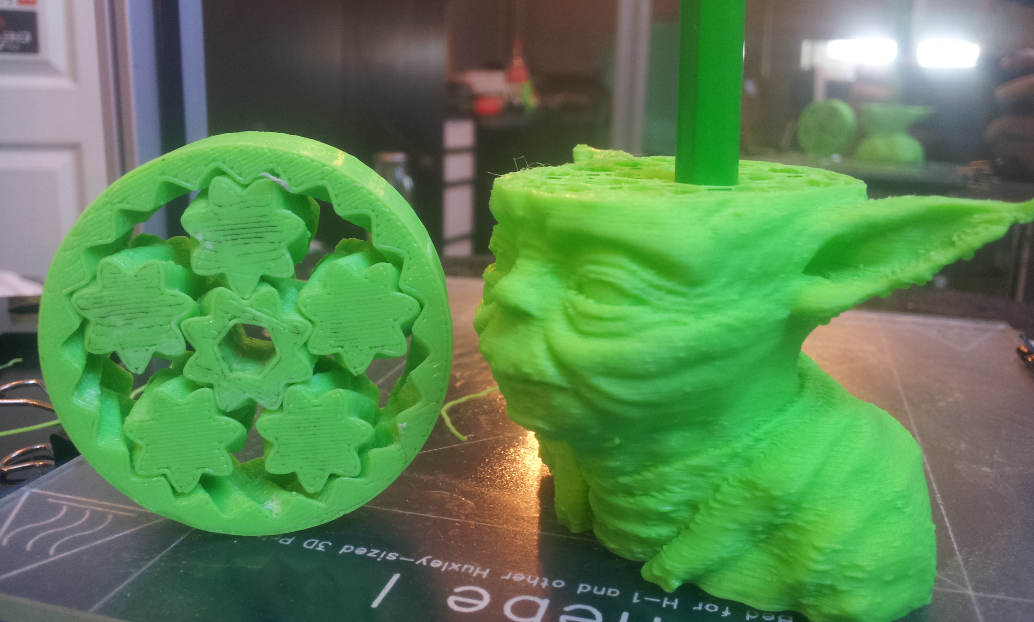

Here's the gear bearing I just finished. This is the first time I've been able to print one that actually works (and well!). That's primarily thanks to KISS since it had a logical print path and I didn't need to use retract to minimize blobing. I have a little more work to do to reduce the little stringing this part has. But, it broke free and rotated right off the plate.

mhackney wrote:Here's the gear bearing I just finished. This is the first time I've been able to print one that actually works (and well!). That's primarily thanks to KISS since it had a logical print path and I didn't need to use retract to minimize blobing. I have a little more work to do to reduce the little stringing this part has. But, it broke free and rotated right off the plate.
[img]http://mhackney.zenfolio.com/img/s3/v41 ... 9506-3.jpg[/img]
Can you post your settings of KISS you used to print that part, I want make a comparison. Please.

hmmm, I think I'm missing something, I used your settings, But I changed my starting G-Code to
g28;
M140 S<BEDTEMP>
M190 S<BEDTEMP>
yours:
T<EXT+0>
M104 S<TEMP>
M190 S<BEDTEMP>
M109 S<TEMP>
I'm starting printing laying great 1st layer, and after that machine stops completly. On the LCD status is saying IDLE. Nothing in repetier host. Any clues? I'm using repetier firmware
EDIT:
I think I find an answer since I'm printing first layer on 230C and other layers on 222, machine after 1st layer is trying to wait for nozzle cooldown. In KISS i should change temp g code from m109 ( Set Extruder Temperature and Wait) to m104 ( Set Extruder Temperature). Learning everyday. :)

I know. I corrected my GCode You give me great starting point for kisslicer, finally I was able of printing something more complex than calibration cube. I forget to change my ABS settings,so there is too much plastic. But when its finished I put it on hex wrench, and turn it and its WORKING, IN FIRST TRY.After that I want to print Yoda and after 3 hours of printing it STOPS on layer 241. No errors in host, neither in GCode.I stopped print in host,and try to home the machine, but no response.I have to reconnect the machine and then home it.now I have cool looking desk pen holder. ;)
Again thanks for great starting point in kisslicer.

Looking good! That problem you describe sounds suspiciously similar to the problem Highcooley discovered. A bug has been filed with Repetier. It seems that communication stops for some reason. Here is the bug report and discussion: https://github.com/repetier/Repetier-Firmware/issues/72
Looks like Yoda is having open brain surgery!

I know. I corrected my GCode You give me great starting point for kisslicer, finally I was able of printing Spongebob more complex than calibration cube. Iforget to change my ABS settings,so there is too much plastic. But when its finished I put it on hex wrench, and turn it and its WORKING, IN FIRST TRY.After that I want to print Yoda and after 3 hours of printing it STOPS on layer 241. No errors in host, neither in GCode.I stopped print in host,and try to home the machine, but no response.I have to reconnect the machine and then home it.now I have cool looking desk pen holder. ;)
Now that's a darn nice pen holder!
