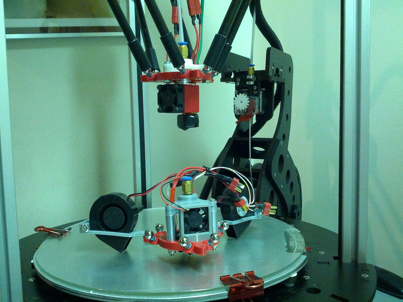

One of the things I like most about the magnetic arms is the speed with which you can disasemble the platform with the hotend. I printed up a second platform and have the E3d set up for ABS and nylon, and the other head (makergear style, from the guy that makes the screw-in thermistor) for PLA. With the Dean's plugs, I can swap them out in hardly more time than it takes to swap the filament, then just change the Z-max length and PID and I'm back in business. With micro Dean's, it would be even faster.

Broose wrote:I can swap them out in hardly more time than it takes to swap the filament, then just change the Z-max length and PID and I'm back in business.
With some careful shimming, you might be able to keep the same Z axis length with both heads.
Broose wrote:One of the things I like most about the magnetic arms is the speed with which you can disasemble the platform with the hotend. I printed up a second platform and have the E3d set up for ABS and nylon, and the other head (makergear style, from the guy that makes the screw-in thermistor) for PLA. With the Dean's plugs, I can swap them out in hardly more time than it takes to swap the filament, then just change the Z-max length and PID and I'm back in business. With micro Dean's, it would be even faster.
Very nice picture!
Are those the original Xnaron effectors, they look different somehow.
Those effectors look familiar to me... actually nicer than the one I printed.
I have to agree my favorite thing about the magarms is how easy it is to take off them off.
Broose
Posts: 227
Location: NH, USA
Post by Broose »
Eaglezsoar wrote:Very nice picture!
Props to Barnett for the effectors and Xnaron for everything else
http://forum.seemecnc.com/viewtopic.php ... rms#p13340
http://forum.seemecnc.com/viewtopic.php ... rms#p13340[/quote]
Which slicer did you use to print the effectors? They look great! Are they ABS?

Eaglezsoar wrote:Which slicer did you use to print the effectors? They look great! Are they ABS?
I used Kisslicer and they are ABS. Of course, having the Xnaron mag arms helped with the print quality.
I noticed that the hotend you are using for the PLA has no slots in the Peek to aid in cooling, is that a problem for you?
I just went to his website and it does show there are no slots.
Is that a custom fan mount you have on the PLA head?

Eaglezsoar wrote:I noticed that the hotend you are using for the PLA has no slots in the Peek to aid in cooling, is that a problem for you?
It seems to work fine for PLA with the fan. Yes, I made a little box to hold a 25mm fan next to the Peek.
