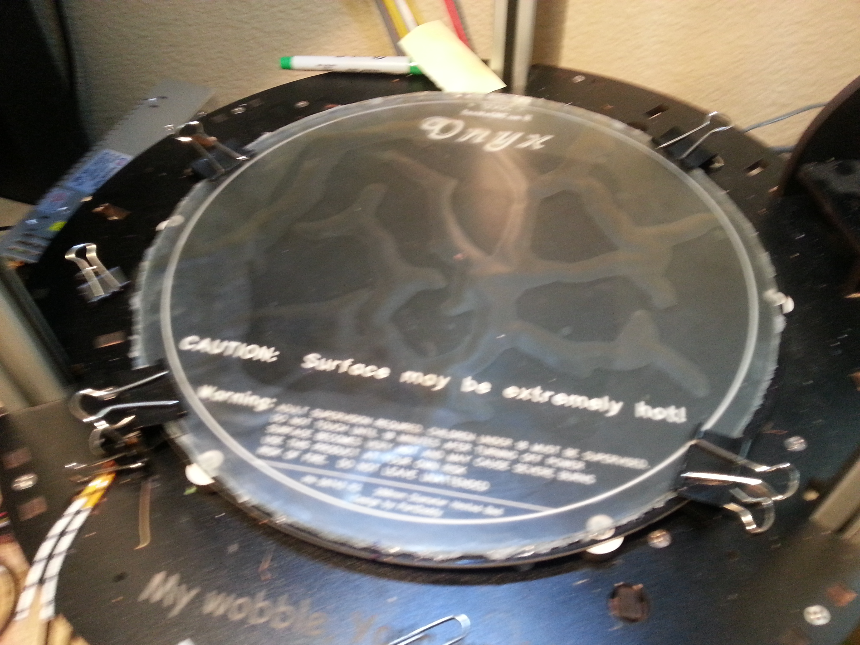

Re: PEI print bed surface experiments
PEI - Failure on the 2nd Day. (Shiny side down)
Today, I turned on bed heating, went away to grab a cuppa and here's what I came back to.
Don't use 100% silicone. It won't last more than a day.
[Edit: And it will take at least an hour to scrape off the silicone from the glass. Caution: Remove the PEI in a ventiliated area. Phew!!!]
Now, I'm going for a different mod I think. Haven't seen it but who cares...
I'm going to get a round piece of 1/8 aluminum cut into the round the same size as the heated bed.
It will have a square cut out of some size. Probably something like 270 x 270.
I'll cut some boro glass the same size of the square and apply the PEI with the sticky back.
I might even figure out some kind of easy removal mech. for the glass.
The general idea is that the glass would not slide around and be easily removed after a print. I don't see how the glass might need to be held down if it fits into the square fairly tightly - even if it needs to be wedged with something a bit.
Using a square - it's easier to apply the adhesive-backed PEI (which I still have lots of).
Anything wrong with this idea?
(told you so!) J/K - great "fail" photo though you can really see the separation.
I am not sure why you are cutting a square hole and using square glass. There is no magic here, just adhere the PEI to an aluminum disk. You can clip this to your Onyx with binder clips. It actually would be best to adhere the PEI directly to thermally conductive Al rather than borosilicate. I just did the borosilicate since I already have an aluminum heat dissipator that is already permanently attached (screwed down). By putting it on the glass, I can flip the glass over and print on a glass surface.
Also, your PEI looks very clear. Most of the PEI I've seen is an amber color.

I was hoping his would last at least a few weeks but a fail in a day! I couldn't resist!

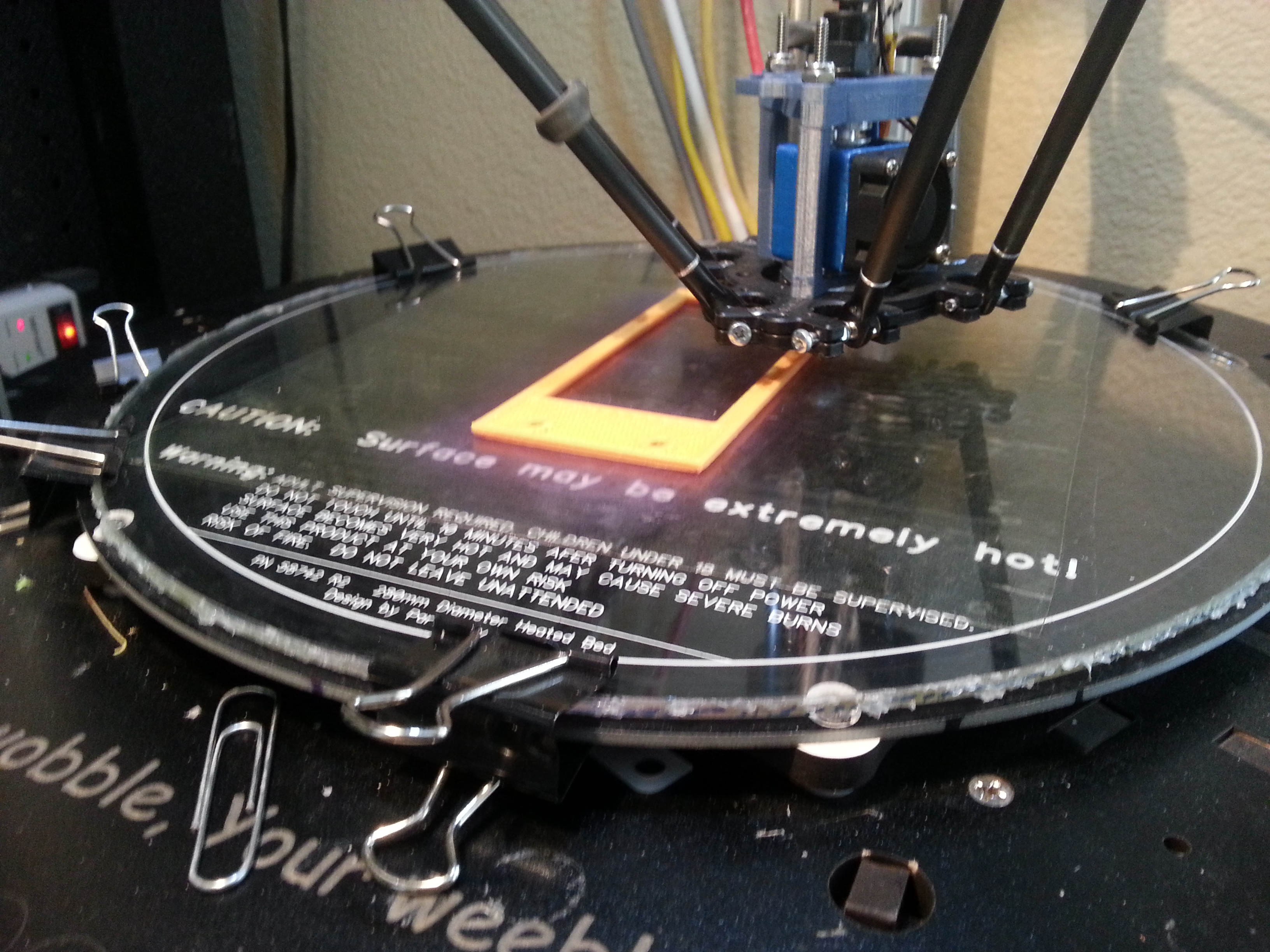

Adhesive-backed PEI trial.
I am printing JetPad's Top Mounted Ezstruder Holder Thingy.
First Print:
Glue Stick
70 C, .25 First Layer, .3 after
I got edge bad enough to stop the print. Mainly aesthetic curl, not structural.
Second Print:
85 C
Same settings.
I have about .5mm edge curl on one corner but not enough to stop the print.
I'll hang with this and see how long it lasts. Unless I want to really exact retribution on someone who parks really poorly, I don't have a good use for the other two sheets of adhesive-backed PEI...
I'm confused - why are you using glue stick on PEI? You should be able to print directly to the PEI with nothing else and get fantastic stick and no curl. Are you printing ABS? If not, 85°C is too hot for the bed for PLA. I run 55° for PLA and 70° for ABS. Printing on hotter beds makes it very difficult to remove the part.
I didn't have good adhesion at 70 with ABS.
I put glue stick on at 70 and had better adhesion.
I turned up the heat to 85 and had even better adhesion - but not perfect adhesion.
