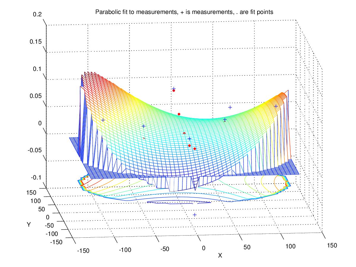

626Pilot

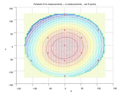

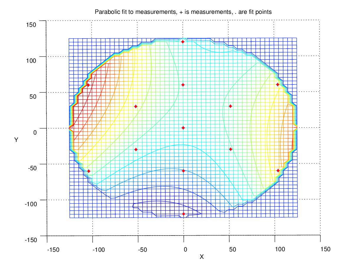

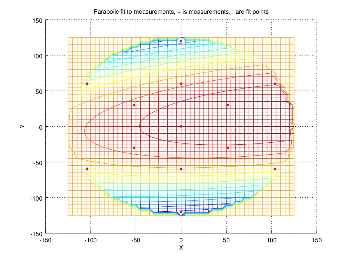

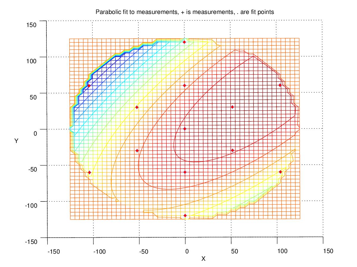

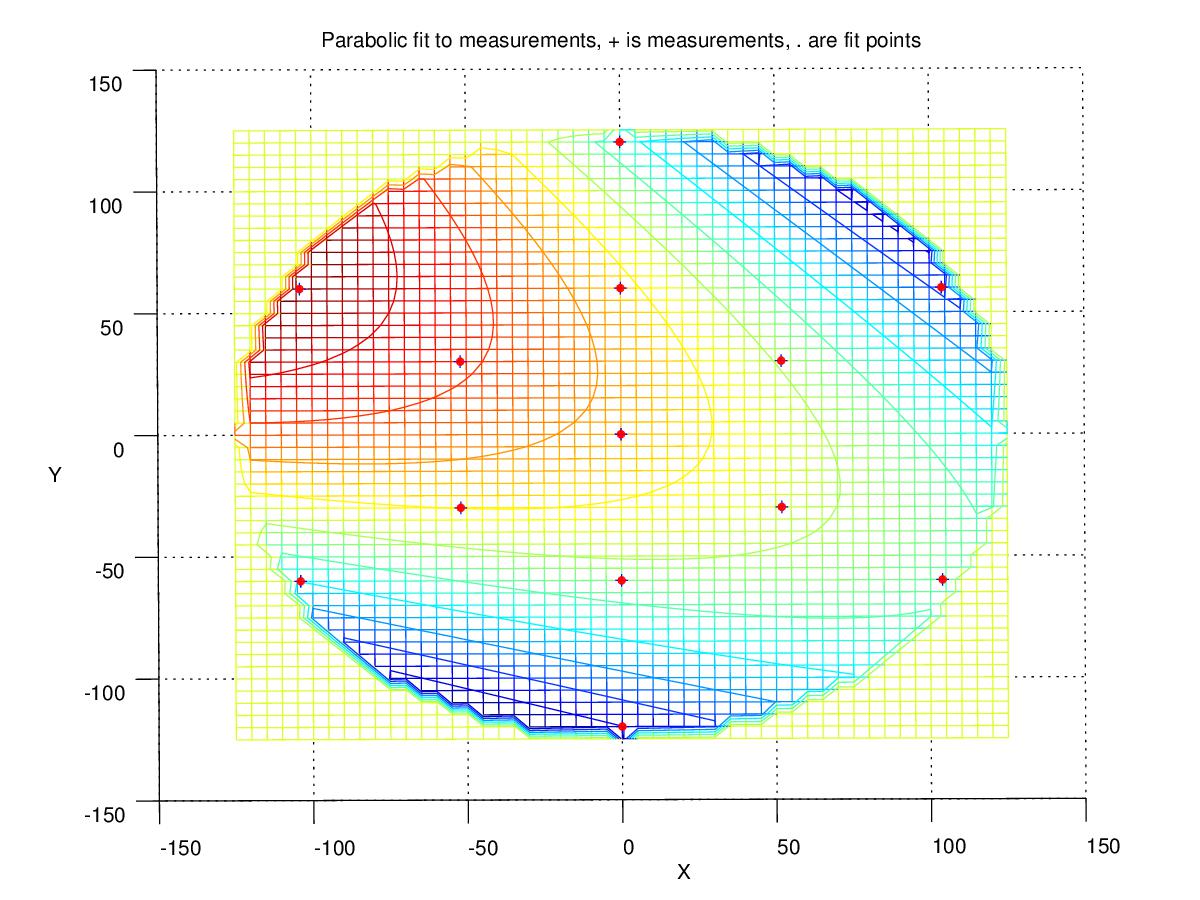

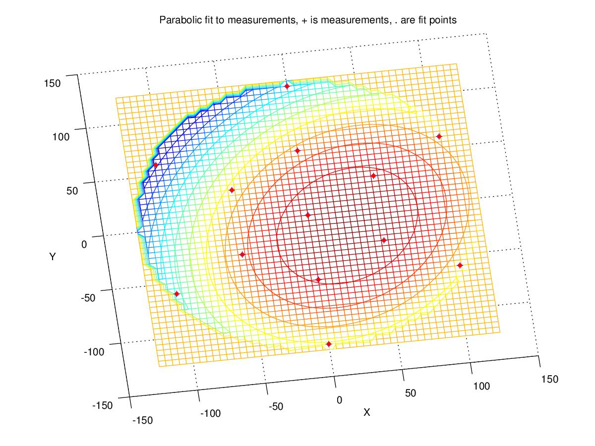

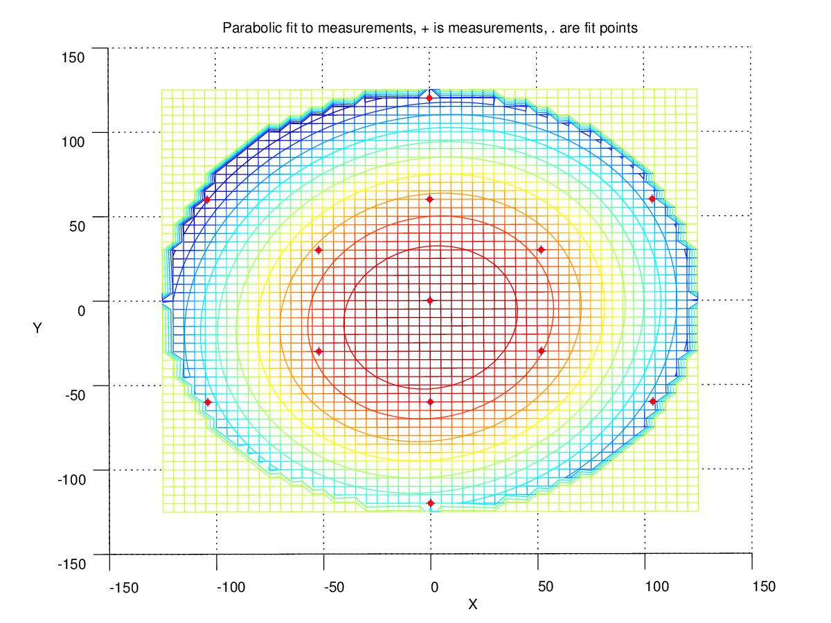

Anyone using a Smoothieboard or an Azteeg X5: My experimental branch of Smoothieware
So far, I have implemented two commands. G29 does a repeatability test on your Z-probe. Arguments are S (number of samples, default 10) and E (skip the eccentricity test - saves time but may be less accurate). G31 doesn't do much yet other than probe some test points and report their depths. When it's done, if my assumptions are correct, it will be able to figure out the best combination of individual tower radius, rotation (position along the printer's radius) and arm length. If that isn't enough, I suppose I'll have to implement a height map. One way or another, this damn thing is going to print what I tell it to print, at the layer height I tell it to print it at. :)
Here's what a repeatability test looks like using my custom Z-probe:

I just replaced the hotend with microswitch that sat in the same holder.
What I want to avoid is implementing a least squares fit function for paraboloids on any of the firmwares, although smoothie would be my first choice if I were to do it there.
All I need are the Z-Height of 13 points on the bed to perform good enough fit, which I could get away with as long as the firmwares supported the necessary gcodes. Then I could leave it up to the user to format the corrections into the proper gcode format for that firmware. Leaving all the heavy coding (and computing) off of the controllers.
Now I'll give a brief rundown of my logic since it worked for me. Disclamer: All assumptions are based on my personal experience and may not reflect reality.
When I graph the result, it's easy to visually identify the next variable to adjust, which is where the heuristic comes in. Typically the weird Z0 behavior is due to the tower geometry changing an elliptic paraboloid which is what we expect (ie near perfect builds) into a hyperbolic paraboloid (those of us in the weird Z0 group). I also want to note that whenever we do not have a true elliptical paraboloid for our 'level' movement, we will get differences (stretching) in the X/Y on prints.
With the proper firmware offsets we can correct this difference and push it back toward an elliptic paraboloid where it is easier to improve the Z0 height behavior. I've found adjusting tower radius position is the most effective adjustment in manipulating the movement back into an elliptical form. After that adjusting the tower distances from the "center" manipulates the movement to place the min/max point to the center. Once you have an elliptical paraboloid for the Z0 heights with it's center matching the [0,0,0], it's the standard endstop and print radius adjustments.
tl;dr;
The goal is to turn bed profiles like this(hyperbolic paraboloid) :
Into this:
Where the standard bed leveling works out nicely.

Interesting, looks like we chose all the same test points for the general surface map. I have 13 of them and they're all in the same places!
I also devised a test, using different test points, called Y-line, where I draw a line from the Y-tower passing through the print center to the other side of the bed, and chop it up into an arbitrary number of segments. I then have the probe walk that line, probing each segment's endpoint. I also probe two points 10mm away from the line and perpendicular to it, based on the theory that the X tower will have more influence on the point to the left, and the Z tower will have more influence on the point to the right. It looks like this, with the probe touching where the dots are:
Code: Select all
(towards center)
                      ./\    .     (closer to Z)
(closer to X)            \./
                             ./  (Y tower)
Sure enough, the probing revealed some "saddling" behavior. The point on the Y-line would always be at a different elevation than the point closer to the X tower, and they would both be at a different elevation than the point closer to the Z tower. The data was definitely defining individual parabolic curves! The depths would start high or low, get better close to the center, and then go back to being high or low as it approached the opposite side of the print surface.
For the first test, I tried a simple gradient descent ((origin depth - point's depth) * factor) coupled with some logic to change the arm length. I found that this could be useful in correcting very small positioning errors, on the order of 1/4 mm or so, but in order to correct a deviation of 0.8mm, the logic had to crank up one of the arm lengths by 4mm! Further increases had diminishing returns, and I don't think anyone's arms are THAT far apart in length. So, the next things I will look at are tower angle (which I had much better results with before) and tower radius.
I would like to set up some heuristics that try various adjustments and pick the best ones. This worked well with my tower angle code. It would perform dozens of combinatorics, i.e. {x, y, z}, {x+1, y, z}, {x-1, y, z}, {x, y+1, z}, {x, y-1, z}, {x+1, y+1, z}, {x+1, y-1, z}, etc. I think I'd try tower angle and delta radius first (since they're likely to produce bigger changes) and then arm length to see if any further improvements can be wrung out.
That should give us the best possible corrections to the printer's notion of its physical geometry. That is the first thing to shoot for because it corrects positioning errors on all three axes. If the bed is still too "rough" after that, the surface can be depth-mapped and that can be used to correct for Z, although X and Y probably won't be helped. Smoothie has something called a "compensation transform" (see src/modules/robot/Robot.cpp) that appears to have been designed for that exact purpose.

When I did it manually I would do an endstop and delta radius before I'd process the 13 test points. There were times I would have missed the transformation into an elliptical paraboloid if I didn't. My process took a long time because I'd do the endstop and delta radius adjustments often, and I also didn't try to optimize those functions since I knew it'd converge after a few iterations eventually. I know I can put the paraboloid center somewhere off the printable area and have it stretched to where the test points return relatively close values. To me, this is a false positive calibration. It may be good enough to print with, but it isn't the optimal solution and slight changes to the printer's physical arrangement changes the leveling more than one would expect. This is a scenario I think leaves a person scratching their head as to what changed to throw everything off so much when it was 'calibrated' just a moment ago.
I gotta find my notes since I recorded the parameter changes each time with the graphs I made.
My methods didn't work without plotting results with curve fitting. The curve fitting covers up variables I don't want to deal with (other than errors introduced by movement consistency) and exaggerated the parts I was looking for, which is mainly where the center of the paraboloid would be and what towers to squish it back into a symmetrical shape.
With a focus on adjusting radial position: I only adjusted one tower at a time, when there were adjustments that needed two towers to be adjusted, things looked worse for a couple iterations.
For tower radial position, without checking my code, I believe I used the point opposite the tower, and then the nearest two perimeter points, adjusting the tower radial position until those three points were within a set variance. I'll go through and document better how I did things, I just gotta find my notes.
Still, I think when I went through this I roughly captured most of the odd bed leveling forms.
This is what I started with
Center point is further right than any of the towers
Gut feeling says move the top tower left a little.
The way I interpret this, the top and right tower need to both move radially toward each other.
