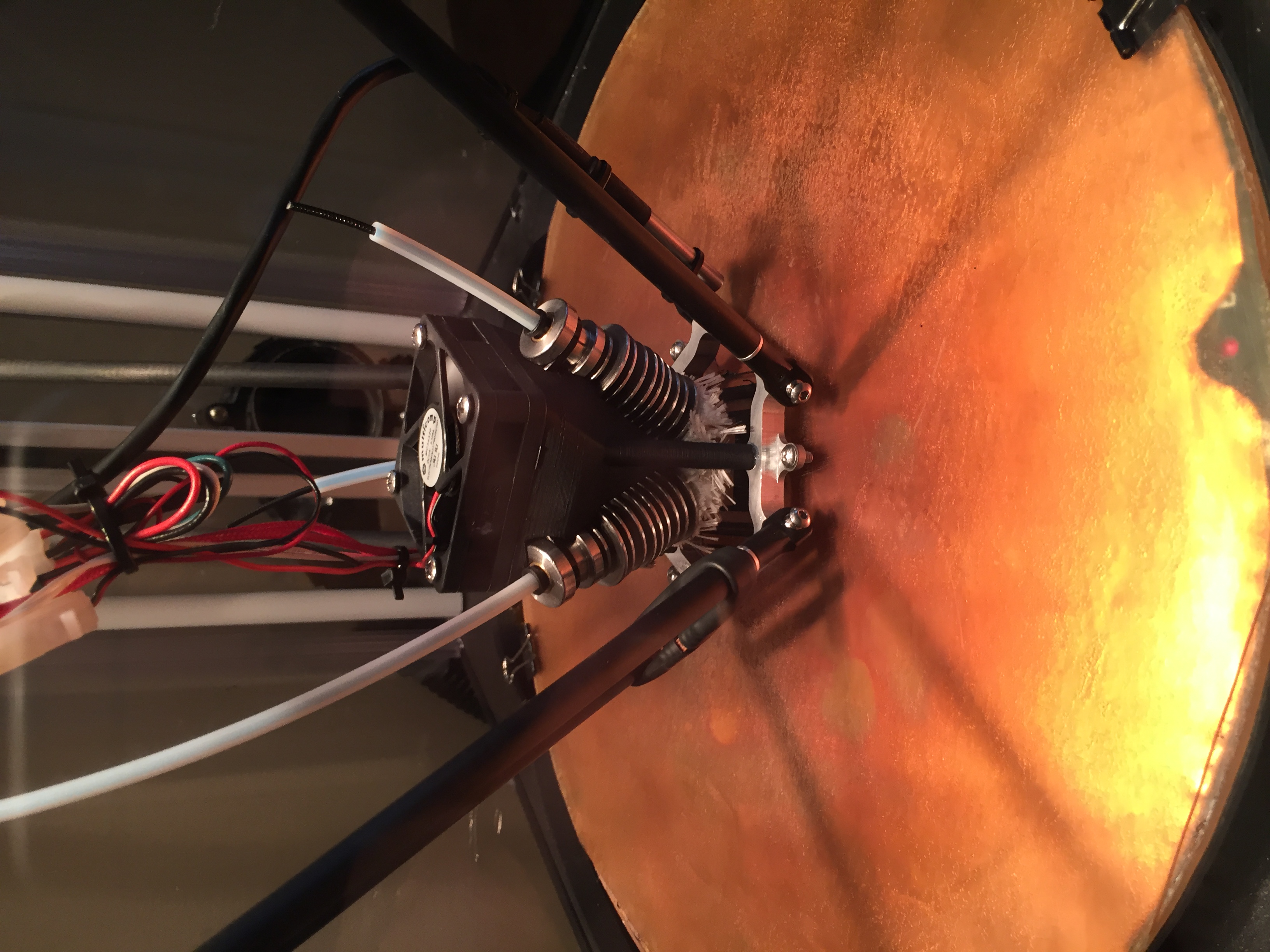

Re: Duet setup - instructions in progress
Ok, I'm going crazy. I have everything working except the motors. Everything on my Max ver2 is stock except for the E3D Chimera hot ends. I have the Kysan motors( actually they're the Animation Technology motors, they use the same settings as the Kysan on the Rambo). Duet 8.5 d42-14 firmware. I also tried the d42-13 release. All of the thermistors work, the hot ends work, and the end stops work. I also have an IR probe which works but I disconnected and commented them out for trouble shooting. When I connected the warning saying A,B,C needs to be Homed. When I push the home button nothing happens but I can trigger the end stop switches with my fingers and the machine thinks it's homed. Neither extruder works, even after the hotend is to temperature. Here is the last configuration I tried. Thanks in advance for any help.
