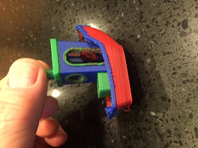

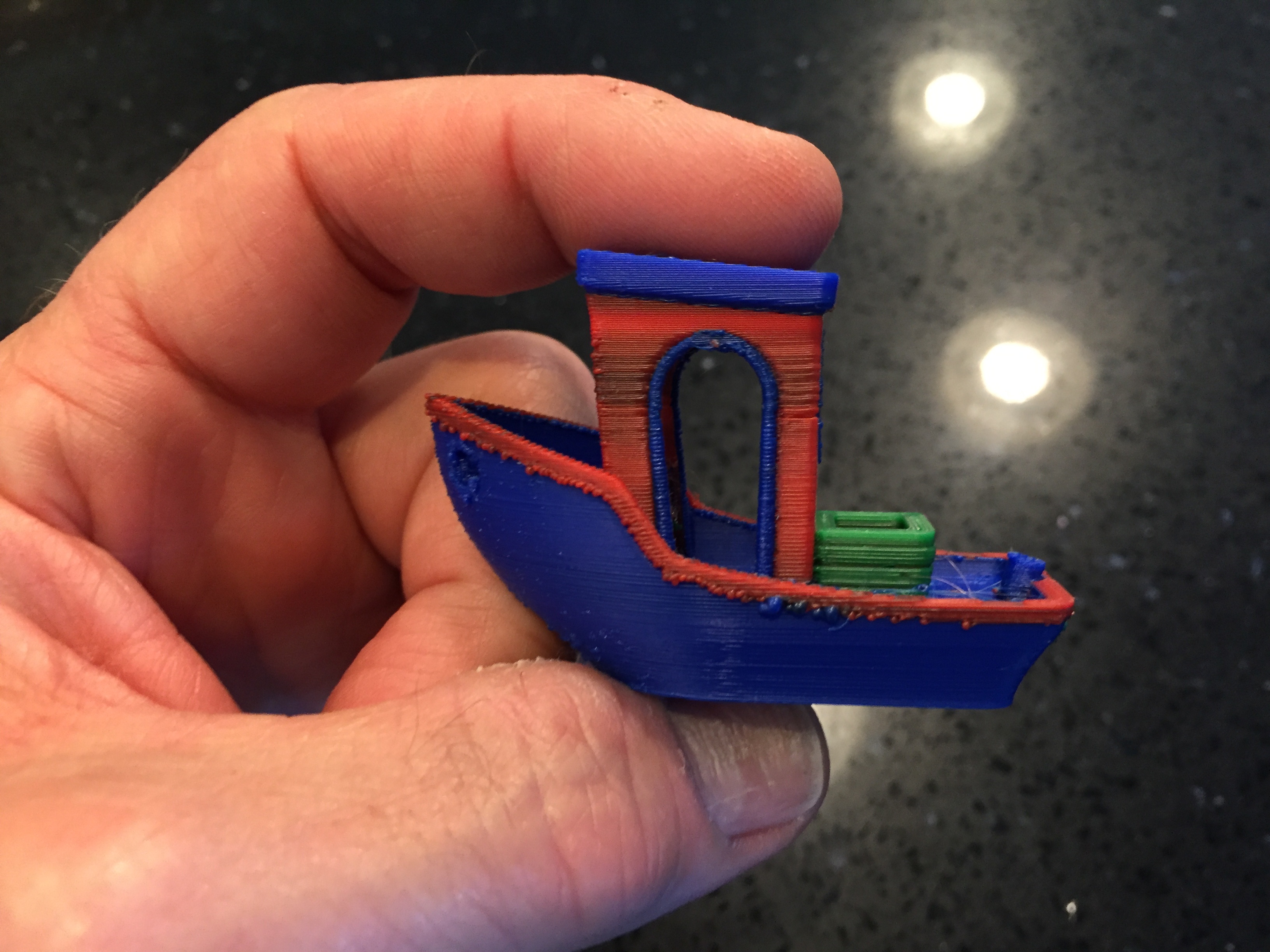

You can see that there is a bit of residual filament (ABS) that mixes. It is closer but I'm not happy yet with the print.  I really need the prime tower to be 2-3 layers thick vs a single layer to clear the diamond print head of the prior color!
The other problem I have with KISSlicer is that I have not figured out how to move and strategically place the towers. I can't reposition them at all on the bed. I have better results when I pick the right color for the right tower but still is not there yet.
This "boat" print is not very forgiving (pending how you pick the colors for the different STL mesh pieces). It has been clearly much harder to accurately print than the "Dragon and Heart." I have now easily printed 6-7 of the Dragon's for kids and friends.
As you can see at the top of the hull I am still over extruding. I have been using filament that I have on the shelf. For this series of prints (everything in this thread) I have used ABS - HatchBox blue and green and SeeMeCNC Red. HotEnd at 210. I have ordered some transparent PLA from RepRap. Maybe this is part of the problem....... We will see.

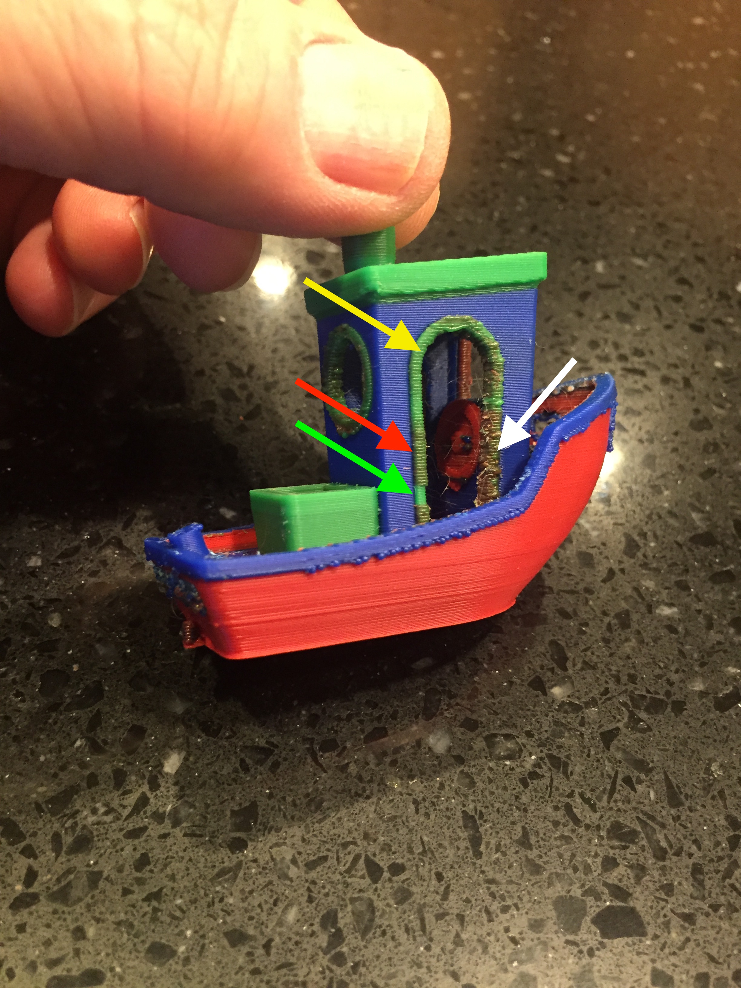

So after staring at the boat print with a beer in hand (maybe that was the trick.....  the beer), I realized that I'm not really over extruding.
If you look at the green arrow you can see that at this specific part, extrusion of the door trim is really quite good without any over extrusion. However, if you look directly above this green (red arrow), it is clearly mixing with red and looks like it is over extruding. This tells me that I need more retraction when I change out the tool since the red ABS in this case is oozing in addition to green being actively extruded. If I can avoid this ooze when I change to the new tool (green ABS) I expect this will improve. Even more notable is the marked "overextrusion" or "over oozing" as evidence by the white arrow. The yellow arrow is not bad, but not as good as the green arrow.
I suspect that the variable amount of "over-oozing" as identified by the different arrows is a reflection of the timing post-tool/color change. For example, I suspect that the white arrow is at a position immediately after a tool change, followed by the the red, yellow and then green where the red had stopped oozing. Now at this point of the beer I'm just guessing!!!
The good part of the KISSlicer is that I and sent a g-code with each exiting extruder/tool. Thus, I should be able to retract a few more mm with a tool change and not mess up movement retraction...... Maybe prevent this oozing problem and some of the stringing you can see.

I checked the g.code of the print (copied below) and you can see that here is no retraction when there is a tool/color change (Noted by the T1 command.  Tonight I will reprint and suspect this will resolve most of the problems.   Once retraction with a tool changes is working, the priming tower with one wall may be enough!!!!
You can see the retractions which KISSlicer calls "Destring Suck" and is the "G1 E-8.5 F900" command after a move (the extruder retracts 8.5 mm as defined by "E-8.5"). However, there is no retraction with the tool change. Thus, the old color will continue to ooze after being retired while the new tool/color is being primed (which also did not have a retract when it was retired)..... thus a ton of filament with each tool change.

After looking at this g.code again I do think that the noted retraction is appropriate.   This because the next movements do not extrude.
I will still insert an additional retraction with a tool change and see what happens.

I added a 6mm retraction with each tool change which is better.   However, not sure why yet (need to look at the g-code) but my green retracted back and unloaded....   thus the smoke stack did not print!!!??

A couple of suggestions:
1 You can do retractions and reprimes in the tool change files if you want, as long as you allow for getting a reprime at the start of the print.
2. To prevent oozing, make sure that the nozzle standby temperature is low enough. For PLA printing I use 150C standby temperature. In your tool change files, in the M116 command to wait for temperature, use a parameter to specify that you only want to wait for the new nozzle to heat up, not for the old one to cool down as well. But maybe you are doing all of this already.
