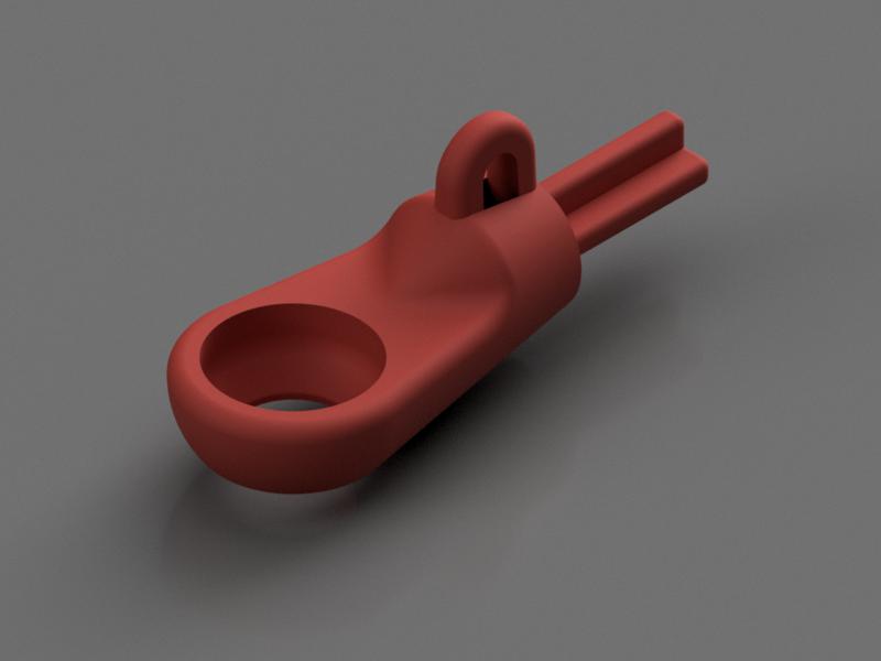

Here is a render of the final rod ends we are having an injection mold made for.
Hope to have first run of parts in hand in about 3 weeks. :D

Our V3 came in today and we are milling the first prototype adaptor ring tonight. By the end of the week we should have them in production if all goes well and shortly thereafter also a solution for the stock V2 hotend folks (if any are left out there) to work with our mounts and effectors. We will also shortly have a full metal effector/mount for the HE280 hot ends as there are a number of reports that a metal effector tends to flex less and give better calibrations.
The new adaptor is full metal and of course can be anodized to any of the colors we offer. It offers a firm mounting for the HE280 calibration board and we are hoping to keep the price in the $5-8 range. It will of course be an option when buying one of our kits just as all our lock rings are currently.
