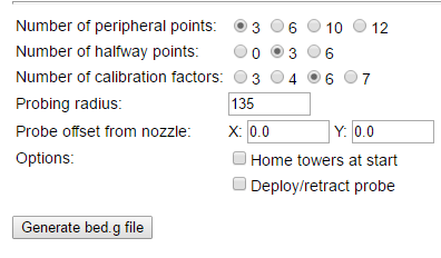

Also, on my V3 I found that if I decreased the probing radius a bit I get much nicer calibration. I observed several early probes (with the original probe diameter) that the effector actually tilted a bit near my X tower. The results were basically the same as what I see for your Z tower. You can use David Crocker's bed file generator to generate the points automatically: http://escher3d.com/pages/wizards/wizardbed.php
Set number of peripheral points and halfway points to 3 and pick the probing radius you want. I used 135mm:
-116.910 Z-probe X1
-67.500 Z-probe Y1
116.910 Z-probe X2
-67.500 Z-probe Y2
0.000 Z-probe X3
135.000 Z-probe Y3

Any other settings I should check besides those?
Could you also explain how I should use the generated G-code? should I just run it the same way I used the probing.Gcode provided by SeeMeCnC?
Re: Rostock V3 Bed issue
Posted: Fri Oct 07, 2016 3:42 pm
by mhackney
You DON'T use the generated gcode, you use the X Y positions in it. "You can use David Crocker's bed file generator to generate the points automatically". I pulled out the points I use in my post so you can just use those.

ComJak wrote:What exactly do you do with the points that are pulled from the bedfile generator?
Mr. Hackney could you please explain what we need to do with the points generated?
What you do is you would edit the file that describes the bed probing points (bed.g on the duet). These points are inserted as different probe positions, and the rest of the bed.g file is assembled around them. As an example, I took the points, and have M561, G31 X0 y0, and G28 before the points, and then sometimes after the points a probe retract or similar would be needed.
Hello,
Alright cool. What file would that be for us using the provided Rambo Board?
