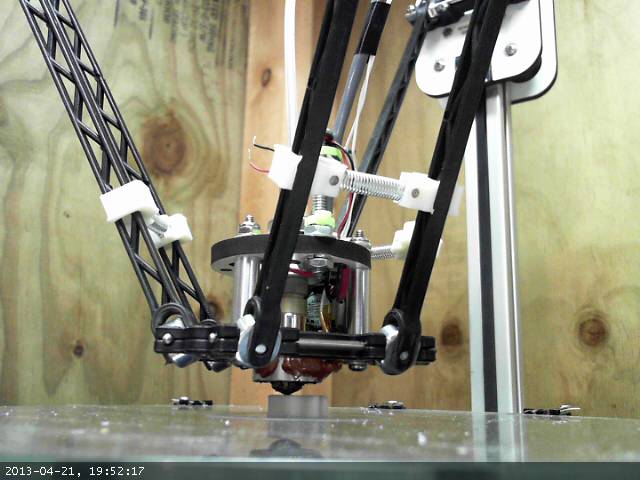

Had a tiny bit of slack on my platform and it was really noticable on rapid moves to new positions. More so on the stops..
I wanted to make a vibration dampener and a spring tensioner to keep the arms tight but not enough to cause "Delta Arm Blues". This is made for the factory rostock arms.
I used 1/8" x 3/8" dowel pins and some 6.5x22mm ring end springs that I had laying around. Did some quick cad work in alibre and made a new "Thing". The Clips do not have any holes in the file so you can use whatever you like to secure the springs to the clips. I just used a 1/8" drill bit and it worked perfectly.
Here is the file if you have the same problem.
http://www.thingiverse.com/thing:78095

or you could replace those molded arms with cnc machine arms that seemecnc now offers. supposedly doesn't require anymore sanding.

Don't see them on the seemecnc site yet. This works great for now.
