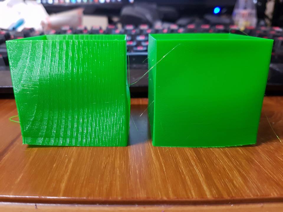

Posted: Wed Apr 12, 2017 10:43 am
by nebbian
More data from a user on facebook with an MKS SBase (32 bit board, 8825 drivers)
Left print is printed at 0.202 layer height, right print is at 0.161.
From this I can see:
1) That he's using 20 tooth pulleys, so his steps/mm value is 80 or 160
2) That his drivers are not in the best decay mode
For him to get better prints, he should print at one of the following layer heights:
0.081, 0.161, or 0.243 mm.
After doing some research, his drivers are in mixed decay mode by default.
I'm starting to really wonder why no drivers ever seem to be in the best mode by default. Why should we always have to mod them???
