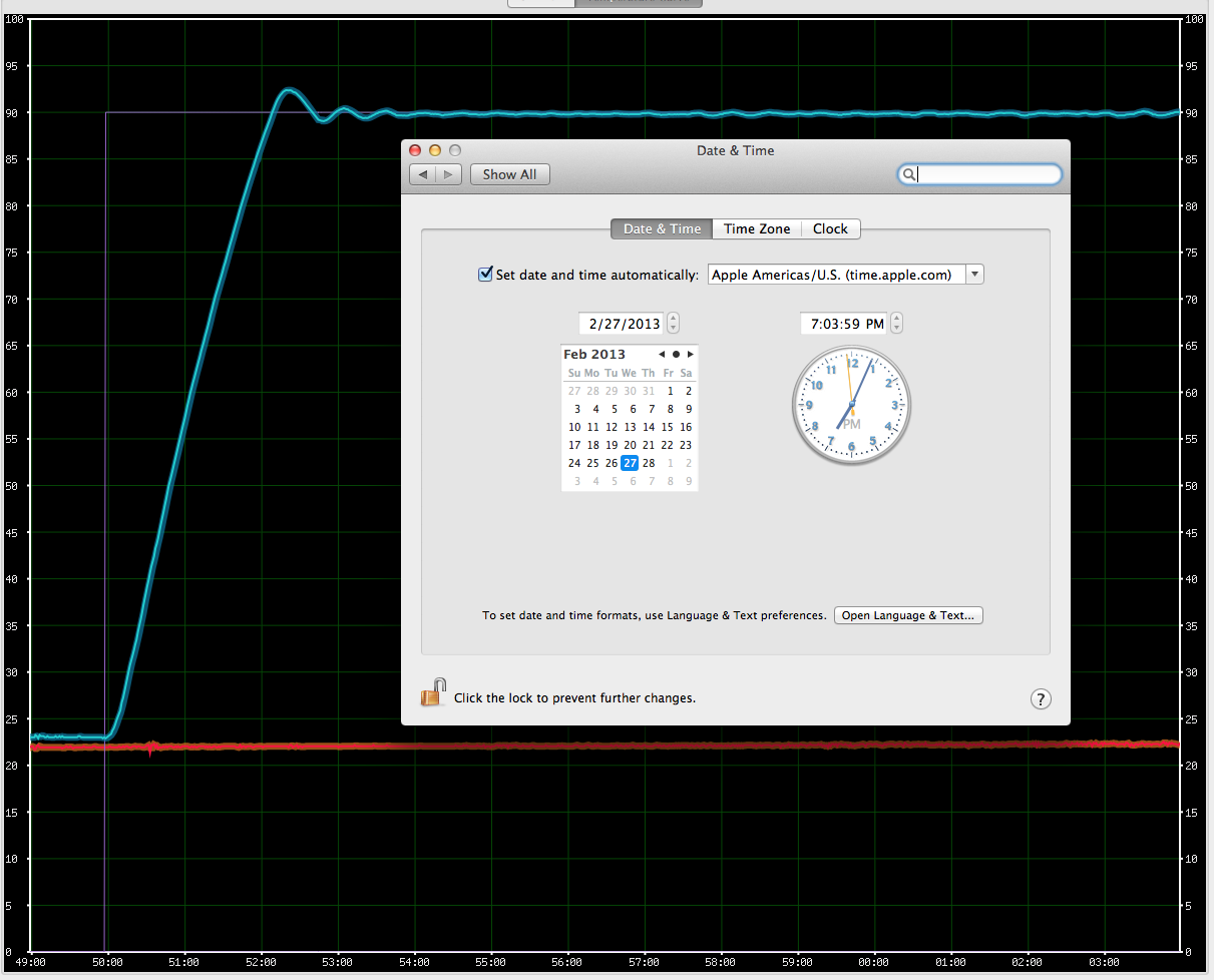

Gentlemen (and ladies) you are going to love this!
Let me start with the backstory, when I first installed the Onyx it was heating up very quickly - sub 2 minutes to 90°C. Then I removed it, resoldered the power leads so they "bend back" the opposite direction to route nicer through the slot in the base. I noticed that it took a little longer to heat - maybe 3 - 4 minutes but didn't really think anything of it. Then this thread got started as well as other Onyx discussions and I measured my voltage, etc. But I was perplexed why it was taking longer than original. I went back and looked at a screen shot of the heat curve and sure enough it was heating nearly twice as fast back then.
So, tonight I removed the Onyx and what do you think I found? Well, actually nothing - I like suspense. However, I decided to solder a third wire to each of the leads. So now I have three 18 gauge wires running from (+) and three from (-). I also made sure the connection at the connector was nice and tight. Then, for grins, I tuned my power supply down to 12.0 volts to see what would happen. The results are astonishing! I just took a screenshot with my clock/calendar overlaying the temperature curve display so you can see there are no shenanigans...

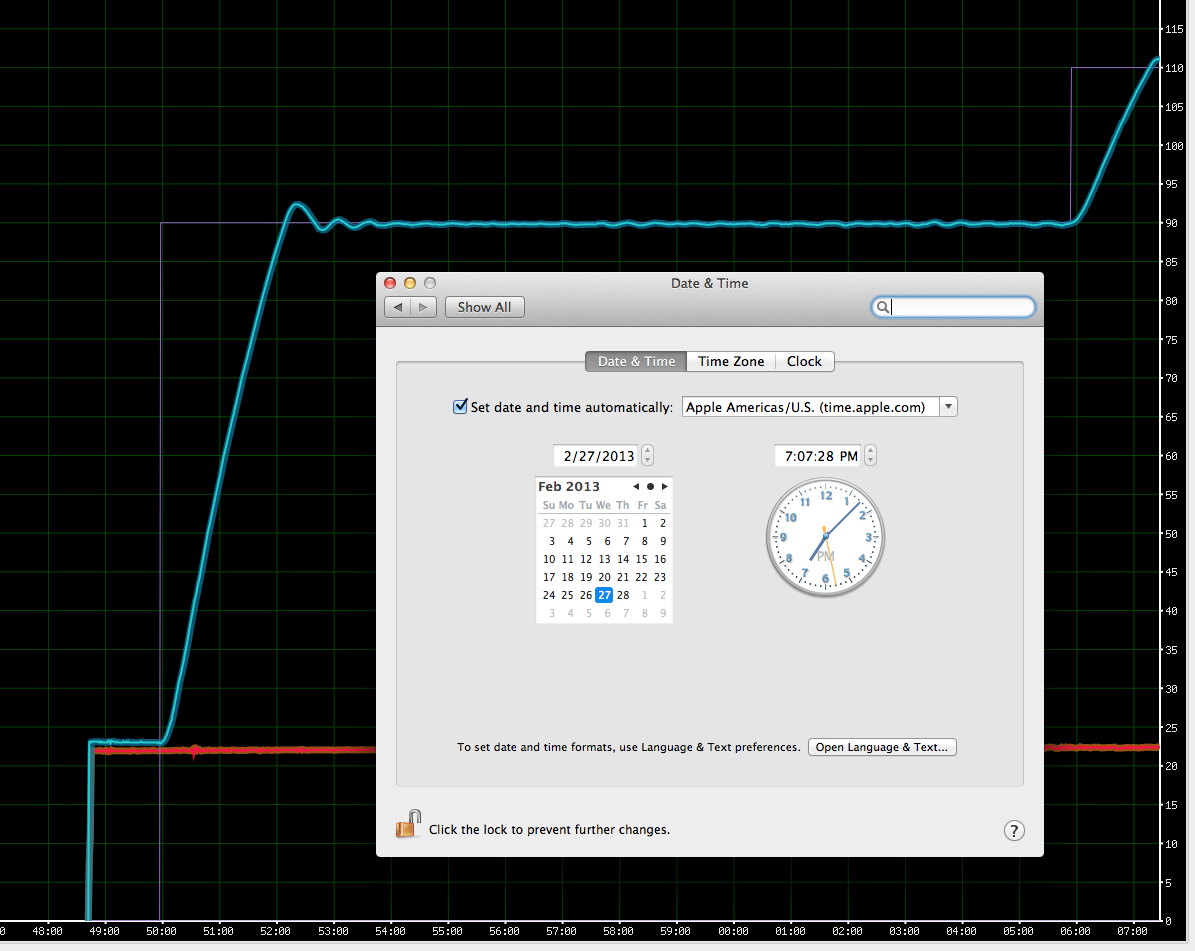

I am getting heat up to 90°C in 2 minutes and 15 seconds with my 12 volt 30 amp supply!
and as if that isn't enough, I kicked it up to 110°C to see what would happen.
As you can see, about another minute and a half and I reached 110°C.
Now I am not suggesting your results with the stock supply will be similar BUT I would highly recommend trying three 18 gauge wires to each terminal to make sure you are getting full current!

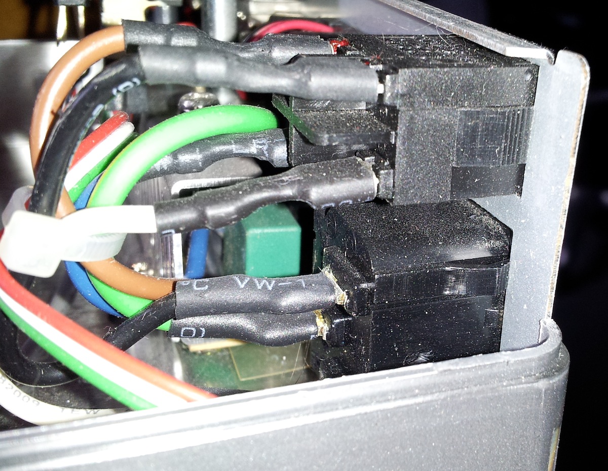

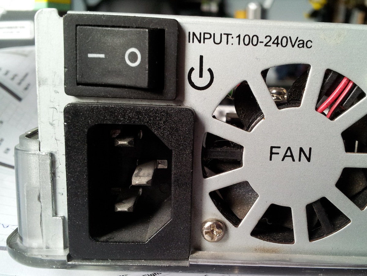

theverant
Posts: 188
Location: Halifax, NS, Canada
Re: Gentlemen (and ladies) you are going to love this!
Post by theverant »
mhackney wrote:Now I am not suggesting your results with the stock supply will be similar BUT I would highly recommend trying three 18 gauge wires to each terminal to make sure you are getting full current!
I have two 14 gauge wires and get nowhere handy to that performance. While my heating times seem slightly better than some others posting on here, they are still pretty darn slow compared to yours and and this point I would definitely like to upgrade my power supply. What are you using for a switch on yours? Also, how are you hooking things up to it? I believe the one you posted here previously was similar to this one:
[img]http://www.jewelrywhsle.com/hkesupplier ... etal-2.jpg[/img]
12v / 30A
What are the -V, N, and L connections for? Do you use just a regular light switch to control power in?
Re: Very bad Onyx heating (max 80°C)
theverant, if you don't know what -V, N and L are, I strongly suggest you do some research and reading before mucking with electricity. No offense, but this can be dangerous if you are unsure of what you are doing.
The ground symbol, N and L are for the AC connection to mains. You ABSOLUTELY MUST UNDERSTAND what these mean and how to connect them. Google it, you'll find what you need.
The +V is positive and -V is negative for the 12volt output. Since the RAMBo has three 12 volt input connectors along its side, I used one of each of the three 12 volt pairs (+ and -) to each RAMBo connector.
You certainly could use a standard AC light switch. I have a lighted AC double pole switch to disconnect both the N and L lines when off. These are standard fair at electronics suppliers. But, PLEASE make sure you know what you are doing. If you only switch one line (single pole) and don't do the correct one, you can get zapped/electrocuted even when the switch is "off".
The +V ADJ dial at the left is where you can crank up the output volts. Also, DO CHECK the AC Input switch - usually on the side - tpo make sure it is set to your local mains (NA is 120VAC).
Cheers and please be careful!
