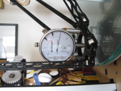

Starting to move ahead now, created my first part, a mount for dial guage. I've taken the arms off and 'fettled' them. Just before putting it to bed for the night decided to play with the dial guage. I really should have listened to my wife and not had another 5 minutes.
I checked the usual calibration points all referenced to centre of the bed as datum zero.
Z tower (X0, Y120) : -0.175mm (X0, Y-120) : -0.155mm
Y tower (X-60, Y104) : -0.1mm (X60, Y-104) : -0.382mm
X tower (X-60, Y-104) : -0.035mm (X60, Y104) : -0.565mm
Not quite what I was expecting, also, I'm not sure where to start looking for the issue. Any help appreciated.

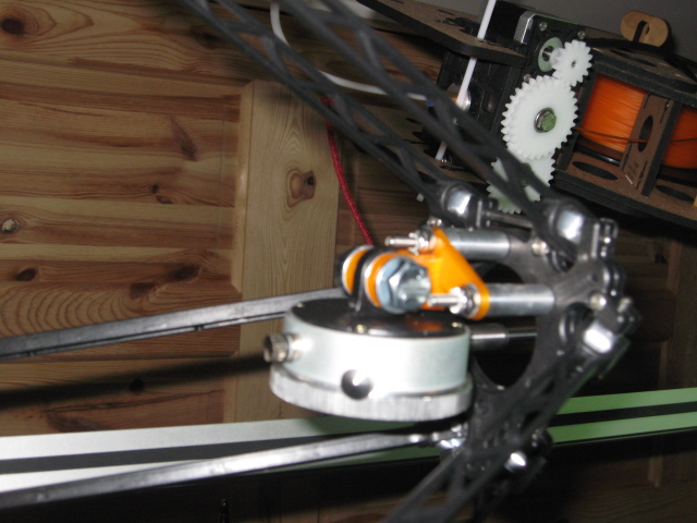

First build and design was a dial indicator mount for a cheap and cheerful Silverline dial indicator. NB: in my design I used an M8 to mount the indicator which meant I had to drill out the mounting hole in the indicator to fit (it was 1/4").
Dial Indicator Mount.stl
(119.13 KiB) Downloaded 339 times
Tried to load up the .3dm but it's not an allowed file so if anyone would like a copy, please PM me.
Having got the dial guage up and running time to check those zero's with the guage.

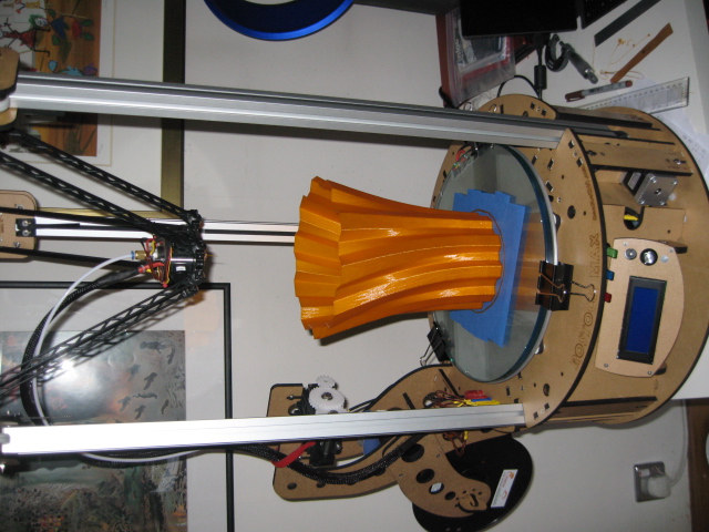

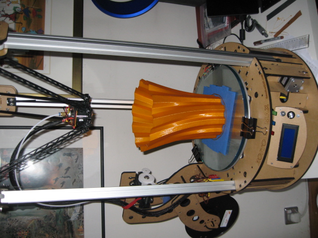

Carried on with what I learnt yesterday, just out of interest I tried the bed a different temperatures just to quantify the differences, from room temp. (19 degrees C), the centre raised 0.06mm and the edges dropped 0.05mm uniformly round the edge at 65 degrees C.
Recapping, X, Y, Z and Centre towers are all zero'ish (max 0.02mm difference), Inverse X is the worst at +0.685mm, Inverse Z at +0.231mm and Inverse Y at -0.032mm. Adding them all together and dividing by gives me an average of 0.294mm so this will be my target for all 3 inverse X, Y, Z. (Edit: managed to get them all down to +0.26mm).
As the tower sections and centre aren't as affected, to save time I only probed the centre and Inverse positions. See previous spreadsheet for steps for tuning it in.
Once all the faffing around was completed, hot end refitted and Z0 dialled in, then the first big print left to run overnight.
Unfortunately in my excitement to remove it I popped one of the edges from the base so, today is going to be how to repair it.

What's up with your glass? It takes up the whole Onyx and it looks to be a bit thicker than the glass here stateside, did you have that cut custom?
