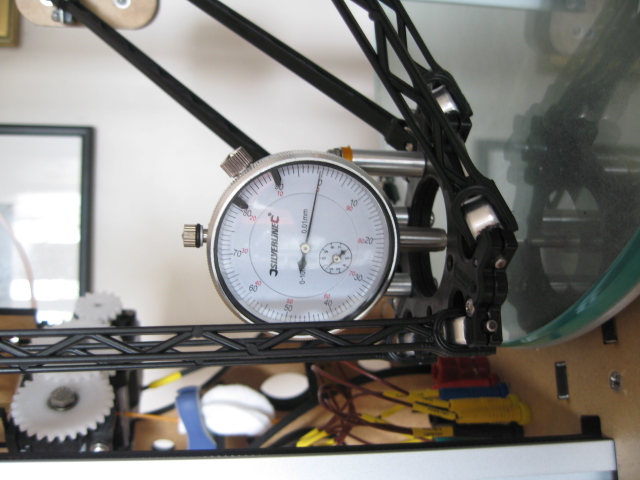

Starting to move ahead now, created my first part, a mount for dial guage. I've taken the arms off and 'fettled' them. Just before putting it to bed for the night decided to play with the dial guage. I really should have listened to my wife and not had another 5 minutes.
I checked the usual calibration points all referenced to centre of the bed as datum zero.
Z tower (X0, Y120) : -0.175mm (X0, Y-120) : -0.155mm
Y tower (X-60, Y104) : -0.1mm (X60, Y-104) : -0.382mm
X tower (X-60, Y-104) : -0.035mm (X60, Y104) : -0.565mm
Not quite what I was expecting, also, I'm not sure where to start looking for the issue. Any help appreciated.

First build and design was a dial indicator mount for a cheap and cheerful Silverline dial indicator. NB: in my design I used an M8 to mount the indicator which meant I had to drill out the mounting hole in the indicator to fit (it was 1/4").
Dial Indicator Mount.stl
(119.13 KiB) Downloaded 341 times
Tried to load up the .3dm but it's not an allowed file so if anyone would like a copy, please PM me.
Having got the dial guage up and running time to check those zero's with the guage.
Re: Bluemalu - Rostock MAX build
Posted: Mon Apr 07, 2014 5:56 am
by Bluemalu
Good reading if sometimes a touch confusing with every ones unique terminology.
http://forum.seemecnc.com/posting.php?m ... =54&t=4035
Having read though this and many related posts, I found the information confusing till I had a go and spent the day adjusting the tower rotations within the EEPROM. For starters I used the DELTA_RADIUS_A/B/C to define the centre of the build are relative to the towers. I must admit I wouldn't have thought this would make much difference but having calibrated the printer using the recommended manual settings ( zero at each tower base, set stop screws, change DELTA_RADIUS till X, Y, Z tower positions and C = 0). I was fairly happy with the build and prints, then the dial indicator turned up and I could take measurements allowing my CDO (like OCD but letters in correct order). When I tried the opposite sides of the build plate I found quite large errors (0.68mm with opposite X tower). So time to recalibrate.

The actual heights were unimportant as the dial indicator was reset to what ever I wanted to use as my datum (mostly Script (4)). The last 3 lines of the G-Code are probably superfluous as the whole point of a 3D printer is repeatable and accurate.
So having made the changes and reset the set screws and added 0.05 to my DELTA_RADIUS it was time to start on the tower rotations.

Carried on with what I learnt yesterday, just out of interest I tried the bed a different temperatures just to quantify the differences, from room temp. (19 degrees C), the centre raised 0.06mm and the edges dropped 0.05mm uniformly round the edge at 65 degrees C.
Recapping, X, Y, Z and Centre towers are all zero'ish (max 0.02mm difference), Inverse X is the worst at +0.685mm, Inverse Z at +0.231mm and Inverse Y at -0.032mm. Adding them all together and dividing by gives me an average of 0.294mm so this will be my target for all 3 inverse X, Y, Z. (Edit: managed to get them all down to +0.26mm).
As the tower sections and centre aren't as affected, to save time I only probed the centre and Inverse positions. See previous spreadsheet for steps for tuning it in.
Once all the faffing around was completed, hot end refitted and Z0 dialled in, then the first big print left to run overnight.
