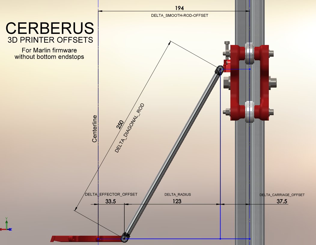

Here is a reference image that I found clarified and really made me understand what the delta values referred to and helped me measure them accurately. Do not use the values in the image however they are from a totally different delta printer. But they show where to measure on ours.

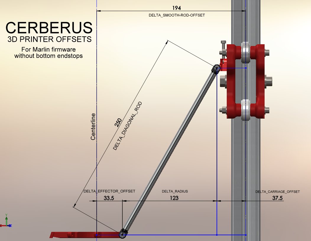

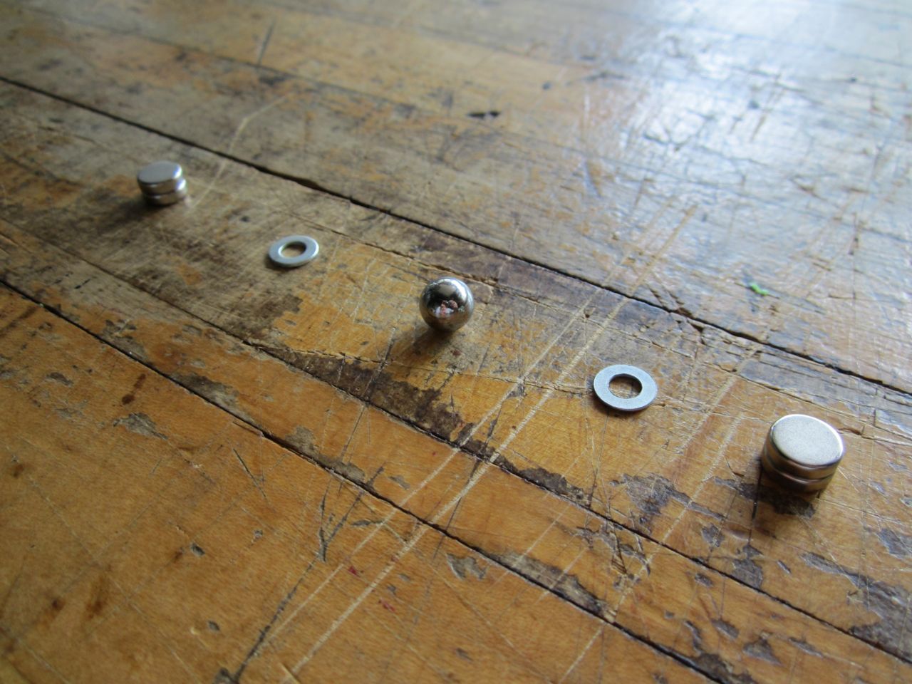

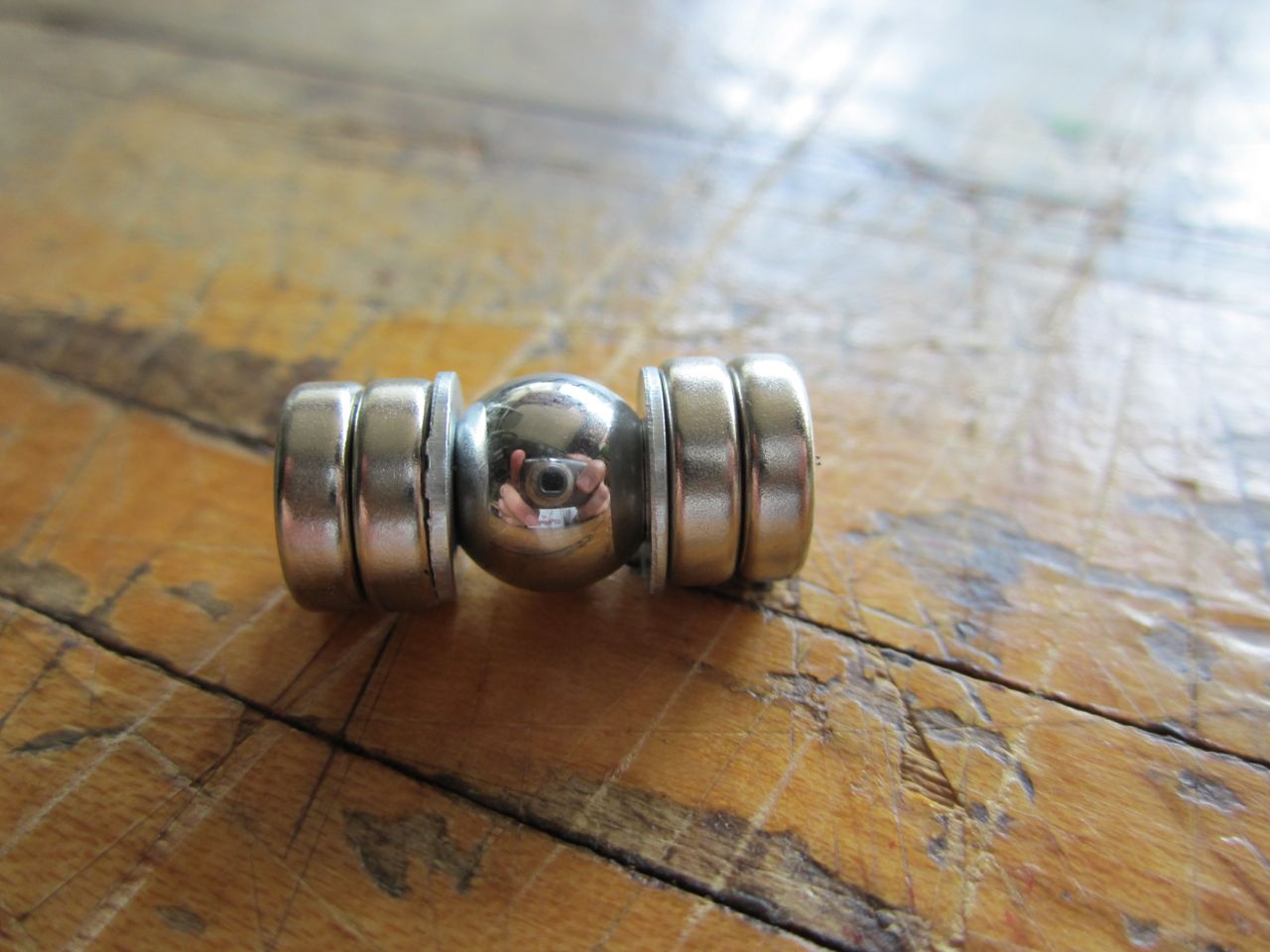

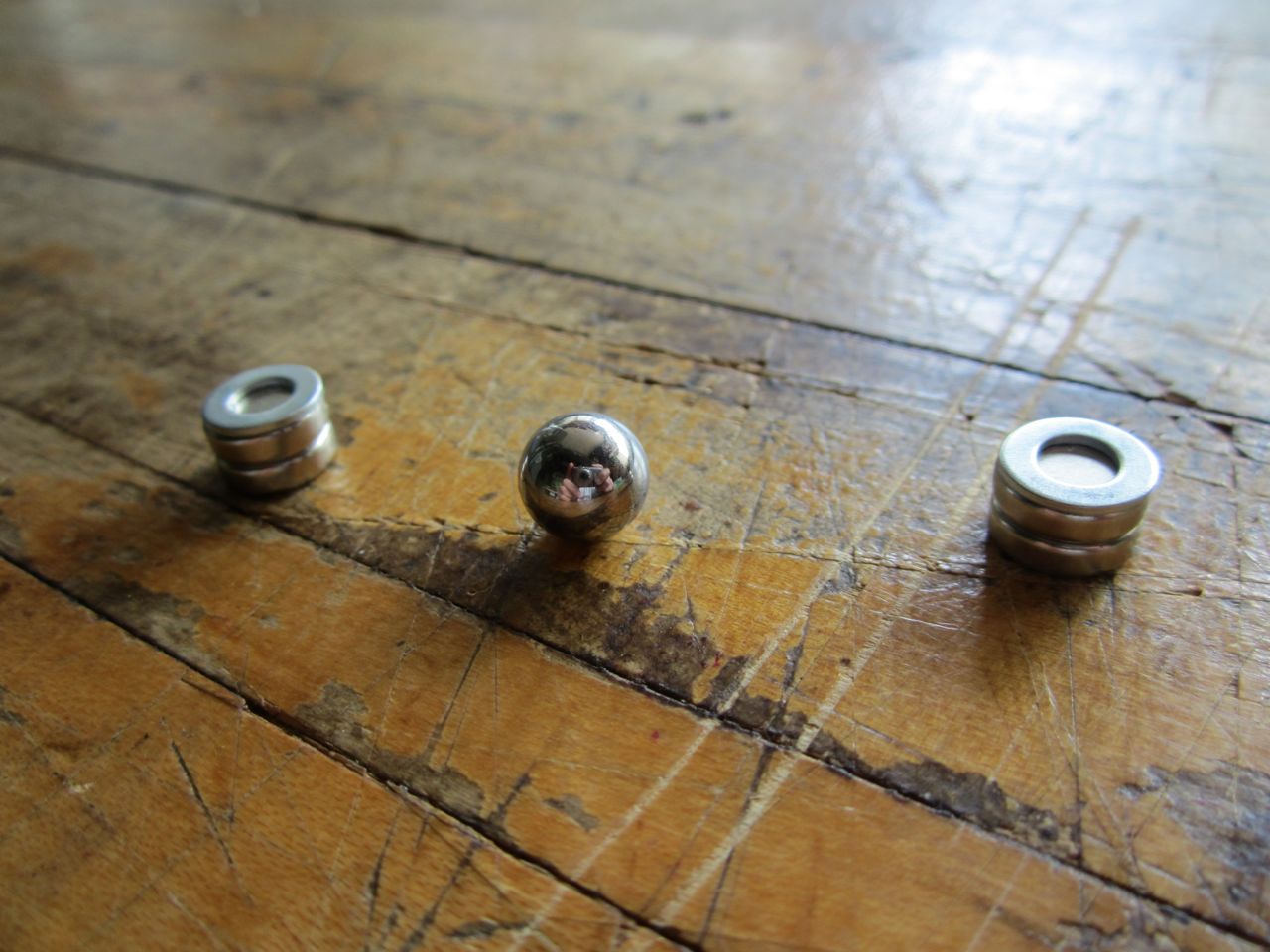

I got some steel ball bearings and some magnets to play around with this idea. Here's what I came up with so far.
I took four magnets, two M4 (I think) washers, and a 3/8 chrome ball bearing and made a sandwich out of it. The magnets and washers would be glued together and and center of the washers would act as a cup to keep the ball bearing centered. It is pretty strong and seems very stable. I think 6 of them holding the hot end platform would be plenty strong. The only thing that is stopping me from trying them is getting good rods of the same length.

Edit: It looks like the M4 washers limit the range of motion a little bit. I think switching to M3s would fix the problem and/or moving to a slightly bigger ball bearing.

The only two values that are actually use to compute the motion of the platform are DELTA_DIAGONAL_ROD and DELTA_RADIUS, all the other values are just used to compute DELTA_RADIUS from more easily measured values.Flateric wrote: Here is a reference image that I found clarified and really made me understand what the delta values referred to and helped me measure them accurately. Do not use the values in the image however they are from a totally different delta printer. But they show where to measure on ours.
