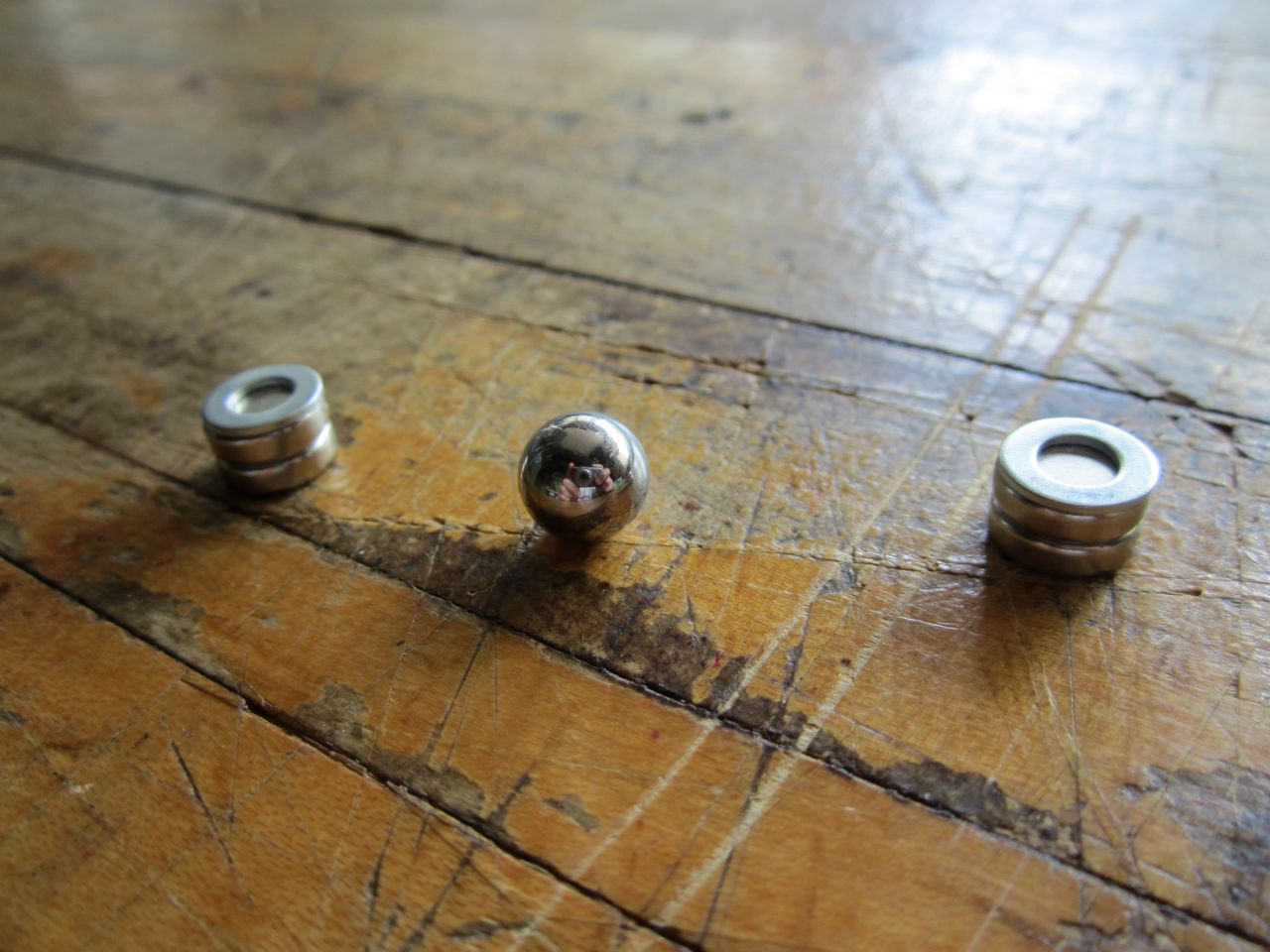

I got some steel ball bearings and some magnets to play around with this idea. Here's what I came up with so far.
I took four magnets, two M4 (I think) washers, and a 3/8 chrome ball bearing and made a sandwich out of it. The magnets and washers would be glued together and and center of the washers would act as a cup to keep the ball bearing centered. It is pretty strong and seems very stable. I think 6 of them holding the hot end platform would be plenty strong. The only thing that is stopping me from trying them is getting good rods of the same length.
Magnets
http://cgi.ebay.com/ws/eBayISAPI.dll?Vi ... 0717855827
Ball Bearings
http://www.ebay.com/itm/25-3-8-Chrome-s ... 0630819004
Edit: It looks like the M4 washers limit the range of motion a little bit. I think switching to M3s would fix the problem and/or moving to a slightly bigger ball bearing.
