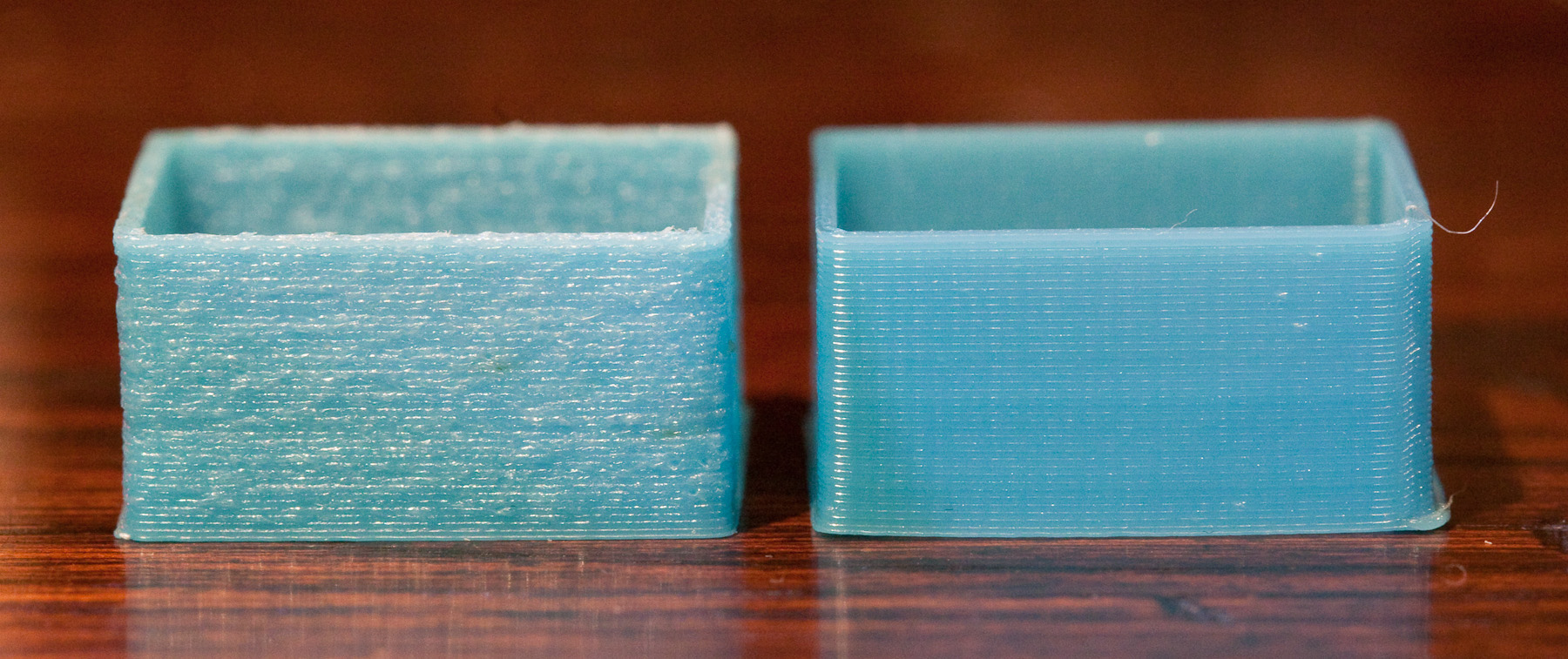

What a difference 2 hrs in the oven makes.
Walls came out 0.66mm vs the requested 0.6mm. I might try baking more tomorrow to get rid of the last few bumps.

where did you get your filament? quality seems lacking.
Re: popping sounds coming from filament?
Yeah, it's from Rainbot. I was going to send it back, but maybe I fixed it in the oven.
