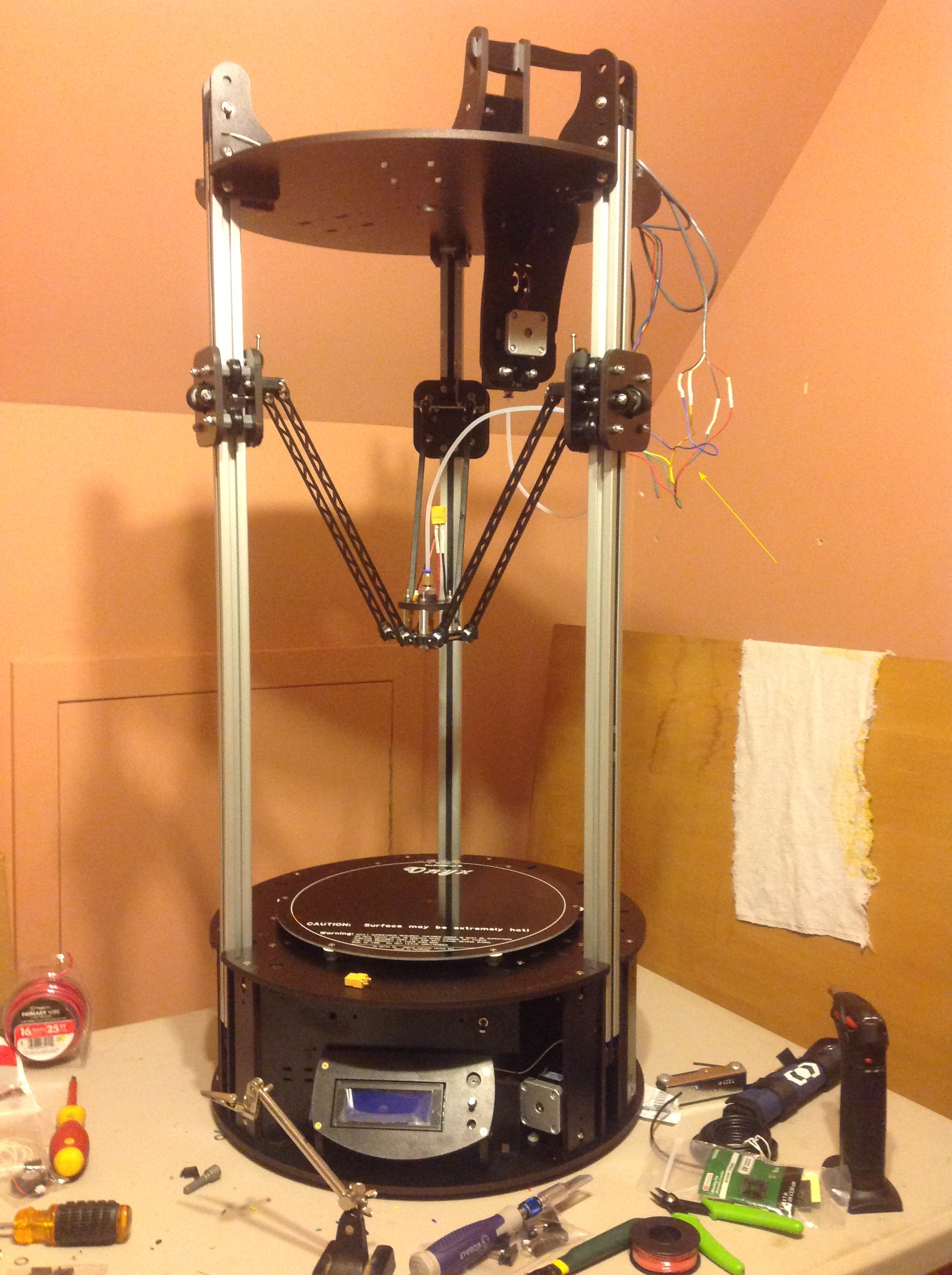

Hi, Gene.
I'm partway through assembling my beast. Here are some further comments. These apply to version 1.02 of the assembly guide, dated May 29th. I know you've already got a new version out. That's why I'm dumping my notes so far. I'll pull the newest rev. and continue building.
These comments are a little less organized than the first batch. They are also a lot fewer; you should apreciate that.
I believe you're reading my build log. I mixed up the order of assembly and I think I improved on the original ordering. But I'm not writing about those here, for the most part.

I've been sitting on these errata, sorry. I started printing two days ago and haven't stopped for breath yet.
These comments apply to the version that you published on June 3rd, but which erroneously had "Version 1.02, May 29th" on the cover page. git commit number 9b9ee2d.
And they are my opinions only. They're worth nearly as much as you paid for them.

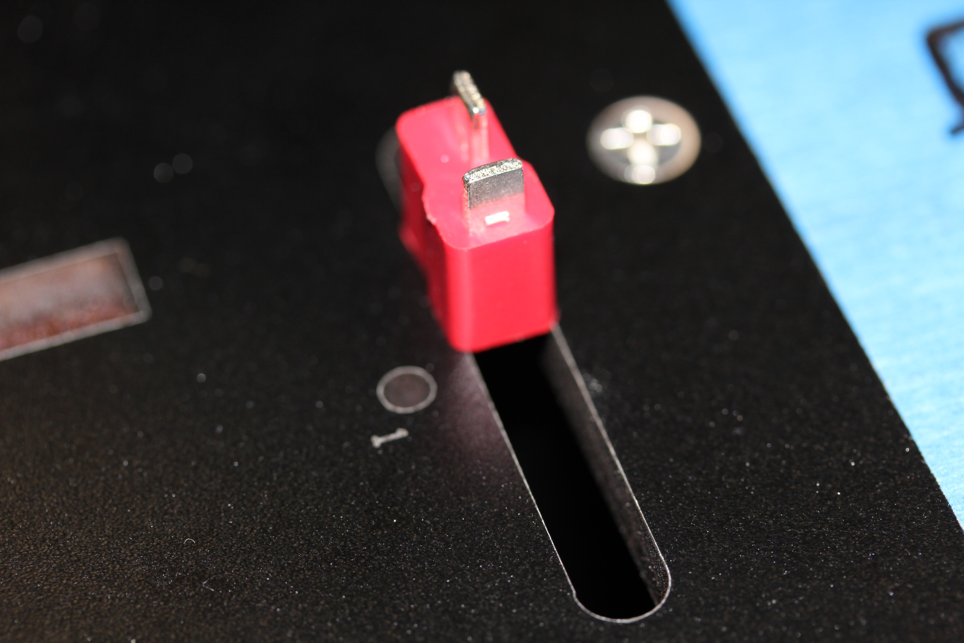

  • Dean's connector does not fit through the slot in the table.
    Dean's is too big.
    Dean's is too big.

The heated bed connector not fitting through the slot would only be an issue if you're removing the whole heated bed for some reason. I'm on the fence about worrying this point...

geneb wrote:The heated bed connector not fitting through the slot would only be an issue if you're removing the whole heated bed for some reason. I'm on the fence about worrying this point...
I'm not understanding why we have a connector at all, then. To remove the RAMBo, you can unscrew the terminals. To remove the Onyx, you still have to snake the cable back through. Making the cable a couple inches shorter with a connector that won't fit out through the slot is um, an interesting strategy.
I did not put a connector in. If the Dean's had fit without cutting the table, or if I'd known to cut the table earlier in the process, I would have put it in the expansion bay, right where the cable comes through the table, to make removing the Onyx easier. If I ever have to replace the Onyx, I'll probably use that as an excuse to track down an XT60 connector. (Or maybe some automotive connector. Cars have lots of high current wiring.)

Ok, maybe I totally over-thought the whole hot bed connector thing. :) I think it came about because Ultimachine replaced those awesome terminal blocks with those tiny-a** useless things that are a stone pain in the butt to get at. I've noted it as optional. I added the resistor value for grins. :)

Great manual, BTW, however just reviewed the version from Aug 2nd and the part I am missing is the setup for the hot end that includes the new spool on top config. all the pictures show the original version, nice orange color BTW, and with the spool on top this changes the ability to route the wiring along the Bowden tube. Also, I have been struggling to find a good way to route the wires for the extruder motor that will keep it out of the way as well as tidy. Have been missing several screws throughout the process and have more than enough of others. Hopefully having parts left over is a good sign like most of my other projects. :D
This is where I am at so far any guidance would be appreciated.
Posts: 5358
Re: 2nd Edition Review Thread
Yeah, that's one of the things that drives me nuts about the guys. They create cool things, but stop just short enough to drive end-users out of their minds (including me!).
Wire routing for the top mounted extruder is unfortunately still at the "work it out" stage. :( I designed a pair of clips that will allow you to use a 3/8" dowel rod to support the stepper motor wiring along one of the tower extrusions. I use a cheap retractable lanyard to support the hot end wiring. I did a quick video a while back that shows how I did these things - see http://www.youtube.com/f15sim and watch the video titled "Quick overview of the SeeMeCNC top mounted extruder drive".
You can download the STL files for my mounting clip from https://github.com/seemecnc/rostockmax in the "PRINTED_ADDONS" folder.
