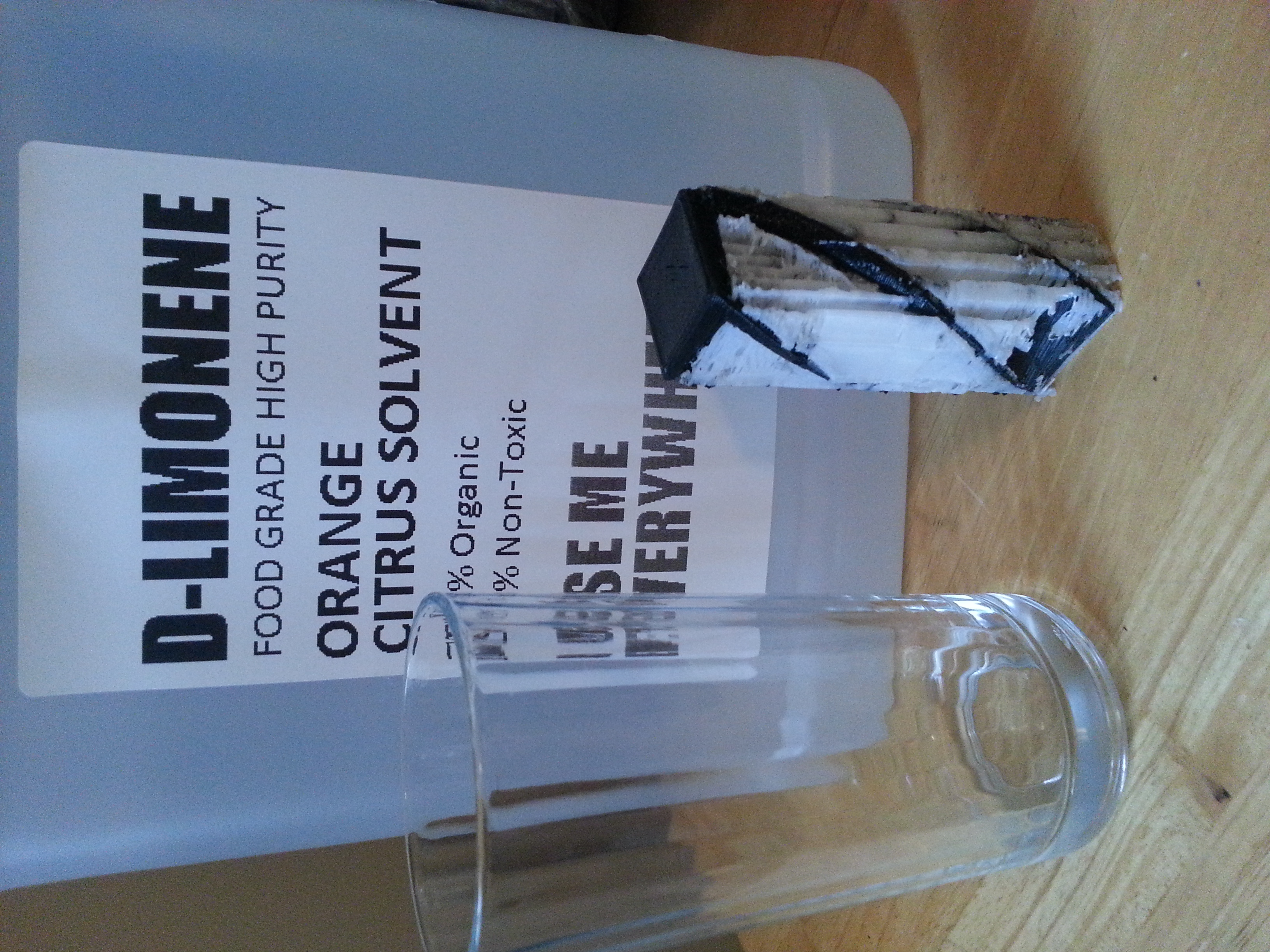

Broose wrote:
LorenOlepi wrote:First Print = different support
https://www.youtube.com/watch?v=y5EwPDhGvxs
Did you try dissolving the HIPS with limonene yet?
In process as I just got the limonene in yesterday. Any tips? I would like to be able to thin it out some how since it was so expensive.
LorenOlepi
Posts: 76
Joined: Tue Apr 30, 2013 5:40 pm
Location: CT
Re: Dual extruders
Post by LorenOlepi »

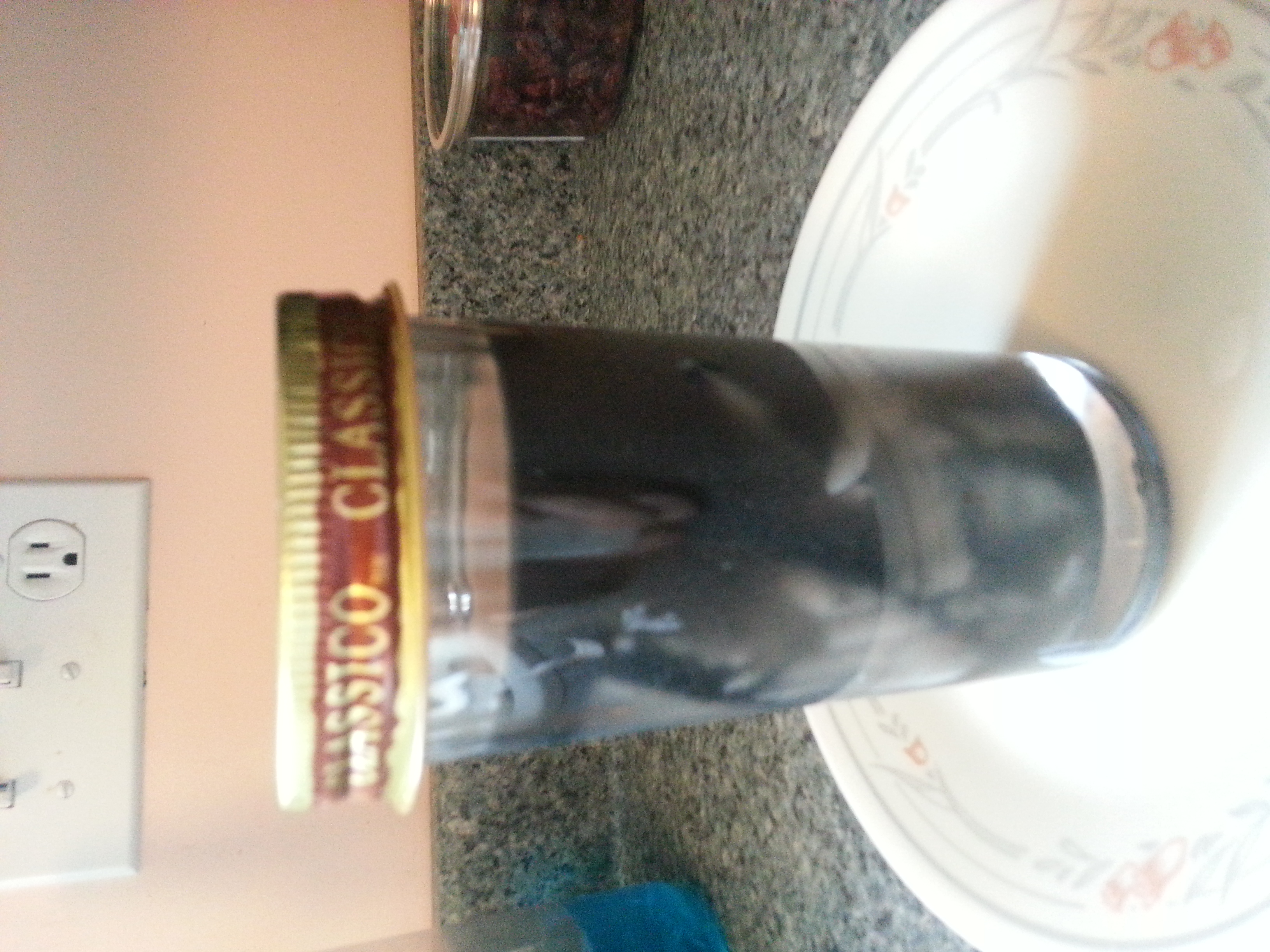

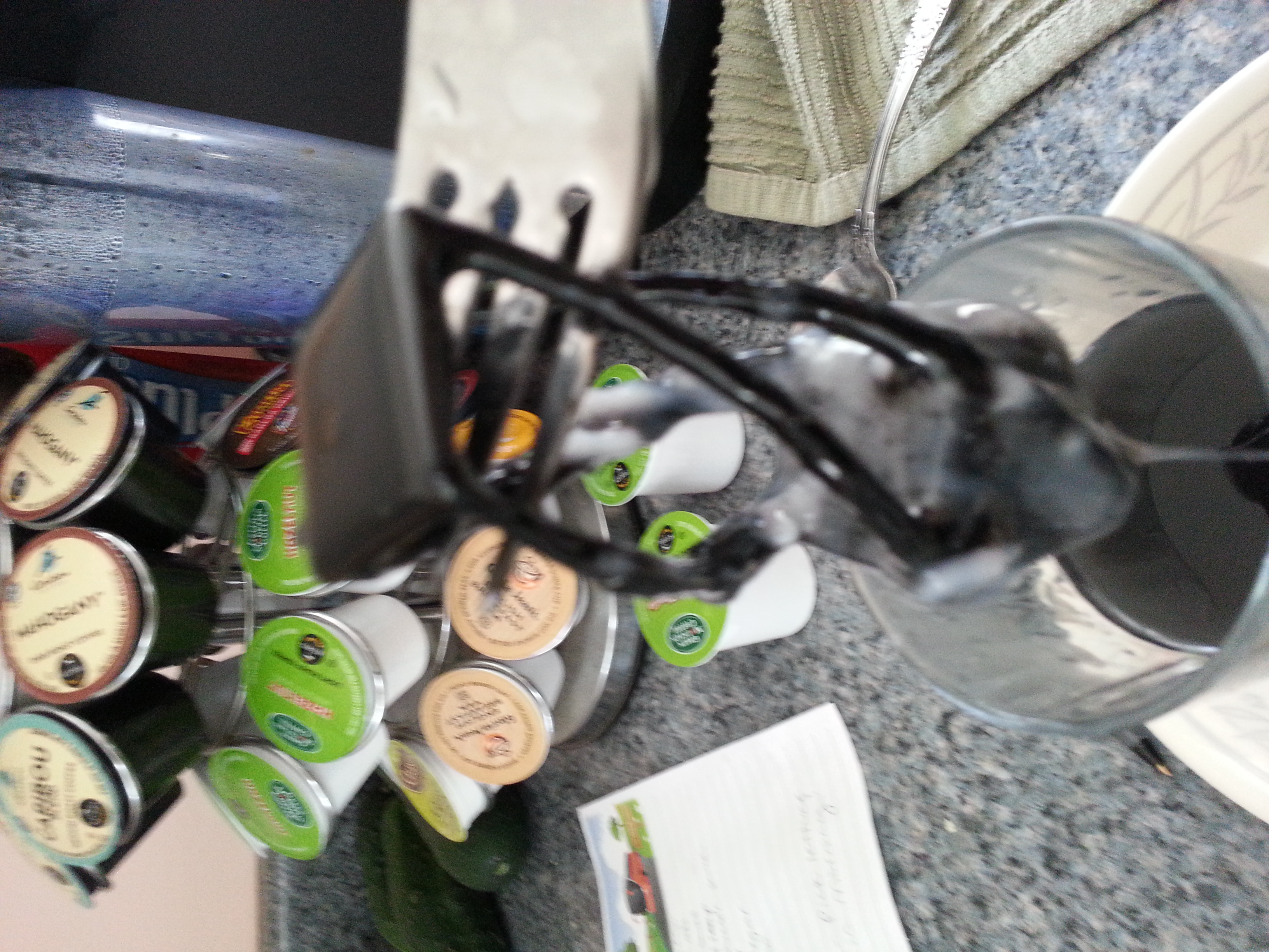

Just gave the first print that had the hips support a bath in limonene. It didn't come out clean as a whistle but it did melt the support material. I ended up getting a 100% pure limonene and think it could be diluted because it "melted" the ABS similar to an acetone vapor bath and it only took about 2 hours to dissolve the HIPS were I read it could take 24 hours. I tried using some other citrus based cleaners that were about 5% limonene on the raw hips material but it had no effect, so there is still a lot of room for testing.
Note: it could be that my ABS filament is crap and thats why it melted because I have had a difficult time with this role of black (kinda why I wasted it on the test). I suppose I can test it on a good roll
PS: Don't mind the poor print quality...it was the first print with duals. The machine is nice and calibrated now :)

Nice.
With regards to diluting, I saw this post (https://groups.google.com/forum/#!topic ... Os3lmLrgbo):
"I just received a gallon of the limonene, and tried to see if it
really does dissolve the HIPS filament. It dissolved it completely in
under four hours. I also put some filament in a cleaning solution I
made with about 1/4 cup of limonene, a squirt of Dawn dish washing
liquid, and 1 3/4 cups water. The filament dissolved in under six
hours in that. "

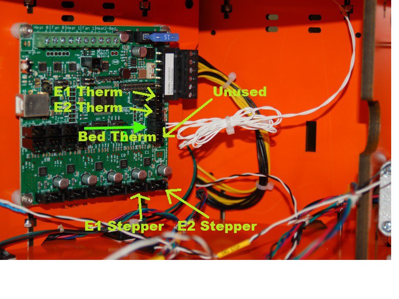

Yep, I did all of the changes from earlier in this thread and from Foshon's thread. As soon as I upload the firmware with NUM_EXTRUDERS set at 2, it doesn't work.
The LCD screen doesn't display any temperatures (neither does the repetier host control panel), and I can't move any motors.
If I set it back to NUM_EXTRUDERS 1 and re-upload the firmware, the temperatures show up on the LCD and the control panel and I can move the motors.
Switching to 2 extruders in the repetier host printer options lets me switch between them, except the buttons control the temperature and motor of extruder 1 only regardless of which extruder I have selected in the control panel. It doesn't show the temperature of the 2nd extruder's thermistor, only the 1st one. The hotend and case fans don't work now that I switched the fan pin to #define EXT0_EXTRUDER_COOLER_PIN 8 in the configuration file.
I tried reinstalling the firmware from the seemecnc download page, but that didn't help. Basically, nothing is working right when I set NUM_EXTRUDERS to 2.
I attached genebs picture of the wiring with my current wiring setup annotated. Tell me if I'm doing something wrong!

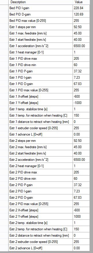

Also make sure to go through all of your eeprom settings in reptier host... heres a snap shot of mine

Could you take a look at the picture a few posts up and just check that it's the same as your wiring?

I have two thermistors plugged into the connectors in that picture. Both of them work fine when I have NUM_EXTRUDERS set to 1. When I set it to two, the LCD says def/0.
So the thermistors definitely aren't defective, and they are connected to the right thing. Why does switching the NUM_EXTRUDERS to 2 cause this to happen? Are they being switched to a different pin or something?

Problem solved! (I think)
After switching all of the E2 components (heater, thermistor, motor) to the E1 plug slots, I saw that all of them worked except the thermistor. After a bunch of failed continuity testing I narrowed it down to a white wire. It turns out that all of my problems were caused by a discontinuous thermistor crimp. I bought a ribbon of 40 crimped single female pin wires from amazon and some of them are defective.
Now that I can control both motors and both thermistors it seems to be working fine. It looks like dual extruders are going to work for me! FINALLY!
Thank you to everyone who helped me out here.
