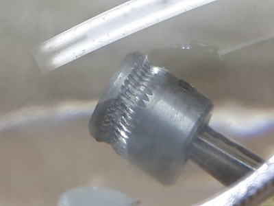

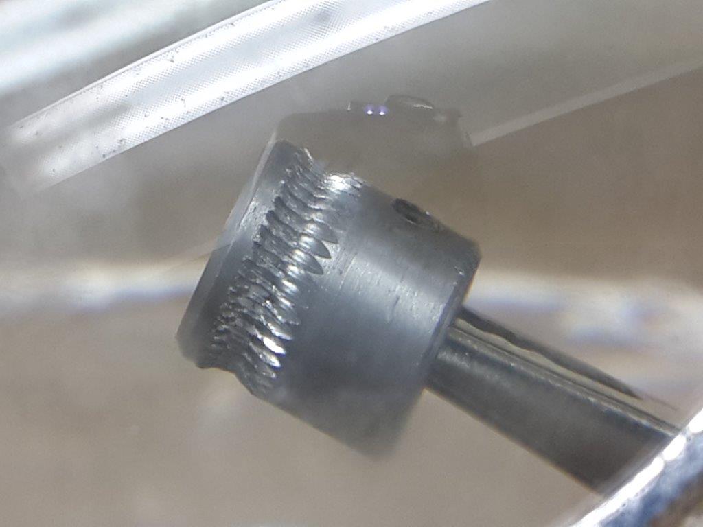

mrbi11
Posts: 94
Joined: Mon Nov 18, 2013 7:18 pm
Re: Strange STUTTERING on complex parts
Post by mrbi11 »
cope413 wrote:Mrbi, you posted in the wrong thread then. This thread was not related to the EZstruder.
I had problems with complex parts printing irregularly, and it appears related to the ezstruder skipping. In my opinion there are two causes
to the issue described, one of which is extruder.
Having said that, out of the box filament would not feed .
What does that mean? I won't try to guess, but please clarify
I mean my brand new EzStruder you could NOT get anything through with a hammer. The NEW ezstruder was seriously
out of alignment. It has a nylon pieces and an aluminum piece with the correct sized holes, but they were about 30% off center.
The design looks fine, the quality control most definitely was not.
How hard is it to stick a filament in the bottom to see if it goes thru?
With no tip? Does that mean you're extruding through the hotend with no nozzle?
No, extruding filament out the bottom of a disconnected EZstruder.
What about just extruding, as I just said to do, through JUST the EZStruder - not through the bowden or through the hotend - JUST the struder
Yep.
However,...
I was tired of talking about this, but my Z axis motor chose now to give out (skip long boring story), so I thought I would double check.
Extrding out the bottom of the extruder DOES make the filament rough, but inder the loop they are well formed dimples with no flakes coming off.
I think I did this the first time with some dust still in the extruder. Dimples yes, flakes no.
I examine CLOSELY the filament after printing at a very slow pace, with a very small amount, 0.1mm thickness by 0.2mm wide.
This feels rough too, but under the loop it has serious divot shapes, with a sharp edge. There were many flakes, and several flattened spots.
It was natural abs so is very hard to see. So printing speed in slicer set to 20 (instead of the 30 recommended) tiny little dribble of ABS.
Should be much lower pressure than printing 30 and 0.2 by 0.5 trace.
By the way, the shot below with stuff stuck in the groove is AFTER having 120 psi air blown at it.
The bits that get stuck are really stuck. Even a wire brush has trouble getting it out.
(my preview is showing the same pic twice with the second at the bottom?)
This is hard to see, but the before picture has 3 grooves filled with natural ABS, but it is semi transparent, so i can barely see it.
The second pic is the same grooves after i cleaned them out with a sharp tool.
So, printing way too slow and too tiny for there to be any point, at 235C, new tip, I get flakes and they definitely come from the EZstruder.
Maybe its cheap ABS, maybe my filament drive gear has sharp edges, maybe both. Maybe bad karma I have earned
