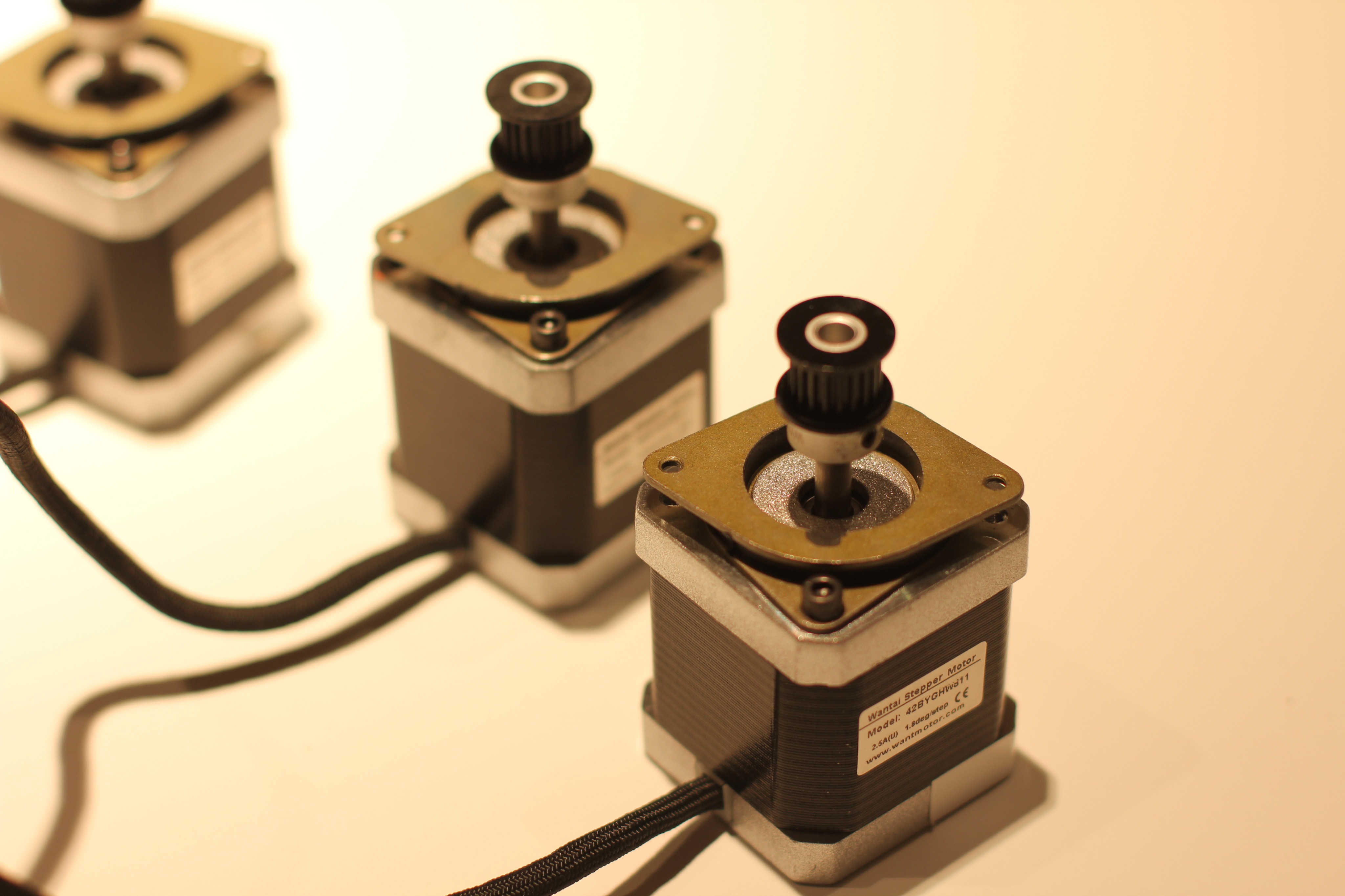

Are you sure you installed them correctly? I did mine as follows for each motor:
Two existing screws w/ washers from the existing motors on opposite corners go through the melamine into the threaded damper hole. They do not touch the actual stepper motors.
Two new 5mm m5 screws attach the damper to the motor through the unthreaded holes - they don't touch the melamine.
The only connection between the motor and the melamine now is through the rubber damper.

I have to agree, the rubber does not get compressed at all during installation. Longer screws should also not be required. I think you have yours incorrectly mounted MDMD.

Posts: 5359
Re: SOLD: Astrosyn NEMA 17 dampers
Someone should probably post pictures of the installation in their Rostock MAX to avoid confusion. :)

geneb wrote:Someone should probably post pictures of the installation in their Rostock MAX to avoid confusion. :)
Here are the dampers on my motors. Once you get this far, it's pretty hard to mis-install them.
The screws seen here are M3×6. They go through the damper's unthreaded holes. I used two of the kit's M3×10 screws to affix the damper to the printer.
The pulley has been raised 6 mm. I used the M3×6 screw as a depth gauge, then checked it with a caliper. The toothed section of the pulley is wider than the belt, so it's okay to be off by half a millimeter or so — just check that the belt doesn't rub the flanges after everything is assembled.
Use thread locker all around, of course.

Last night, I reinstalled the dampers so that the shorter screws attach the motor to two damper corners and the regular screws attach the other corners to the melamine. Before, I had longer screws attaching all four motor corners to the melamine through the damper. The result ...
- it's a little more effective than when they were installed incorrectly ... I don't know, maybe 10% - 20% less sound?
- I can't tighten the belts as much as I used to. If I try, the belts pull up on the motor shaft causing the motor to tilt upward a bit. It looks like the belt might eventually slip off when in use. Also, when pulled up at that angle, the setscrews on the shaft start to rub the melamine. I could move the pulley even farther out to alleviate that, but I don't like having the shaft at that angle. So I set belt tension as tight as I could before the motor tilt started to be an issue.
I'll try some prints this weekend and see what happens with the looser belts. If no one else had this issue, then maybe I've been making my belts too tight all along?

barnett wrote:it's a little more effective than when they were installed incorrectly ... I don't know, maybe 10% - 20% less sound?
I take that back. After actually running some print jobs I'd say it's more like 50% better. My shafts are still being pulled up by the belts, but it's not causing a big problem.
