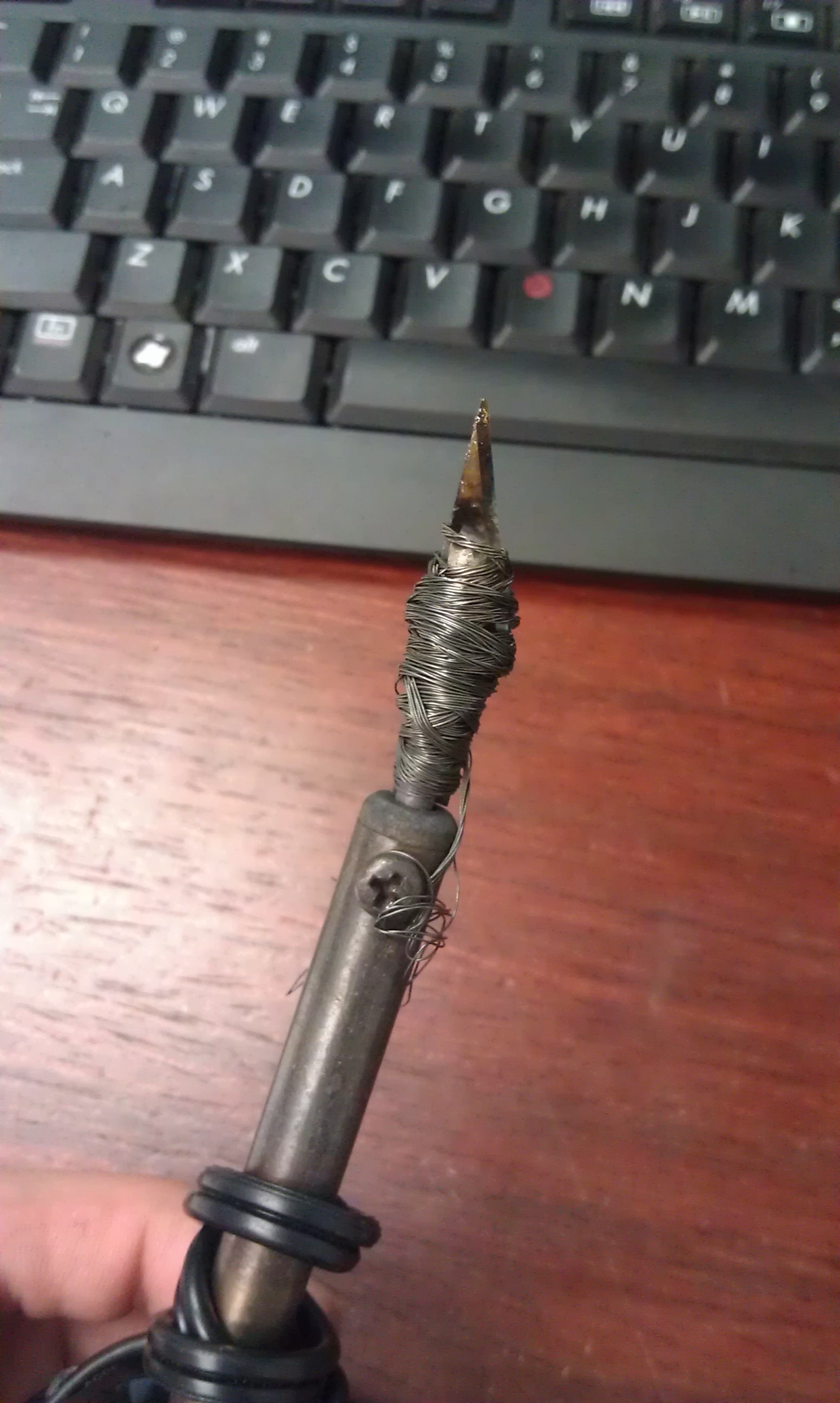

Yep, just printed my first trimmer line print with support.
Not surprisingly, it's tough to remove at the point of interface with the print.
I took an old 60w soldering iron and attached an exacto knife blade to it with some stranded wire. At temperature it's a great cleanup tool for trimmer line. Cuts through nylon smoothly. Easy removal of the support material.

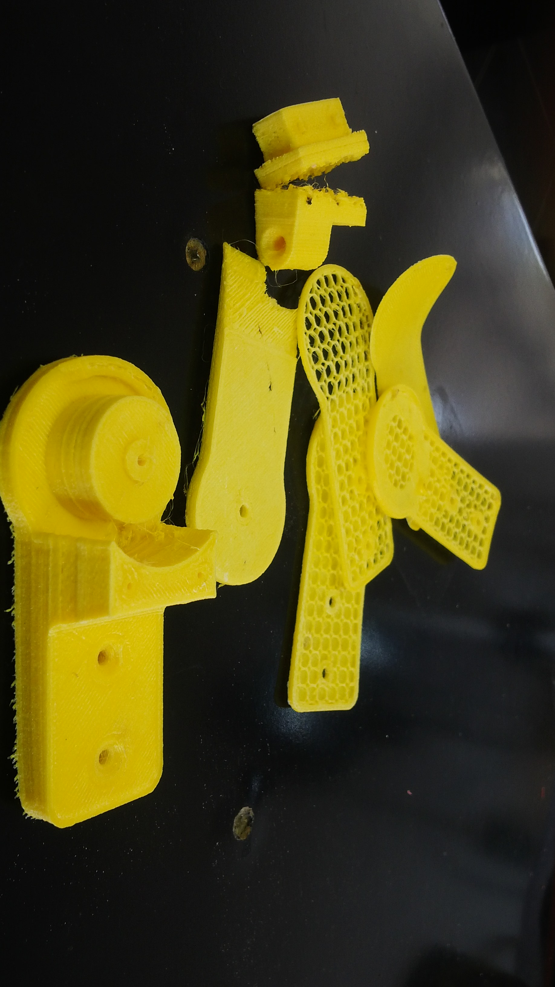

OK, I got some trimmer line ( mine is yellow in this Country )
Printed a few things, BUT. astonished how much "curl" and distortion I am getting. I will try to bake the filament tonight an see if it improves.

I was being impatient (I find it one of my better qualities, I learn so many lessons this way) as usual, so I put my trimmer line in the oven for 300°F and left it for some time and it turned it brownish. Besides that is printed great (for nylon) and is pretty much a requirement for filament. Next set I did 225°F and some amount of time. I would occasionally go check on it and let in some drier air, I could feel the air in the oven had more moisture. The filament will lose it's sheen when it's dry.
Drying does help the extruder too, make sure the hobbed bolt is clean, you'll have to clean it each time it eats a chunk of filament. I just have a toothbrush next to the printer and the cover off my ezstruder at this point.
Until you narrow it down:
I'd raise the current setting in the firmware for the motor to 190 if it's lower than that, it'll get warm but should be fine while you narrow down the filament issue. I have a small fan blowing on my extruder motor so I have had it set higher than that for awhile.
Go ahead and lower your retract speeds if you are using any retraction, I'd say just half it initially, then raise it to see if the problem returns.
Redo your EZ struder spring tension and check the hobbed bolt alignment, using a smaller diameter filament just makes alignment that much more important.
Check your bowden tube fittings and make sure they aren't causing any troubles. I had my bowden tube not sit just right in the hot end and caused me all sorts of headaches, and on the fourth time of checking the connector it all cleared up.

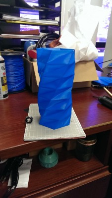

First, yes, I'm still working through some logistical issues with the supplier, but I'll definitely be reaching out to the forum for willing testers.
Second, glass-filled poses a few issues, but I think it may be possible - and the benefits are obviously enticing. The main issue I see would be the consistency of the fiber length, and the consistency of the mix.
We use PA66 with 25% fiber in our injection molds. We had to go through a few different blends to get it "right". Too fibrous and the parts didn't look good aesthetically. Not enough and we had too much shrinkage and/or not enough strength.
Too fibrous in the filament and I think jams would become an issue. If it wasn't very consistent, you would have sections of line with lots of fiber, and some without much - and that would mean certain parts of the print would be cooling at different rates and bring us back to the same issue contraction/warp.
The other thing that I'm not sure about is the fiber itself. Typical fiberglass is mostly silicon dioxide based and has a glass transition temp somewhere north of 1000C. The heat capacity of a fiber blend would be very different (higher) than virgin, and it wouldn't surprise me if the current hot ends wouldn't be up to the task.
That being said, even a 5% blend would likely yield pretty significant benefits in both strength and thermal expansion properties, and I'd like to think that there's a way to extrude a 5% PA blend on a hobby level printer.
As for binky and max's issues, I'm pretty surprised. I'm not on my 5th, yes 5th, 3lb spool of the blue desert extrusion stuff, and I think I've had 2 parts I had warp issues with. Both my fault for not having glue stick all the way out to the edges of the print.
I've found it much easier and more forgiving than ABS in the warp department.
This guy is perfect and water tight.
I've found that there's no need to go lower than .3mm layers. The vertical resolution at .35 is just as good as ABS at .2mm.
Binky, first off, that's way too hot for drying nylon. 150-170F is where you should be. 4-6 hours will do the trick. Industrial desiccant dryers of nylon pellets run at 70C and get moisture content to <0.2% in 4 hours or less.
I've found that 80C bed with a healthy layer of glue stick works wonderfully for first layer adhesion. I drop it to 70-75C after the first layer. I set my hotend to 265 for the first layer (at my print speeds, it holds at 260-261), and then drop it to 260 for the rest of the print (it stays between 255-258).
Below 255 and you're not going to get optimal layer adhesion. As long as you don't push it to 280C, the nylon will be fine.
