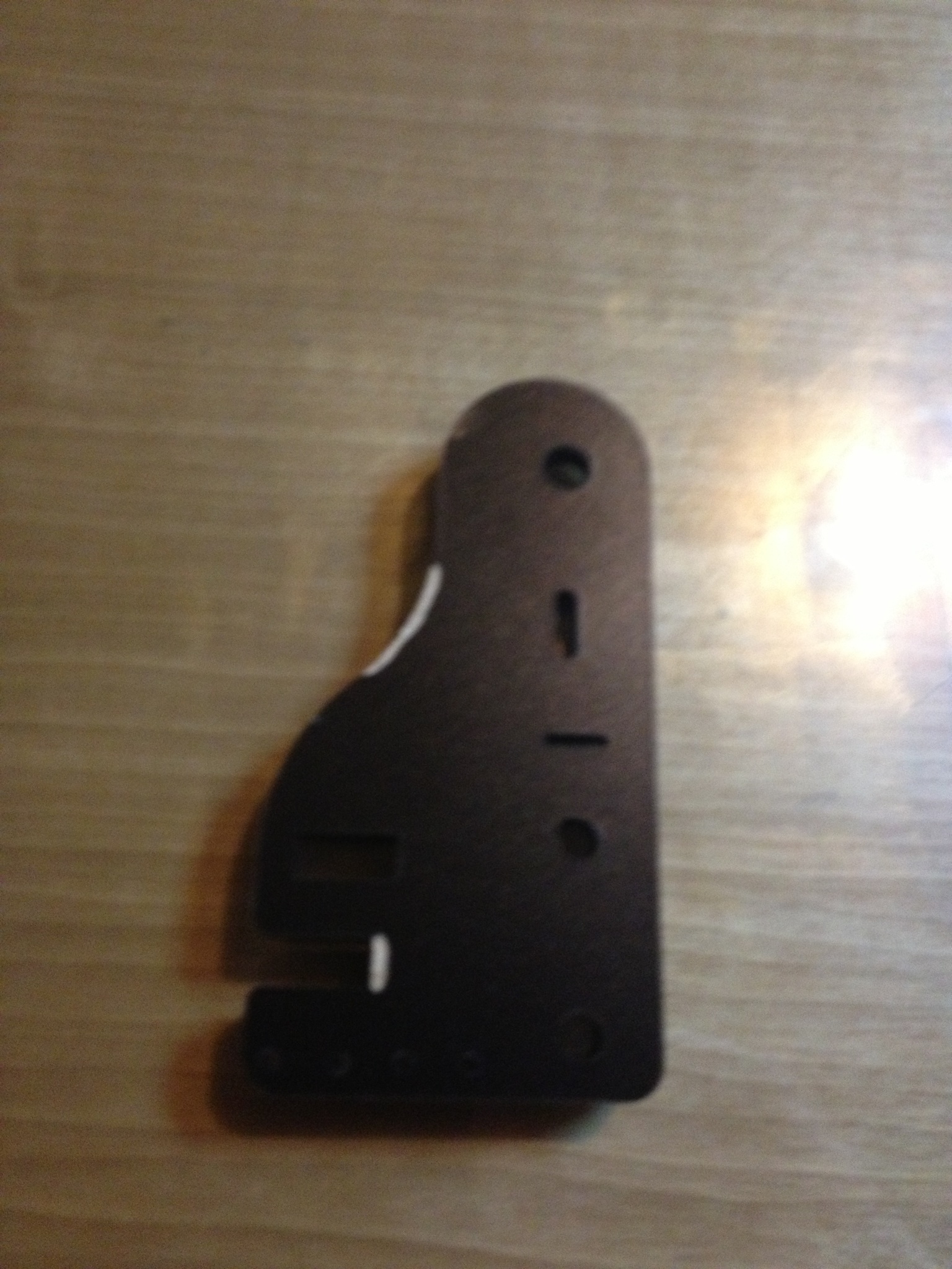

I know exactly what it's for, I'm just annoyed that peeling it did this:

Re: I just bought this thing!
Doc:
Send the pictures of the chipped parts to SeemeCNC support.
They will most likely send you new parts. I am not trying to speak
for them but from past practice, they will take of you.

A good hair dryer or a paint removal heat gun on low go a long way removing frustration (and damage) from that process.

I'm pretty sure I did it...it's humid (raining) here in Atlanta and the thingy was outside on the front porch for a few hours...probably had something to do with it. I'm seriously considering snagging a new set of laser-cut parts and working on wiring over the weekend.

A trick I learned from working in the sign industry- Use a hair dryer or heat gun to heat up masking tape and paper before/during trying to peel it. I peeled almost complete pieces off of the large bottom and top circles."
