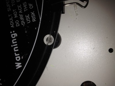

What size screws did you use? I can't tell from the pictures how big the heads on yours are, but the heads of mine (they're #4-40 per the instructions) easily fit in the holes:
#4-40 screw to hold down Onyx heated bed

my screws are the same as yours, they fit below the surface in the countersunk holes. I'm just having uneven prints towards the edge if you look at the other posts in this thread. it seems that im getting minor warping maybe caused by the bed being locked down. some people have this issue and some don't.

Posted: Sat Nov 16, 2013 4:36 am
by bubbasnow
[img]https://lh6.googleusercontent.com/-rRnr ... 021159.jpg[/img]
So, today i took the beast apart and measured everything twice before i put it back together.
I calibrated the end stops and center points.. all is well
I screwed the snowflake down, and tried a floating heatbed by using clamps around the edge. it seems i have having the same issues with .2 layer heights :(
Will the auto level functions fix this issue?
This is kind of aggravating!!
