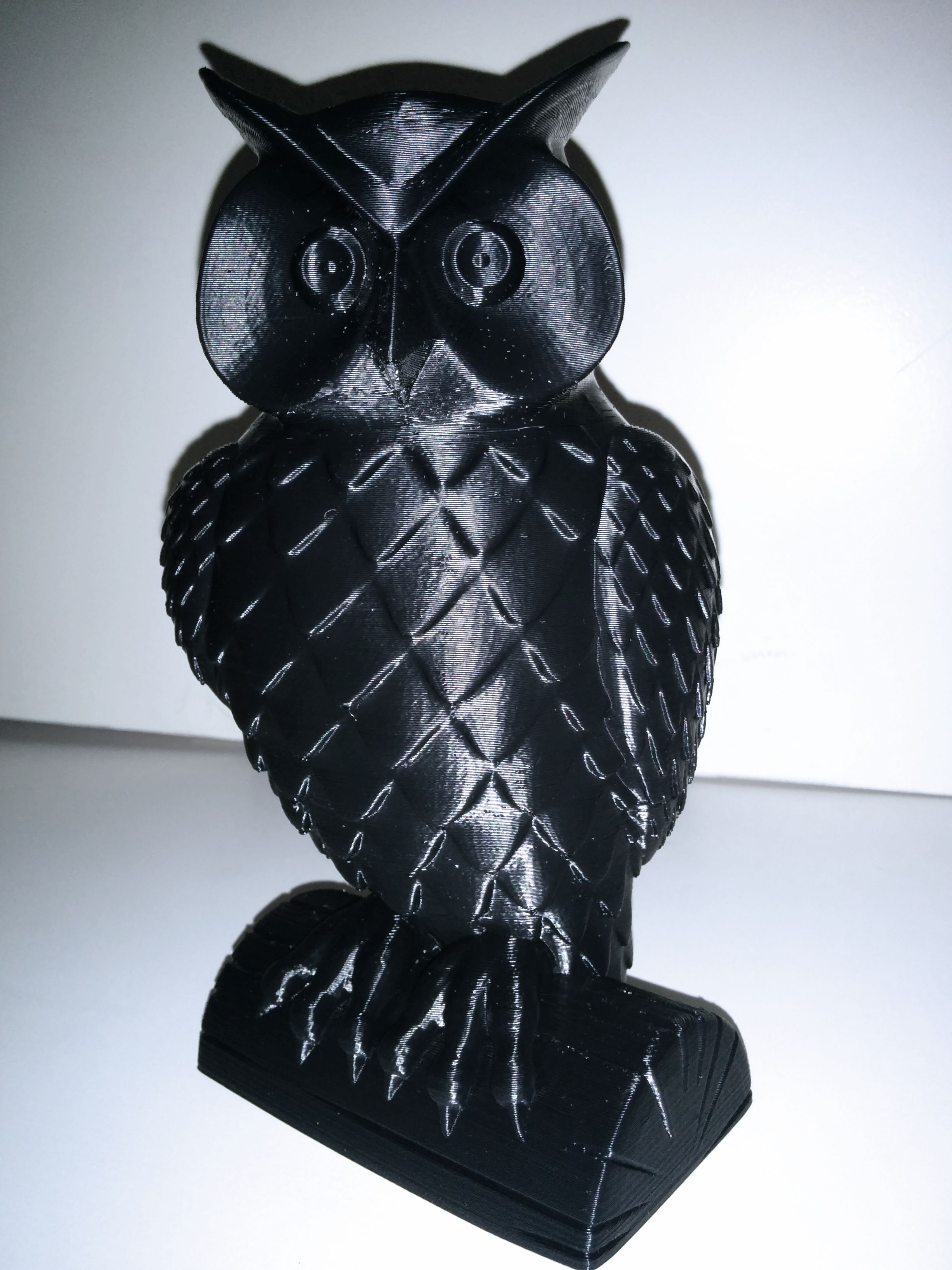

My version of the Owl
- 23cm; about the largest you can print with the ORION
- 0.3333mm layer height; 0.4mm nozzle
- ABS; E3D 235C, bed 100C
- No fan(s) other than E3D fan
- 10 hour total print time
- Bed prep: Elmers glue on glass
8-)

hey Eaglezsoar
yes, I have printed that owl a few times at 9" tall hollow (0 infill) worked great.
I used 3 perimeters and 4 top & bottom layers.
.2 layers
I used ABS, Steve cheated and used PLA and infill (wink, wink)
KISSlicer

That's great to know! And thanks for answering without being condescending like one answer I received.
I just don't see the sense in infill for a statue that just sits there, I'm glad that it can be done hollow.

Great looking owl, good job!
