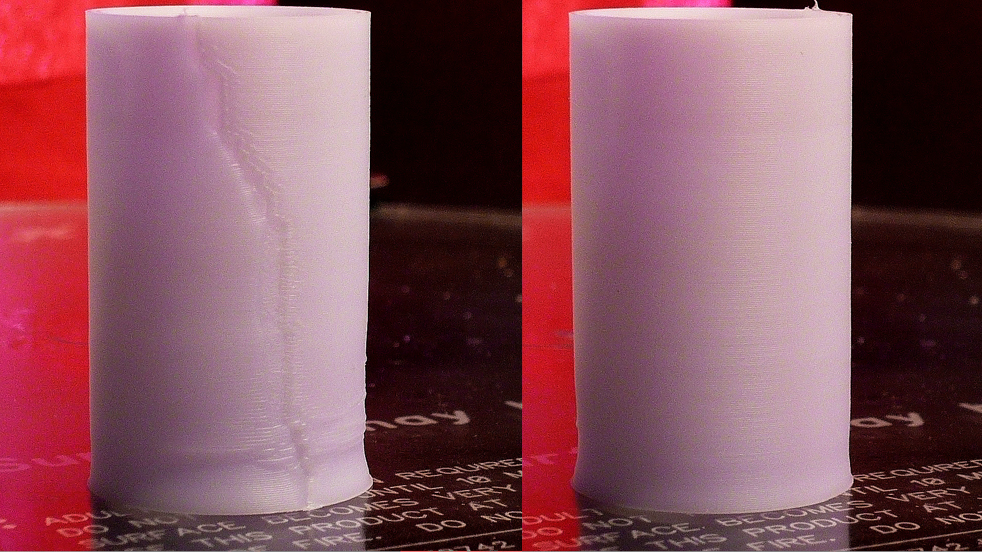

Re: Maybe Belt/Motor Skipping?
Bubbasnow:
The skipping is at 15 seconds on my shorter youtube video: https://www.youtube.com/watch?v=IjgRf8SZw-s
The skipping occurs occasionally - maybe once or twice a day if I am using th eprinter for several hours a day. (Which I usually am)
I plan to check the cheapskate looseness in the next day or so as part of a complete recalibrate / ground up retest.
Flateric: I have solid metal 15 tooth Pulleys - the old versions, so I don't think they will decompose.
Out of curiosity - why were they changed in later machines. What is the problem with the metal gears?
I have been putting in an average 8 hours a day for most of January on this machine.
I think I will give this machine 2 more weeks before I remove what parts are useful and give up.
Here is the list of things I am going to try,If anyone has any other ideas for testing, do let me know:

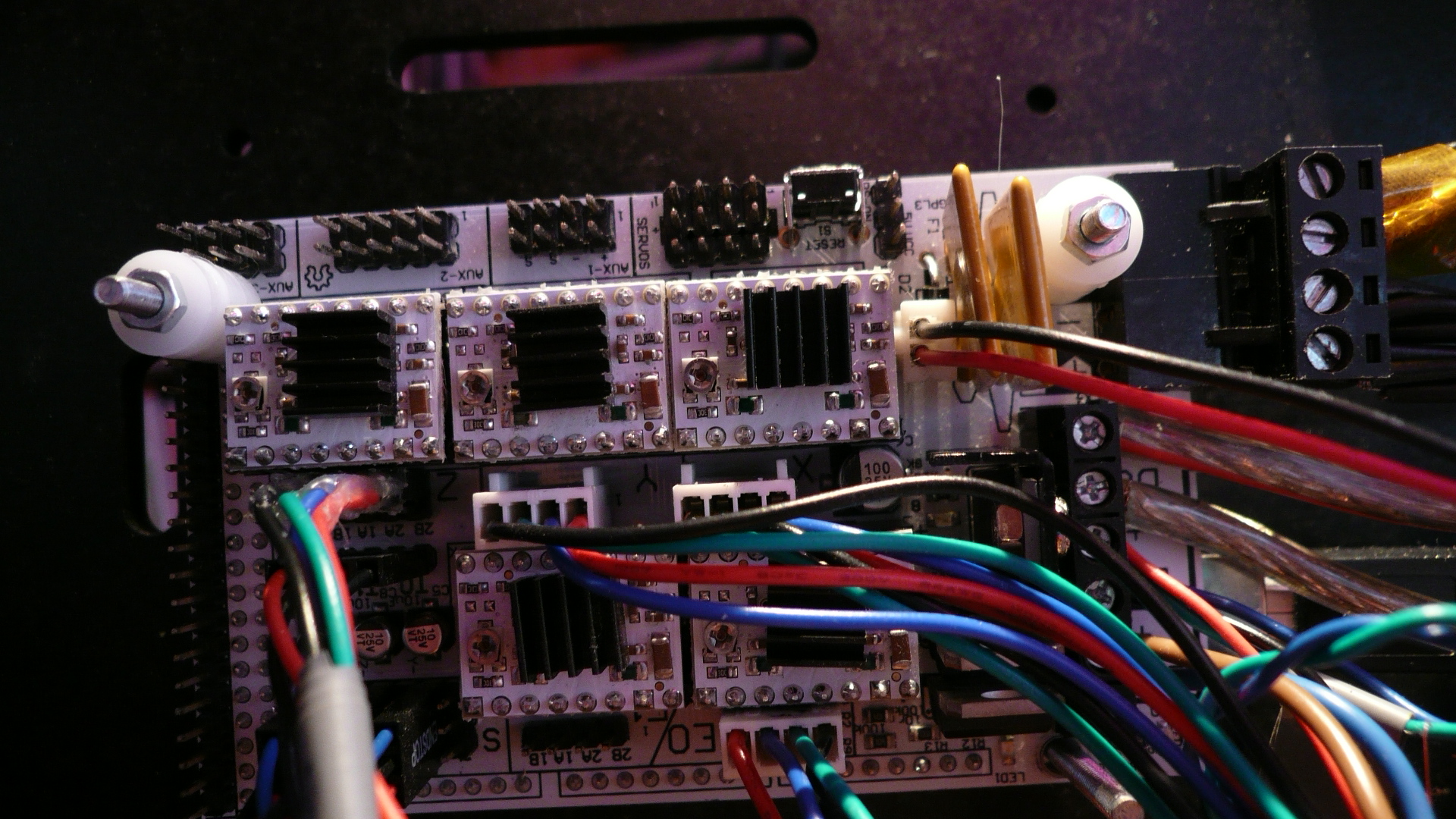

THe only wierd thing is that the extruder motor has to be wired in the reverse to the arm motors to work correctly.
My trimpots are all look the same - I have not touched them.
Generally all looks ok...

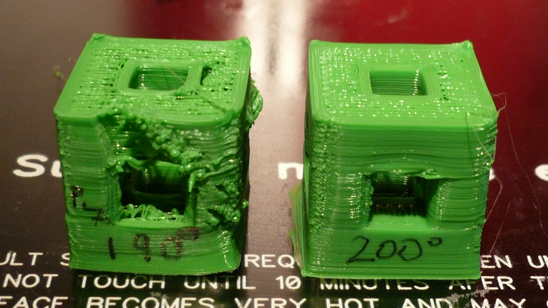

Retesting done so far:
Re-test Hot end / Heated Bed temperature reporting accuracy = Now very accurate
ReTune PID for hotend and bed = Very consistent over multiple tests
Check Cheapskate movement - See video below:
I think they are running ok - no signs of any real wear.
ll bearings rotate when skates are moved.
No play or looseness.
Now I must retension the belts...

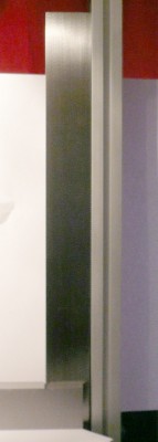

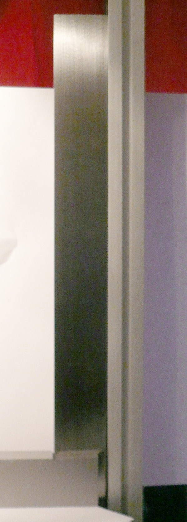

Testing for pillar alignment.
I put a high quality engineer's square onto the glass bed to test squareness.
Each pillar displayed about .5mm to 1mm gap either at the top or bottom of the square.
This could just be the bed being off - which will be compensated for in calibration.
I think this is a tough call to make?
Are the pillars slightly out?
Is the bed slightly angled?
I would have to take the bed off to do more testing.
Maybe I'll save that for another rebuild attempt...

Look at the bottom of this photo for the small gap...

Plus thr addition Of PLA fan, A temporary Switch to PLA (Faberdashery PLA, arguably best quality PLA available)
Temperatures written on cubes.
Settings:
; layer_height = .2
; perimeters = 3
; top_solid_layers = 3
; bottom_solid_layers = 3
; fill_density = .2
; perimeter_speed = 30
; infill_speed = 30
; travel_speed = 130
; nozzle_diameter = 0.5
; filament_diameter = 1.75
; extrusion_multiplier = 1.25
; perimeters extrusion width = 0.50mm
; infill extrusion width = 1.02mm
; solid infill extrusion width = 0.85mm
; top infill extrusion width = 0.85mm
M190 S55 ; wait for bed temperature to be reached
M104 S200 ; set temperature
It looks like maybe I have Fliament starving, as I had to up the extrusion_multiplier to 1.25 and the top is still looking a bit sparse.
The main BIG issue is the squishy, blobby expanding corners.
I made a movie to to show the effect : 0:55 in movie is a good example:
The head pushes the corners all out of whack as they rise up and get squished.
My goals are to:
learn more about measuring extrusion length and width at the hotend.
Figure out this squishiness issue.
[youtube]http://www.youtube.com/watch?v=72UtRMj_UAE[/youtube]

Pretty much lost my temper there.
A long dark teatime of the soul led me to thoughts of stripping the reusable iron form the machine,
taking the mdf components out to the garden and lighting a big bonfire.
Anyway....
Looks like the ramps overheated by being shut inside the body of the rostock max.
Yes it has the approved fan running on it costantly.
Looks like it needs more airflow than the Rostock max casing allows.
All working again now I have the door with the electronics open.

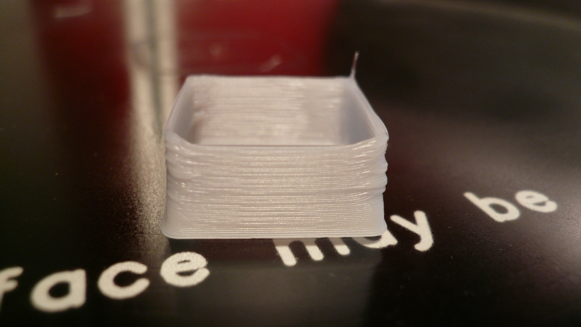

Printed the Mhackney single wall cube with these settings:
layer_height = .2
; perimeters = 1
; top_solid_layers = 0
; bottom_solid_layers = 2
; fill_density = .2
; infill_speed = 30
; filament_diameter = 1.68
; extrusion_multiplier = 1.0
; perimeters extrusion width = 0.60mm
; infill extrusion width = 0.60mm
; solid infill extrusion width = 0.60mm
; top infill extrusion width = 0.60mm
; first layer extrusion width = 0.60mm
M190 S80 ; wait for bed temperature to be reached
M104 S245 ; set temperature
Maybe my bed temp could be higher.. to which I say, bite my shiny metal ass,
I have bed adhesion, and 100 degrees plus takes forever to wait for..
So here it is:
Walls averaging .25mm!! way to thin??
So - underfeeding filament I guess...
I'm gonna give the Pololu thing some thought.
Maybe hang out on the reprap boards as well to get some info..

All things being equal, there's got to be a solution to your problems. Printing a cylinder is an excellent suggestion - it should remove the jerk settings from the motion equation. We WILL get this figured out.
- analog_banana
- Posts: 167
- Joined: Mon Apr 08, 2013 7:53 am
- Location: London, England
Thanks for the support!
Here's a cylinder test.
I don't think it's a too low temp issue - maybe It was too high, based on the experiments here:
http://forum.seemecnc.com/viewtopic.php?f=37&t=4192
This cylinder seems to be fairly straight - a liitle bit of warping just near the base due to ambient temperature / bed temperature maybe?
You can see some artefacts where the head moves from the outer wall to the inner wall of the two shells.
