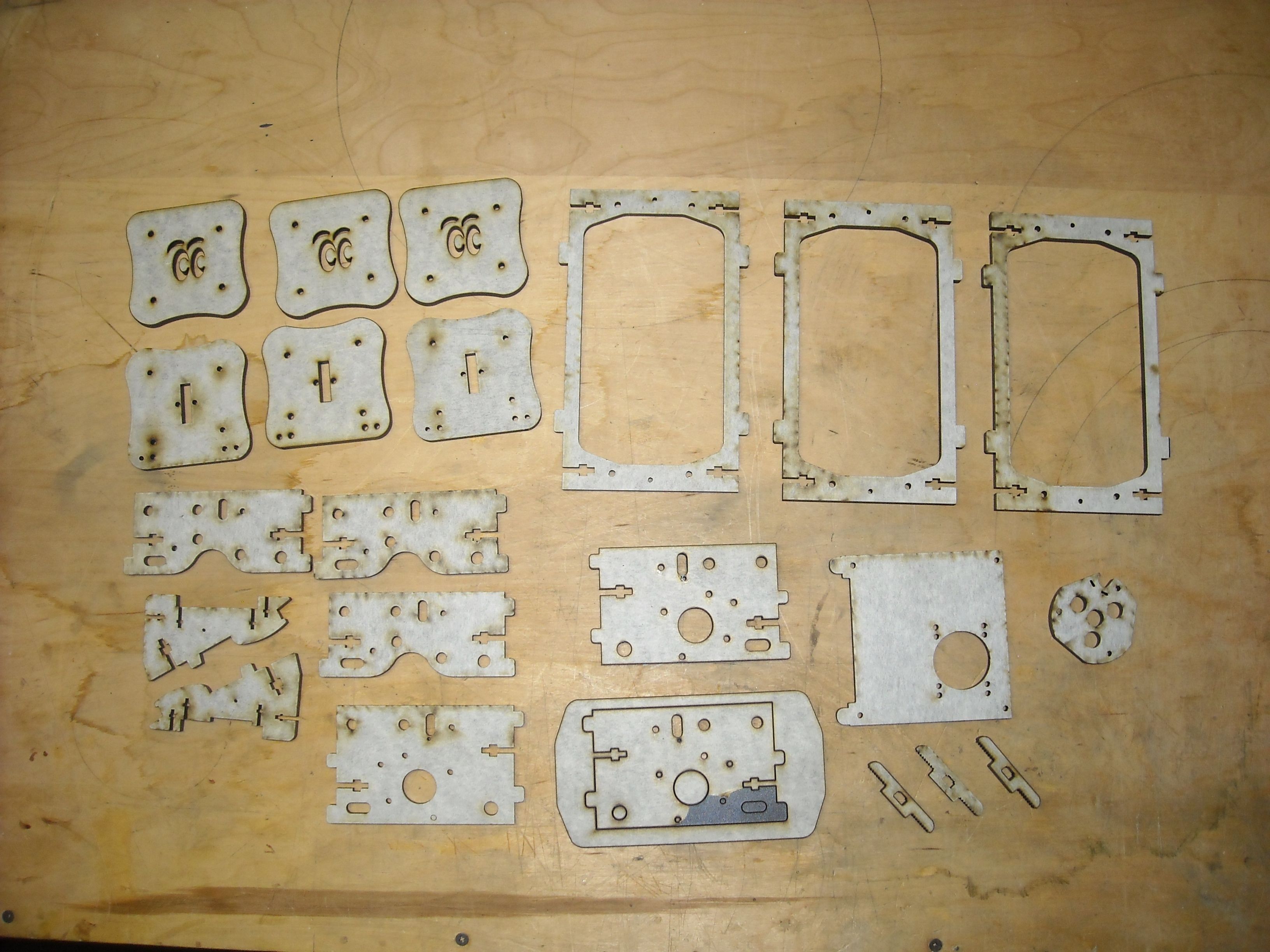

Well, I've started opening up the various bags and wrapped packages, and SeeMeCNC has rearranged the parts on the melamine sheets since sending you your kit. I'll take and post pictures of mine.

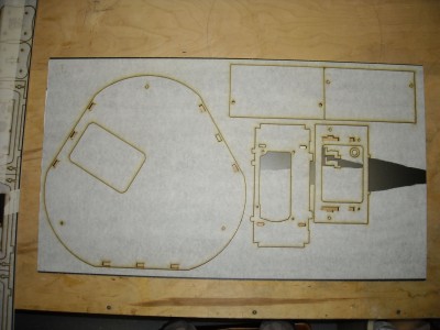

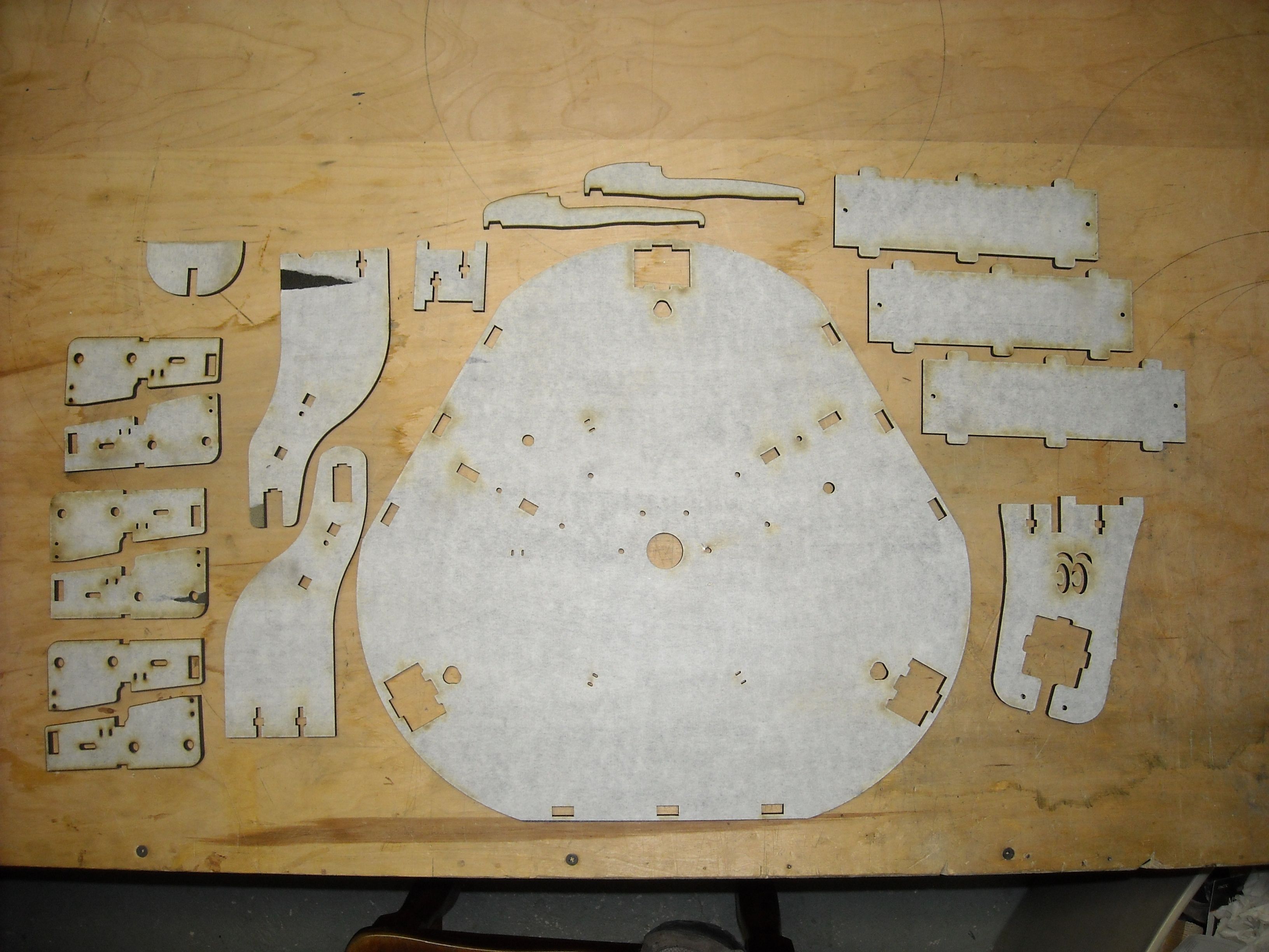

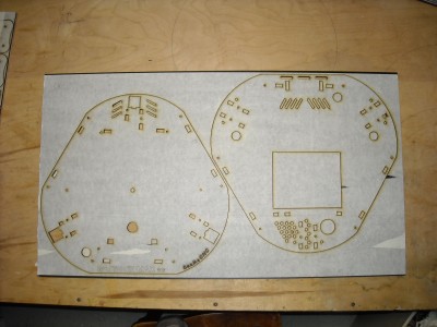

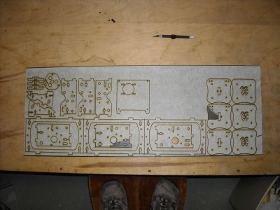

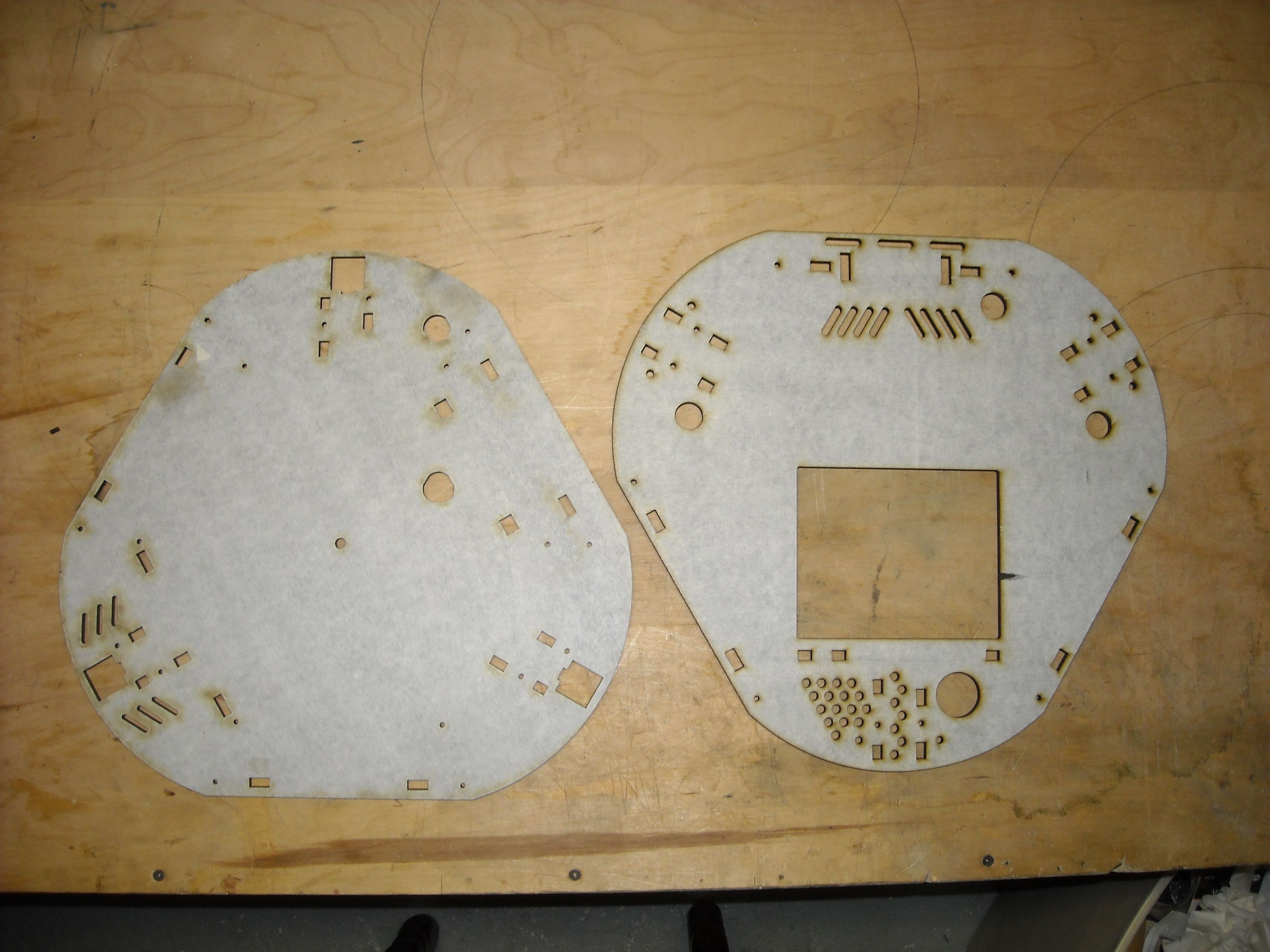

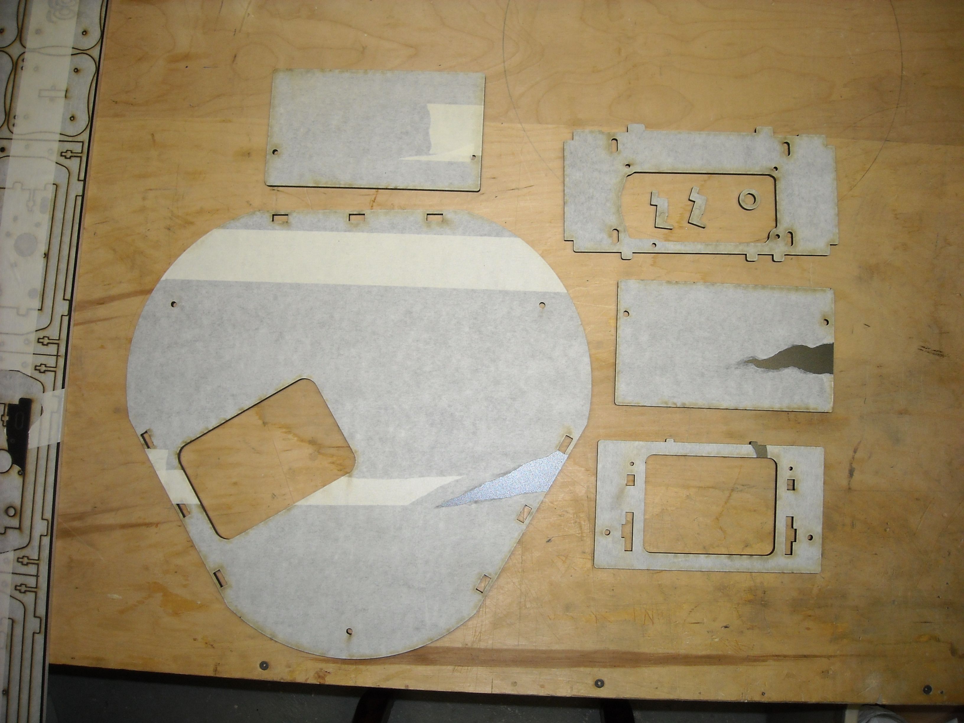

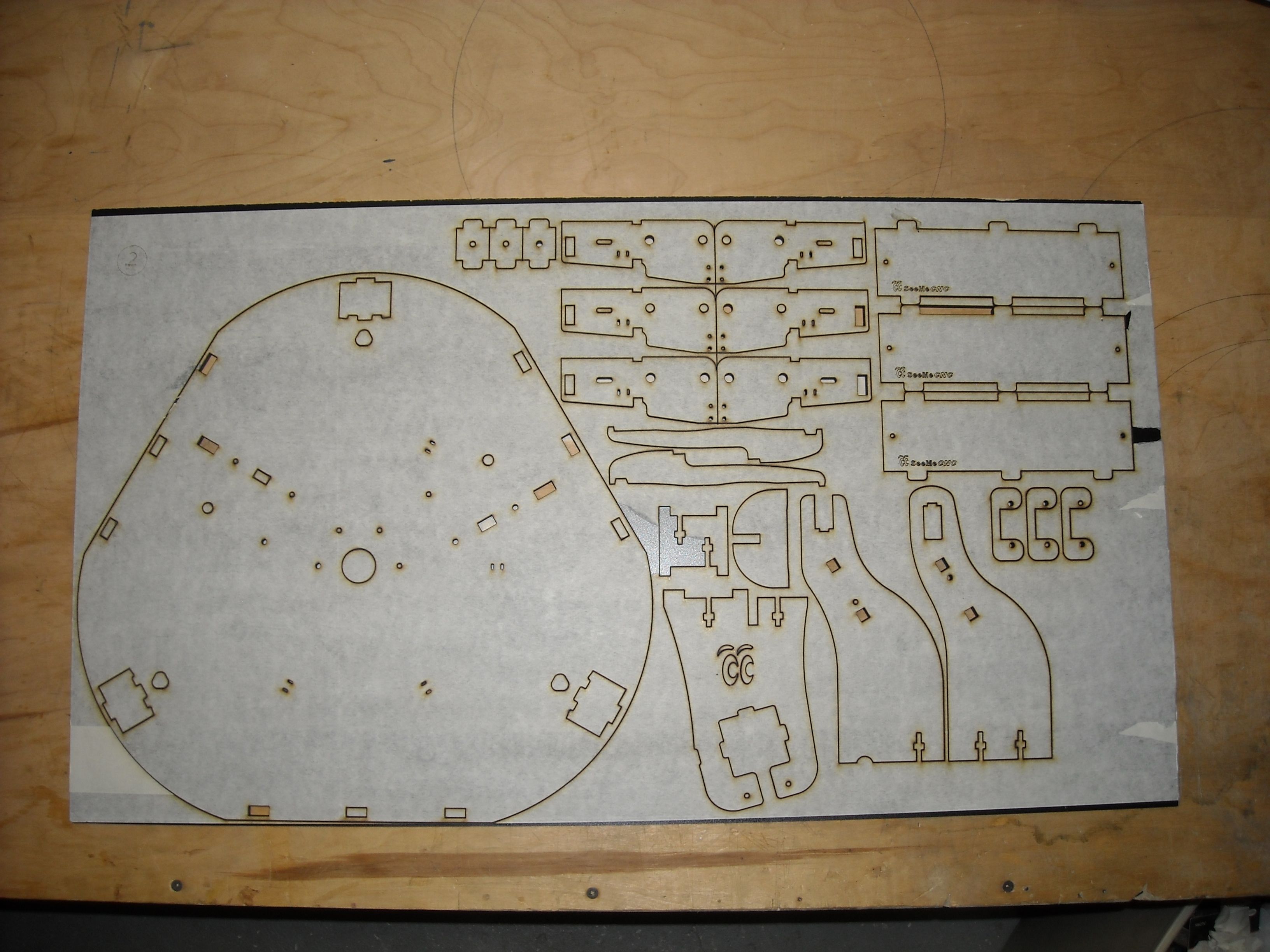

Here are photos of my kit's melamine sheets. It looks like SMC rearranged and spread things out a bit, which makes sense since the cost of the material is pretty minimal.
On the fourth sheet, I wasn't able to separate one piece, as the laser hadn't even penetrated the bottom laminate sheet. The laser kerf is too narrow for my #11 blade to get through from the top, and I'd be completely winging it if I tried to cut from the bottom. I'll be asking SMC for a replacement.
Gene, feel free to use the photos in your manual if you find them useful.

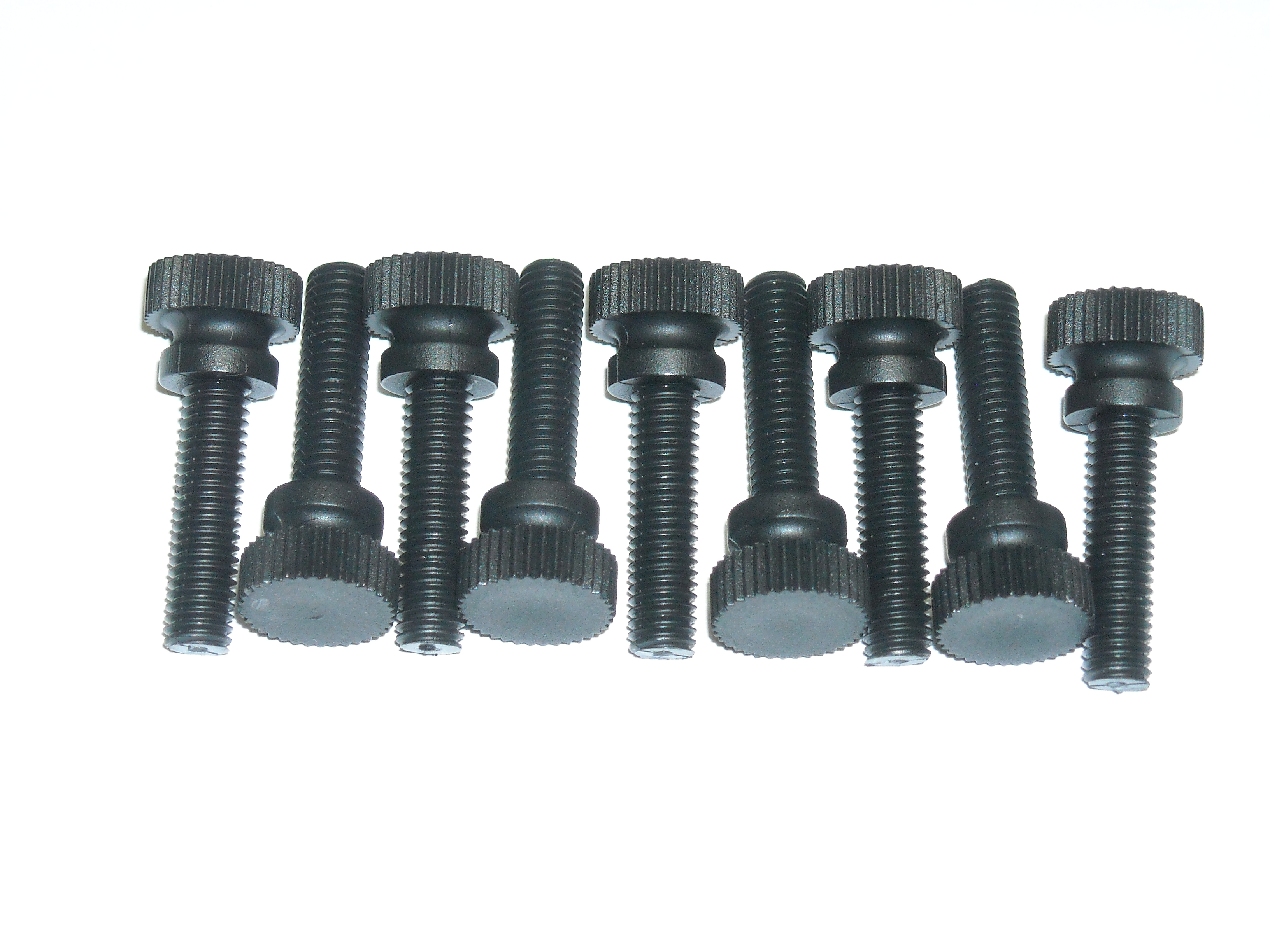

I'm going through the inventory, comparing everything to SMC's packing lists and the Visual Bill of Materials. The Visual BOM starts with Hardware Pack 1's contents, and I have a few corrections:
1) It appears that the first X items all are in Hardware Pack 1, which makes it easier to find everything. You might want to make it explicit that those will be in HP1 (unless SMC tells you that they're liable to reorganize the packs).
2) The image for the "(9) 10-32 x 3/4" Knurled Nylon Thumb Screws" is wrong. Here's one I took:

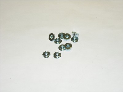

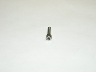

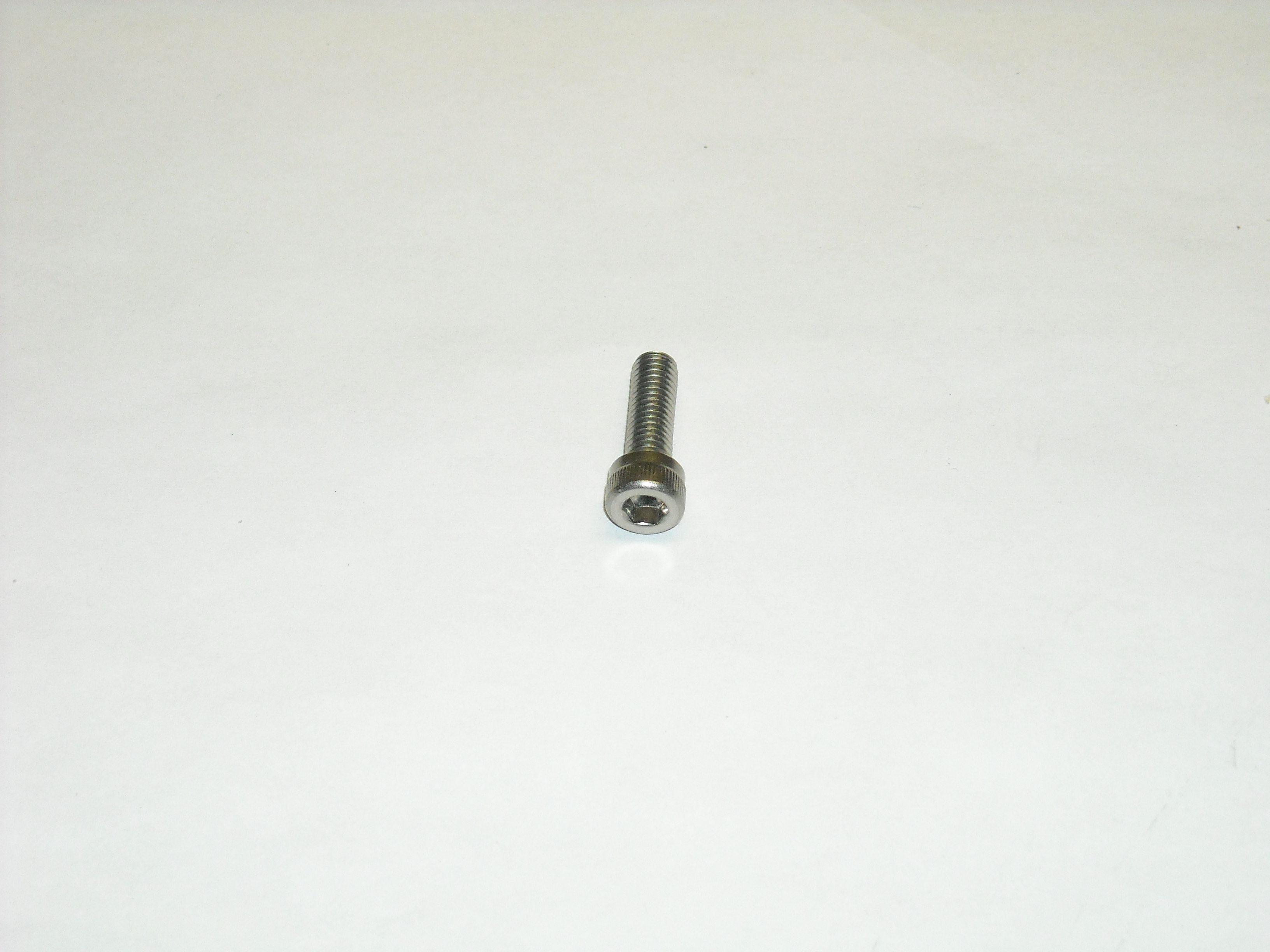

4) There are two items in HP1 that aren't in the Visual BOM at all:
a) (10) 4-40 Blind T-nut (zinc plate); for belt clamping and RAMBo mounting
b) (1) 10-32 x 5/8" stainless steel socket head screw, to tap holes for 10-32 nylon thumb screws
