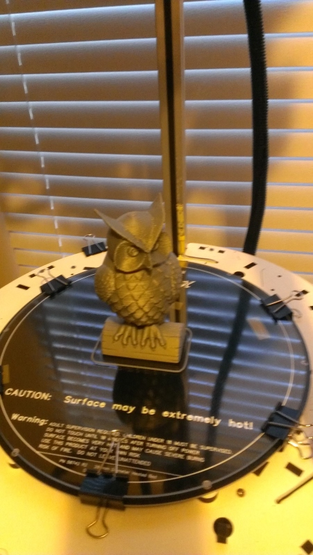

				Re: Joe's Rostock Max
				Posted: Wed Apr 02, 2014 8:48 am
				by joecnc2006
				Eaglezsoar wrote:joecnc2006 wrote:First Print in PLA, I think I like it better than ABS plastic.
Note to self don't use as much hairspray next time (I had to tap it off with a hammer)
That looks really nice for your first PLA.  I don't see all the hairs and strings normally associated with PLA.
Yea I was pleasantly surprised also, I used the stock settings in repetier-Host from the Orionpla config file.
My latest print last night I just shot a quick spay of hairspray on the glass, the PLA stuck nice and when the bed cooled down the part practically popped of by itself, the bottom of the part was as smooth as a baby's bottom. not like when using the glue.
