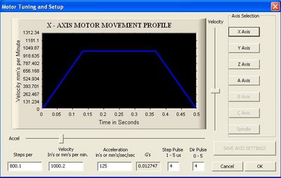

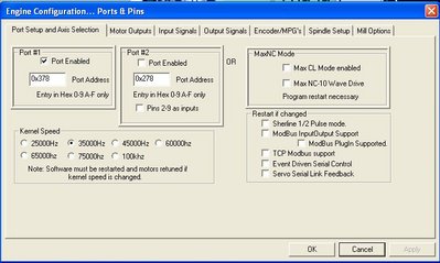

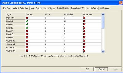

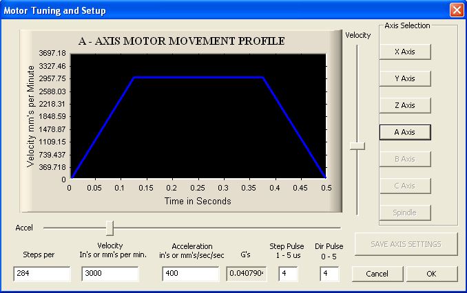

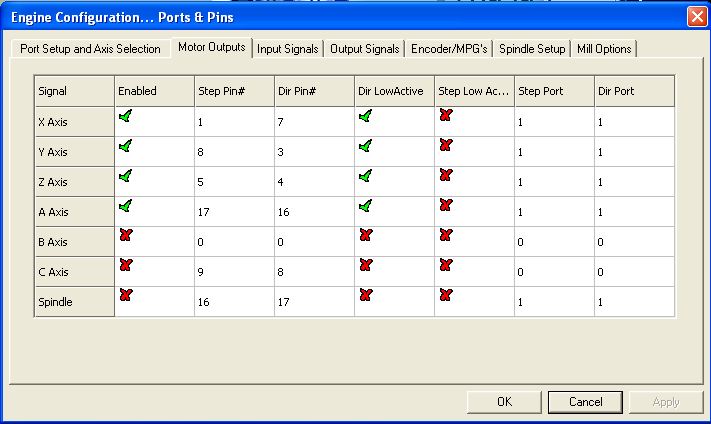

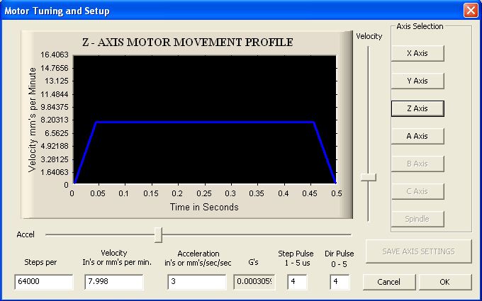

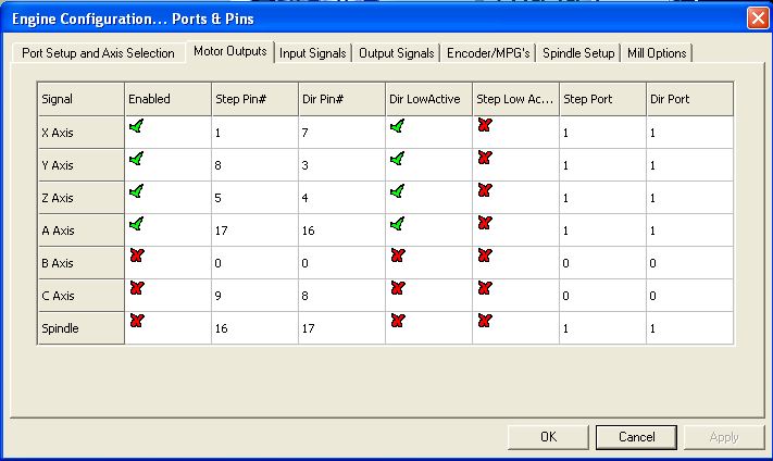

Maybe these pictures will get you in the right direction. Keep in mind that my EasyDriver board I have wired backwards on accident so pins 16 and 17 in Mach are reversed.
Z axis motor movement profile
X and Y motor movement profile
Port setup and axis selection
Output Signals
Output Signals
Motor Outputs
Motor Outputs
A axis motor movement profile
