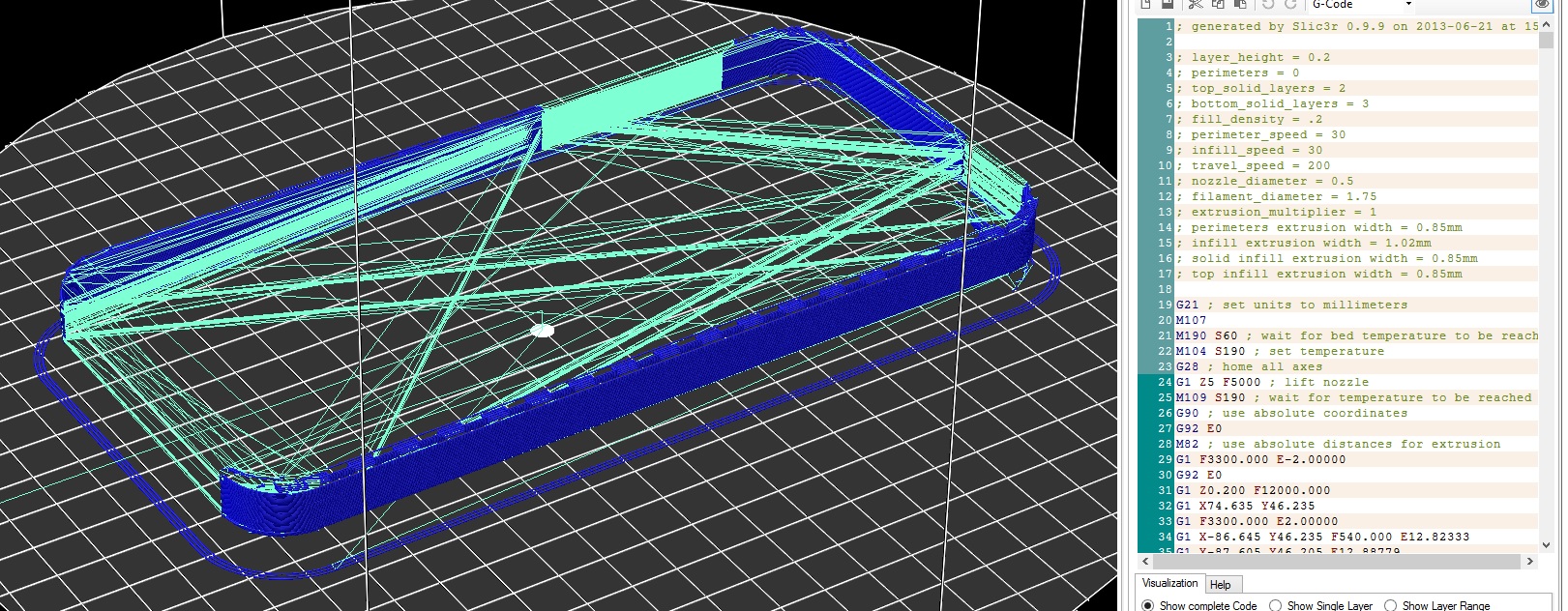

Im running slic3r, trying to print a case for my friends phone however, it does not generate code for the bottom layer any suggestions on how i might have set it up wrong.
what Im trying to print: http://www.thingiverse.com/t[attachment ... hing:40479
