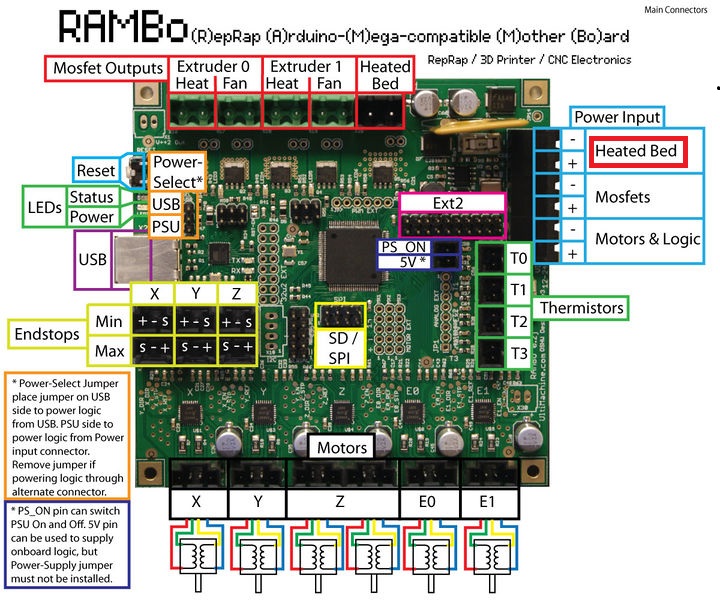

I Have just printed my first peek fan parts. I had the same problem. After waiting for more than an hour I covered the glass with tea towels, turned off the hot end heater and set the bed temp target to 115 c. I got it up to 87 degrees C max, so I just configured the slic3r to print with a bed temp of 85. This did the trick, but the one corner of the part lifted a bit ( probably due to glue contamination or less than ideal bed temp). I guess that its either a power supply problem, or maybe a PID issue, since the printer does not seem to have any trouble keeping the bed at 85 while printing, but if you leave it off for more than a few seconds, it drops right back down to 73 and refuses to budge without the above remedial actions.
I have a spare 300 w power supply, is there any easy way I can wire it into the printer and dedicate it to the heated bed ?
This issue is such a pity and i hope there is a solution because I am very impressed by the print quality, even without the fans or correct temps.
Re: Heated bed cannot reach temp
Greg von Plettenberg wrote:I Have just printed my first peek fan parts. I had the same problem. After waiting for more than an hour I covered the glass with tea towels, turned off the hot end heater and set the bed temp target to 115 c. I got it up to 87 degrees C max, so I just configured the slic3r to print with a bed temp of 85. This did the trick, but the one corner of the part lifted a bit ( probably due to glue contamination or less than ideal bed temp). I guess that its either a power supply problem, or maybe a PID issue, since the printer does not seem to have any trouble keeping the bed at 85 while printing, but if you leave it off for more than a few seconds, it drops right back down to 73 and refuses to budge without the above remedial actions.
The first two pins of your power input area are for the heated bed (outlined in red) you can connect the other power supply's 12V (yellow) where it says + and black where it says -

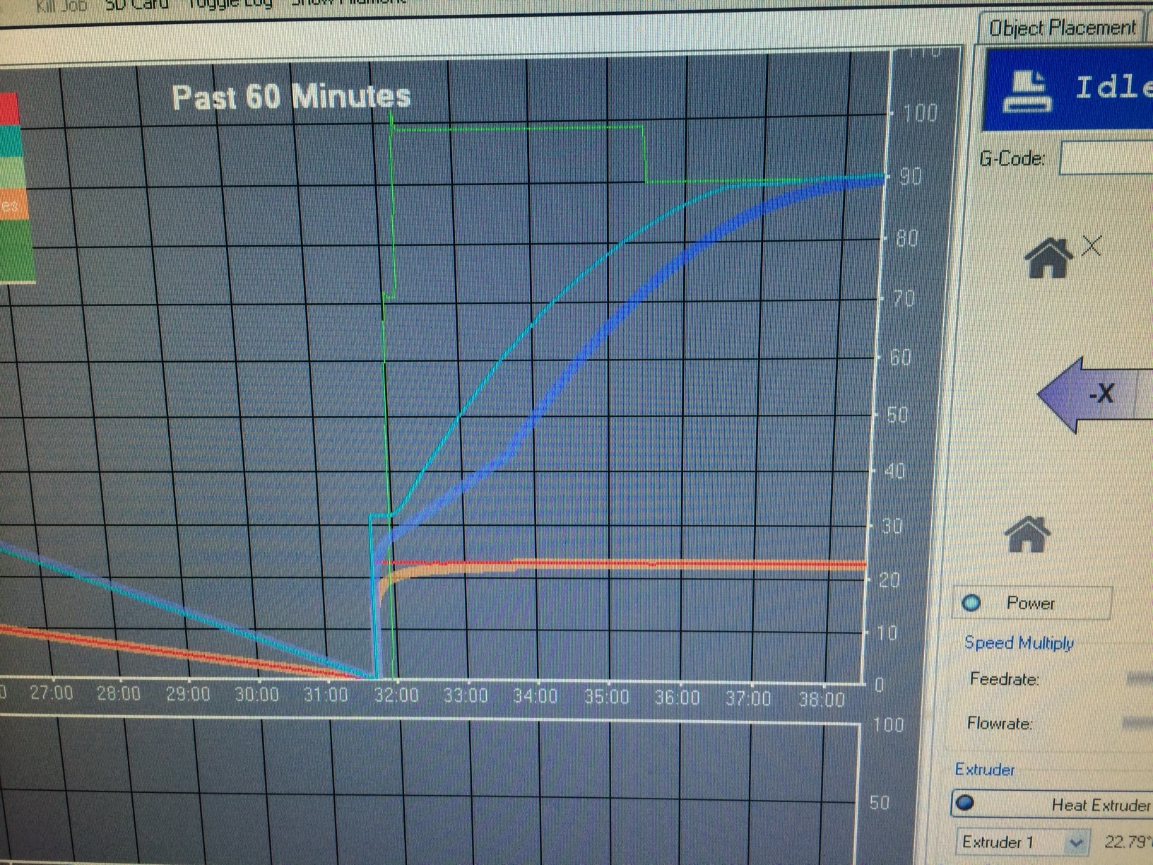

I ended up buying a new 750W PSU yesterday because I am impatient, and if it's not necessary I suppose eventually I can use it for an acetone vapor booth to finish my ABS prints. Anyway, I wired up the 750W PSU and it did not solve the problem. It does seem that I got a bum heated bed. Later, I installed the Rev 2 Onyx (with only one + and one - wire) and it heated up super fast and got right up to 90 degrees in a jiffy! Instead of 72 degrees in 30 minutes it got right to 90 degrees in 4.5 minutes! I am so excited to make bigger ABS prints!
Fastest Heating Yet, Now functioning perfectly!
