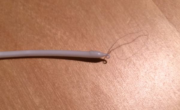

Anyone have tips for printing PLA on the v6?
I'm getting jamming/clogging issues at 200c and fan at 100%.
A little plug forms after a little while. It doesn't drip/leak like the stock hot end, but I'd rather have that instead of jamming.

jesse wrote:Anyone have tips for printing PLA on the v6?
What are your retraction settings?
Is the PTFE tube seated allllllll the way down, as far as it will go?
Have you done the "ideal heat test?" Set the temp to 180, wait for it to stabilize, then set the temp to 240 and feed the PLA through as the temperature climbs. Resistance should drop, and then begin to increase. The point where the resistance is lowest is the ideal heat. Keep in mind that E3Ds usually run hotter than other hot ends (due to the lower thermal mass) so it's common for PLA that prints at 180 on other hot ends to require anywhere from 210-250 on an E3D.
[img]http://i.imgur.com/CKxg81u.jpg[/img]
Last night, I was about to post something in this regard. It seems that you are having the same trouble I got.
Quick answer that worked for me: lowering retraction to 4mm (6mm should work as well). I am printing at 185C (verified by a thermocouple) with no problem.
Long answer: wait for my post :-)
Something before the Long answer, it seems to me that the "interface" Bowden, metal, creates this bulge when the filament is removed fast from the nozzle.
The second problem I was having with this, is when changing the filament. It is almost impossible (at least for me) to take the filament out through the ez-extruder bore with this bulge.
I had to modify the EZ extruder to allow the Bowden tube to go all the way to the hobbed drive roller. I will try to post it tonight, if have time to put the pictures together :-)
But, try reducing the retraction to 4mm and report back.

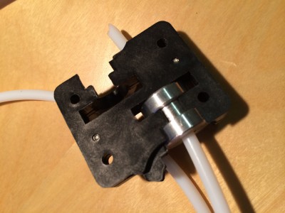

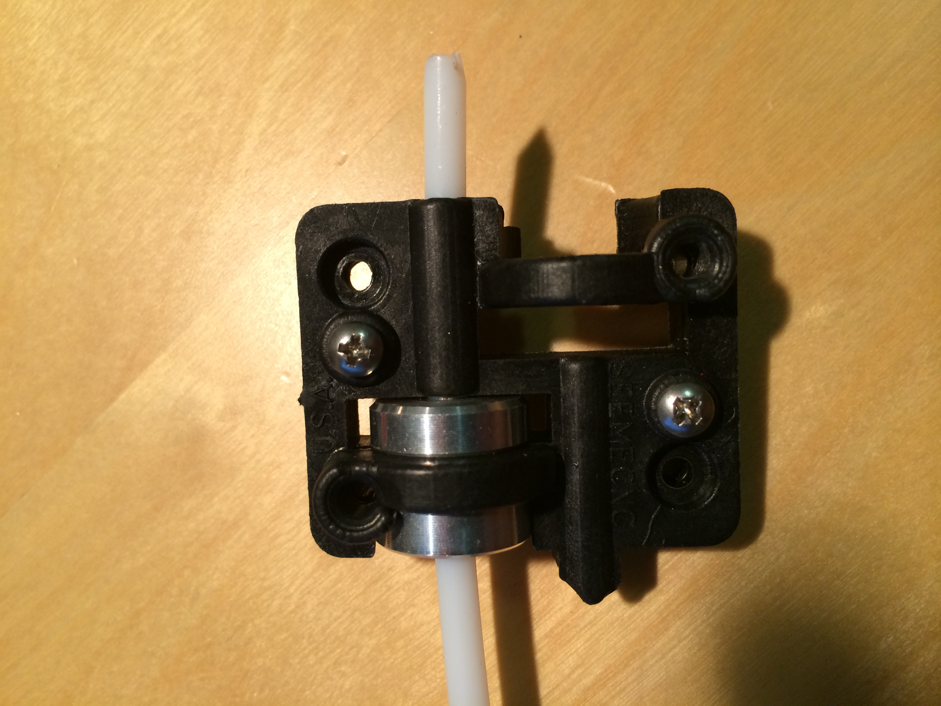

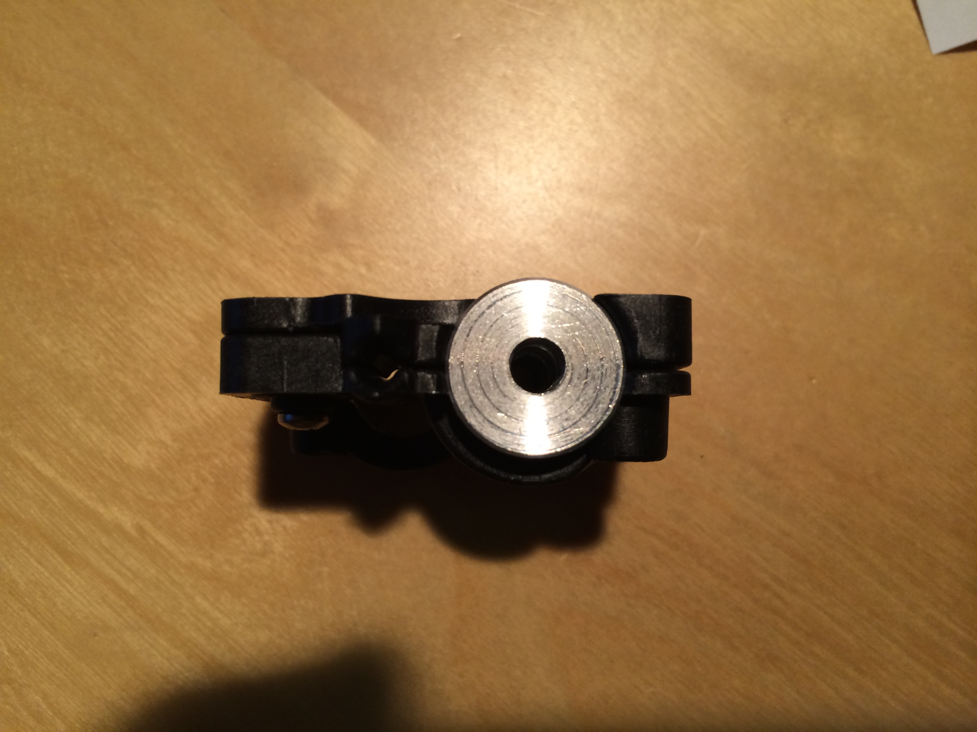

Well, as I mentioned in a previous post, I had being troubled switching filaments using E3D V6, as, for some reason, the filament bulges more than with V5. Then it is very difficult (if not impossible) to make it goes trough the little hole in the EZ-Extruder.
You can see that I got something similar to what Jesse got.
This is not good! :-)
So, I decided to bore the EZ-Extruder (I remember mhackney mentioned this in other post) to make allow the bowden tube go through all the way up to the hobbed drive roller. See the pics
Bore increased to ~ 4.3mm diameter
Bowden tube goes through (using the 3mm "channel")
Tip shaped accordingly
So far, it is working great :-)
Cheers.
